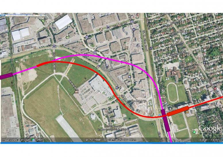

I tried sketching out an option, where the Westbound Sheppard would connect to Northbound Spadina north of the existing Downsview Station, while the Eastbound Sheppard would leave the Southbound Spadina line east of the new Downsview Station and connect up with Sheppard. I was hoping that it could go above the Spadina line at Allen Road, but I do not think it can be done - it had to go under. This option had the added problem of having no Sheppard line station at the existing Downsview Station. Turned out to be a bad option.
Next I figured if Sheppard had to go under the Spadina line anyways, then it both directions should stay together. Here the Sheppard line would go roughly parallel to Sheppard (on the South side). The Eastbound Sheppard would break away from the Southbound Spadina line east of the new Downsview Station, while the Westbound Sheppard would climb after passing under Allen Road so that it could go above the Spadina line (top of tunnel is about 10m underground here) and join the Northbound Spadina line from the north side, to the east of the new Downsview Station. This option would allow a Sheppard line station to be located at (near) the existing Downsview Station.
I used this EA to help determine elevations and alignments (http://www.ttc.ca/pdf/about_the_ttc...hange_in_subway_tunnel_ea_addendum_2_revi.pdf)
Good analysis. Crazy idea for you: what is the Sheppard line doesn't need a station at Sheppard West (Downsview)? Having the "merging station" be Downsview Park may make more sense, especially considering the intermodal nature of that station. Put a Sheppard line station between Wilson Heights Blvd and Faywood Blvd instead. If a connection is really needed, build a Spadina-like walkway between them.
That way, the interchange isn't so conflicted with Downsview station. Coming southbound on Spadina, trains can either turn right to go to Downsview, or continue straight to head onto Sheppard.
Realistically, if it weren't a terminus station, Downsview would be pretty lightly used. Downsview Park station makes much more sense from an intermodal facility perspective.
Not that crazy of an idea. Downsview Park can also be expanded into 2-island-platforms with 3 tracks. Sheppard only needs one track with its 5~6min headways.
And I agree with skipping Sheppard West, using Downsview Park as the cross-platform interchange station, and leaving the option open for a station between Wilson Heights and Faywood (preferably closer to Faywood).
