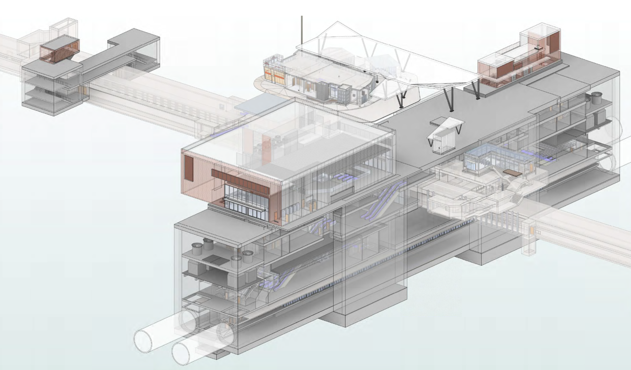

It turns out that Pape station is going to get further renovations, as part of an early works contract for the future Ontario line extension. The details are up on the city's planning application website.
Other than typical utility relocations, the bigger issues are moving the tunnel vent shaft and altering the bus loop.
Almost all of the documents pertain to the early works, though there are some little tidbits. And a 3-D view of the final station. If I'm counting right, that's 3 escalators to the Ontario Line from ground surface. The design is far from final though.

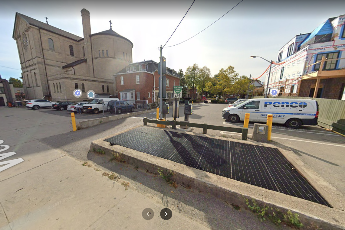

Hang on ... what's that new structure to the left (west), on Line 2, between Pape and Chester?. At first glance, I took that to be the newish Second Exit/Entrance they'd added. But it isn't, of course - it's the wrong direction and not connected to the platform.
It looks like an emergency exit. But why would that be part of Metrolinx's plans? And why would you need one in the short distance to Chester station? And why would you need stairs on both sides of the tracks for an emergency exit?
It's too far west of the platform to be another exit from the station. (it looks to be about where the laneway is, halfway between Pape and Gough, just east of that vent at the northeast corner of that magnificent Catholic church.
That is a second/third exit and it is attached to the Line 2 Platform.
This vent:
Is immediately west of of the western extent of the Line 2 Platforms.
I think its a requirement because the current second exit path (fire code requirement) will be subsumed into the concourse area of the new Ontario Line; so a replacement exit is required (the second exit path must be completely independent of the other, not sharing a concourse. )
