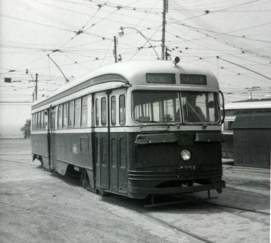

Which is why the TTC switched to all-electric for new PCC streetcars (4300-...) after 1946. See link.
I was waiting for someone to point that out ;-) Why TTC went back to air for the CLRV's after the success of the all-electric PCC's baffles me.
Of course, the air PCC's were retired within about 30 years of their birth. The CLRV's have lasted 40 years. I guess they win the prize overall, but they sure suck in the cold.
There is likely a series of reasons for it. Here are my educated guesses:
1. Electrical capacity. Compression requires a small amount of energy over a long period of time to build up the pressure. While electric motors require a large amount of energy all at once
2. Cost. You will need separate electric motors for each function while you only need one motor for the compressor (I don't know back then if copper tubing/rubber hoses for compression were more or less expensive than electrical wiring)
3. Runaway Train. In case of a power failure I would rather have a reservoir of compressed air vs relying on overhead wires. Especially down Bathurst St
(noooo...the Soul Asylum song is in my head)
That was the design and engineering trend of the 1970s. Compressed-air everything. Backlit signs and indirect lighting. Big, sealed windows. Quasi-air-conditioning. Mono-motors. All sorts of design ideas that seemed to have logic behind them but when looking back on those decisions decades later, didn't really do as well as everyone had hoped.
