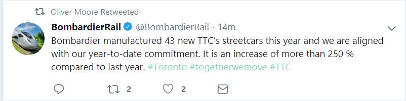

I think the folks at BBD are getting their confidence back ;)
