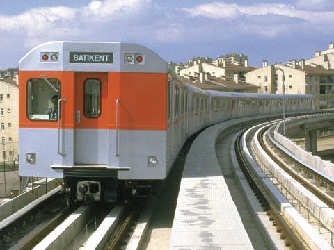

Sorry if this is a silly question, but with the deferral of the new train purchase… Would it make sense to purchase the Ankara, Turkey H5/H6/T1 ”Frankensteins”, to supplement the T1 fleet? If we could get a good price on them.

I’m unaware of their current condition, or the amount of work required to adapt them for the TTC’s use, if possible.

We don't really have a shortage of trains though, I would imagine that they are quite old and would require a lot of adaptation. Are you suggesting using them instead of the T1s?

In a word 'No'.
As @adys123 notes above, we don't need replacement trains today. We need trains w/ATC and possibly some net new ones by the time the SSE opens in 2031 (ish). The above will be pushing 50 years old by then and not be equipped for ATC either.
Not at all, but to supplement the T1s to be able to provide full service on the SSE, instead of every other train turning back at Kennedy.
Edit: They could even ”sandwich” an Ankara married-pair in between two T1 pairs, to create more six-car consists.
So, funny thing here.....Ankara's system uses an ATC/ATO system.
It's not the same as Toronto's, but they are already automated. Not that it really changes the rest of the issues with using 50-ish year old cars that are designed with a 25 or 30 year lifespan.
Dan
Good info, I certainly would not have guessed at that based on the age of the rolling stock!
