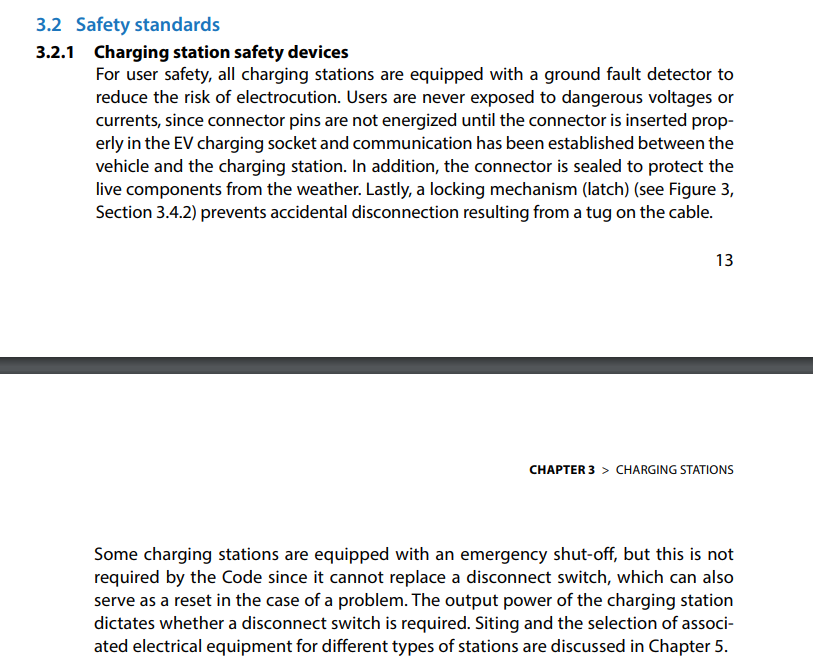

And technically, here's my concern a la safety although I've yet to find the technical specs and diagrams:
You can plug your car into a regular household outlet by upgrading to a Level 2 (220V, 30amps) station, connected to the same type of plug you need for a dryer or stove, will let you charge your car faster.
Yikes! For a technician or a trained worker schooled on safety, this could work. But not for Metrosexuals and their more masculine female partners with their 'oh so green' Pious.
What could possibly go wrong? Welding anyone? (With a gasoline power hybrid directly adjacent)
And btw Ministry of Technical Hypocrisy; It *isn't* "110 V, and 220 V". It's 120 and 240, and typically even higher than that with modern supply lines and an average load, but I digress...
Post Script: Found an excellent Hydro Quebec technical sheet on charge stations that will answer many of the questions other posters have had. As to my concerns of safety (and there are extensive concerns and discussions online specific to that) at least the ground fault one is discussed here (and I still have concerns!)
http://www.hydroquebec.com/data/electrification-transport/pdf/technical-guide.pdf
