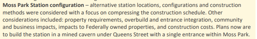

I noticed that Moss Park station on the Ontario Line will only have one entrance according to the document. Is this a violation of some TTC or AODA ruling? The standard is that there is always at least two entrances for every station. Also can this mean two doors but one big building, like with York University.
Sorry, I forgot the name at the time. It's the preliminary design business case for the Ontario Line. link
It suspect it's that "two exits are required" for fire safety reasons, but the relevant regulations don't mind if one is an emergency exit. For upgrades of existing stations, the TTC probably wants the most bang for it's buck. The minor increase in costs for a full purpose entrance/exit is probably deemed worth it.
That is correct; the 2-exit requirement; specifically 2 paths of egress from the platform in the event that a fire obstructs one path of egress.
There is no requirement the second exit be full-service.
But the accretive cost of making the 2nd exit full-service is generally quite modest relative to having to build a set of stairs anyway.
Making the 2nd exit full-accessible (escalators and/or elevators) is another story.

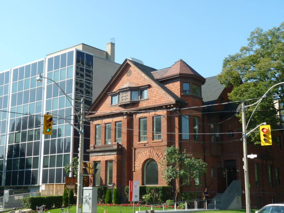

At the intersection of spadina and lowther there is a French school (Alliance Francaise) and I think the main building there may be considered “heritage” by the city of Toronto. I‘m wondering if the TTC had extensive consultations with the property owners (alliance francaise) and possibly the city since the buliding there might be considered “heritage” before excavating a shaft for the elevator for the line 1 part of Spadina Station?
I’m just giving my opinion on this issue because I’ve been to this location Alliance Francaise for French class for a few years.
