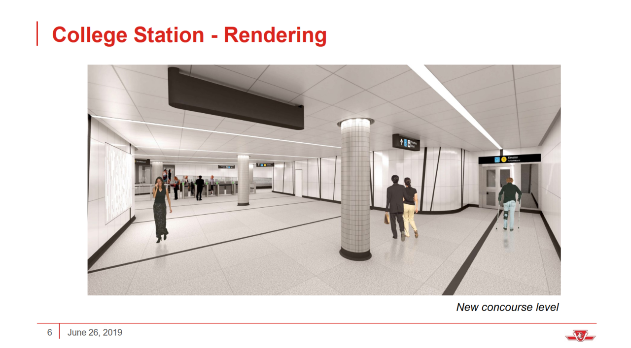

From the above:
192174

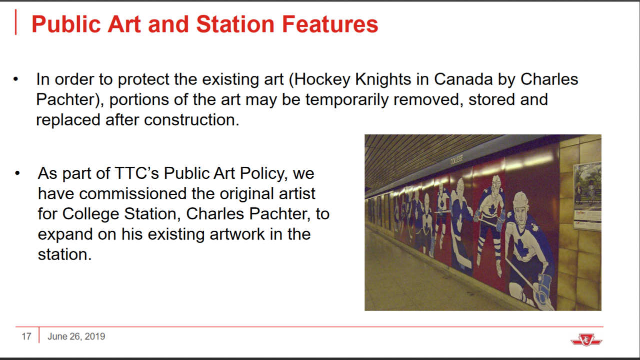

May I ask where this work is being expanded to? Apparently not here:
192175
You know, its not that this render is terrible or anything. If they executed as suggested I could live with it.
BUT
Its completely non-descript.
Pedestrian, ordinary, undistinctive.
It neither relates to the station as is (which I could accept as somewhat dated)..............
Nor does it relate to the art that's there now..........
Nor does it relate to what College Park is.............
Nor does it make its own profound statement.
I'm not asking for particularly expensive material.
Could we just show either a modicum of respect for context, or absent that, some flare of originality?
Just asking.

Continuing the Deco theme down to the station with Tyndall stone would have been nice. I find it slightly odd that this is a completely separate concourse from the current one - without any attempt to link the two even though it is pretty much right next to each other.

Among other reasons, the City may not even own that asset soon. I would rather them focus on actually getting the work done by 2025 (LOL 2023 as if)

It is slightly insane that we are doing this for fire code reasons - and not use it maximize the real benefit of this redo - expanded crush area for the concourse.
I agree. Wish there was a way to do both. Maybe fire doors that stay open (with electromagnetics so it will shut during a fire).
The other issue I have is
- the "final" plan includes Jersey barriers along the east edge of Yonge. Why? Why not raise this area to sidewalk level?
- is the new pedestrian area is large enough to include a staircase down to the new concourse (stairs in the concourse could fit between the North platform elevators & North platforms staircase)
- why are they building 5 new offices? Rationale? Purpose? (especially the south one. It creates a long hallway to get to the stairs)
- they should be contemplating the location of the Presto refill kiosk(s) outside the paid area prior to construction
It makes absolutely no sense to me - shared concourse is a very, very common feature in subway systems around the world. And I see they are implementing the Union Station stupid divided stairs again. Did they learn a thing from their design failures?
I do understand the fire code rule. The wording (to my recollection) is, shall provide a completely independent point of egress.
The concern being what if the fire were in the one and only concourse and blocking the only exit path.
There is no question that the existing concourse/mezzanine is crush loaded at peak times, and would benefit from greater capacity.
Mind you, the pinch points are really platform to concourse capacity, and the overall width of the mezzanine.
I think the station is pretty much abutting the foundations of adjacent properties now (though I haven't confirmed that).
That makes for a very expensive fix.
Rather a shame that this wasn't addressed for the Northbound side when the condo on the s/w corner of Carlton and Yonge went up.
They did secure a wider staircase to the surface w/in said building, but made no move expand underground while a pit was nicely opened up for them.
Where was R.C. Harris when you needed him? ...........
