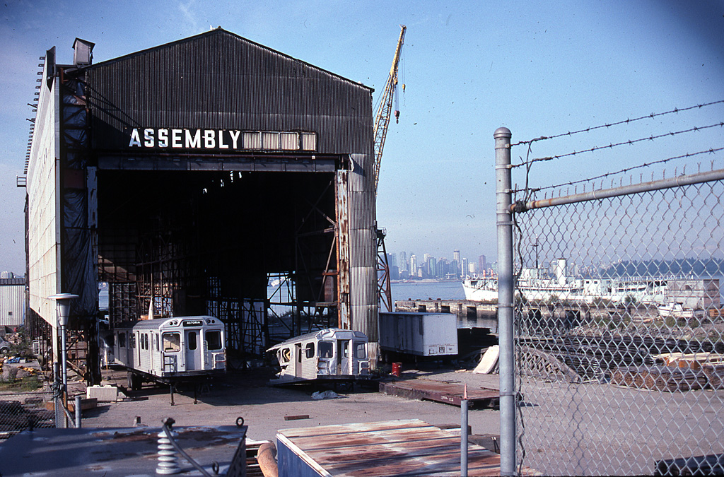

It's not the first time a TTC vehicle has gone on to a life on a studio set.
