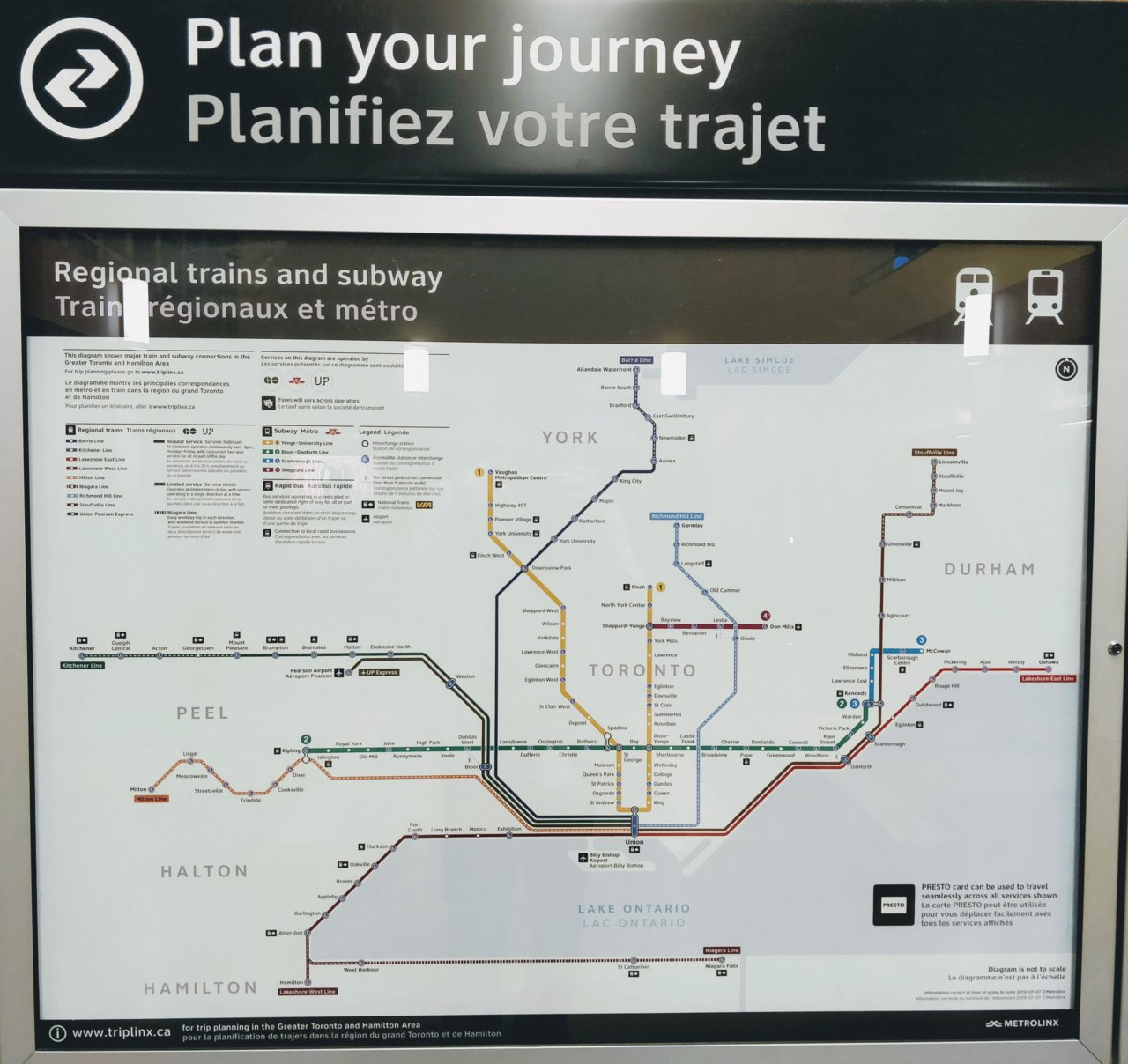

With many GO train lines becoming All Day very soon, or at least after RER, it would be nice to see them on the map too, within the Toronto borders. Maybe very subtly, like sort of in behind the TTC map, with the stations being shown (and something like "separate fare required" beside them)
Yeah, maybe a more Toronto-focused version of this GO Transit map. If you look closely, all day service is a solid line and peak-only is dashed. In the future, solid line could be 15 minute service and dashed could be 30–60 minute on the TTC map.
211433
This map is great I wish there was a high res version.
Although they need to make people more aware the boundaries of Toronto. A line showing the toronto boundaries and then the extra GO stations kind of stacked up after the boundary just to indicate "this is what is in Toronto area somewhat to scale, and the stuff outside the box is regional service to other cities.
This makes it look like Barrie is an arms throw from Vaughan.

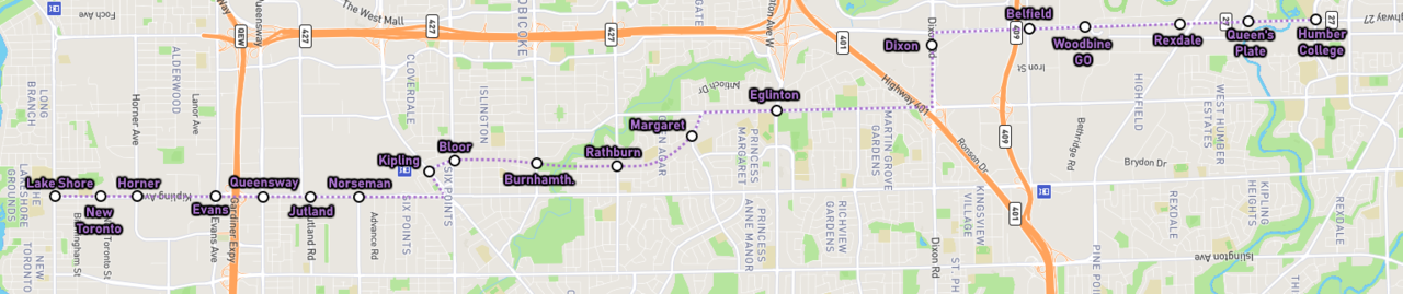

Below are two lines that I believe would be good candidates for the first BRT lines entirely within Toronto.
This is my idea for an Etobicoke BRT that uses a portion of the hydro corridor, but largely sticks to arterial roads that could probably lose a lane or two.
I'm sure not all of the stops are necessary (particularly New Toronto, Bloor, and Belfield) and a Westway stop might be warranted, but those are edge cases in my opinion. The line will connect with the 501 streetcar, a future Queensway RT (whatever it is), Line 2 and Milton GO, the Eglinton West LRT at Martin Grove, Kitchener GO at a future Woodbine station, and with Finch West at Humber College. In the case of a Finch West extension, this BRT route can be truncated to the Woodbine GO station. I think BRT works better for this route as it can use the hydro corridor through the stagnant- er, STABLE neighbourhoods of central Etobicoke, and a future LRT could be shifted eastwards.

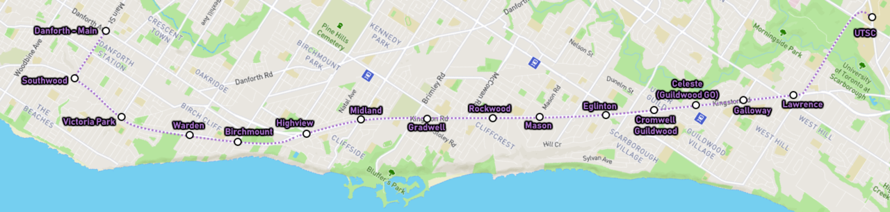

This is the Kingston BRT. I decided to terminate the line in the Danforth-Main area, which has the potential to become a prominent, if somewhat disjointed, transit hub. Not much new to say here, except that the Danforth-Kingston weaving should probably be demolished and replaced with a proper intersection first. Northeast of Eglinton, I think the line should serve as the "local" RT, allowing the Crosstown East to pass over some or all of the stops before Ellesmere.

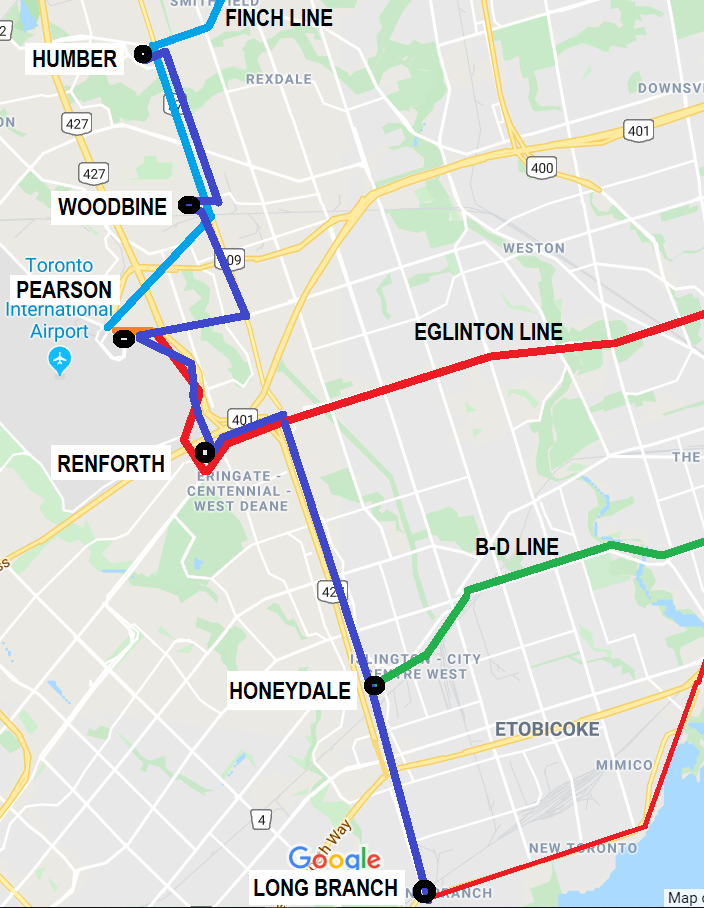

Distant future, BRT or LRT the entire length of Kipling.
Shorter term, BRT along 427/27, with stops at Humber, Woodbine, Pearson, Renforth (Eglinton Line), Honeydale (B-D Line) and Long Branch.
Your "shorter term" route assumes that Line 2 will be extended westwards, which is a nice thought but I don't see it happening. I think it's better to reinforce Kipling as the hub of southwest Toronto.
