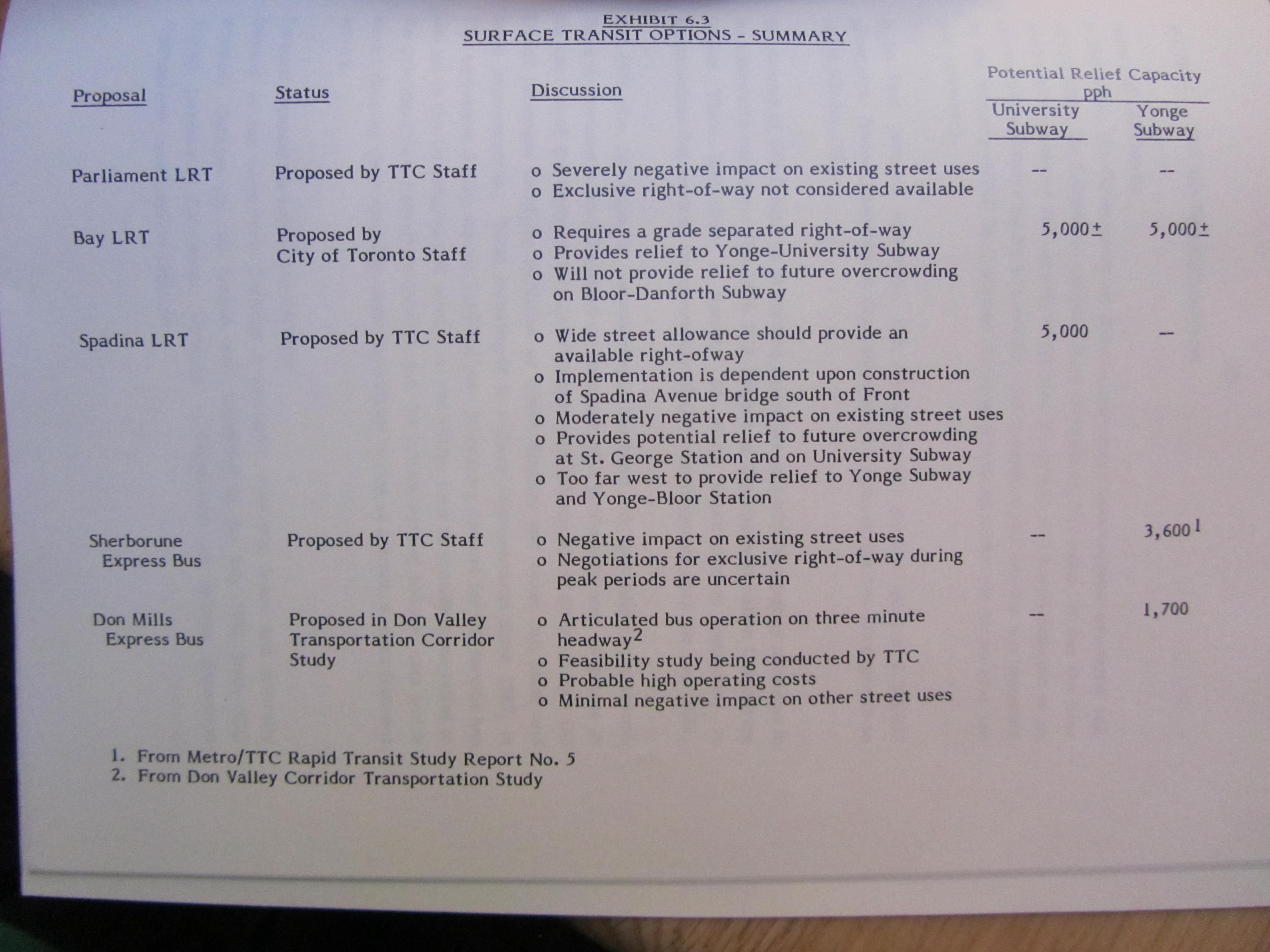

An idea of a Parliament LRT is interesting, and this was actually considered as part of the 80s-era Relief plans.

It didn't really warrant an LRT. It was studied as a possible solution for providing Yonge relief (and was thoroughly rejected in the process).
