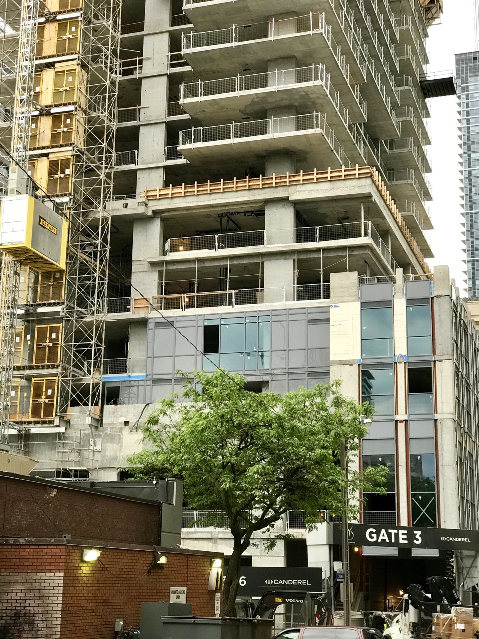

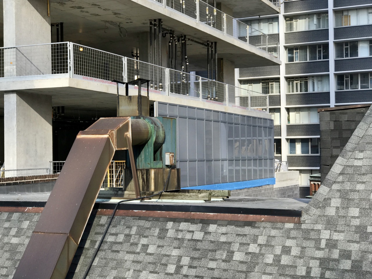

In fairness, that wall is right on the property line, is barely visible from the street, and is going to get hidden if/when Oddfellows does its expansion.
Now, the cheap, backpainted grey spandrel on the *north* side of the building, facing Grenville...
Edit: No, I take it back, that's going to be extremely visible from the street, at least based on the scale model:
(From buzz buzz homes)
This grey wall of spandrel looks ugly. I was hoping that I'd have a better view.

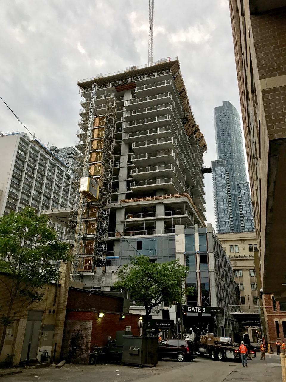

More grey ugly spandrel on the north side as well.
