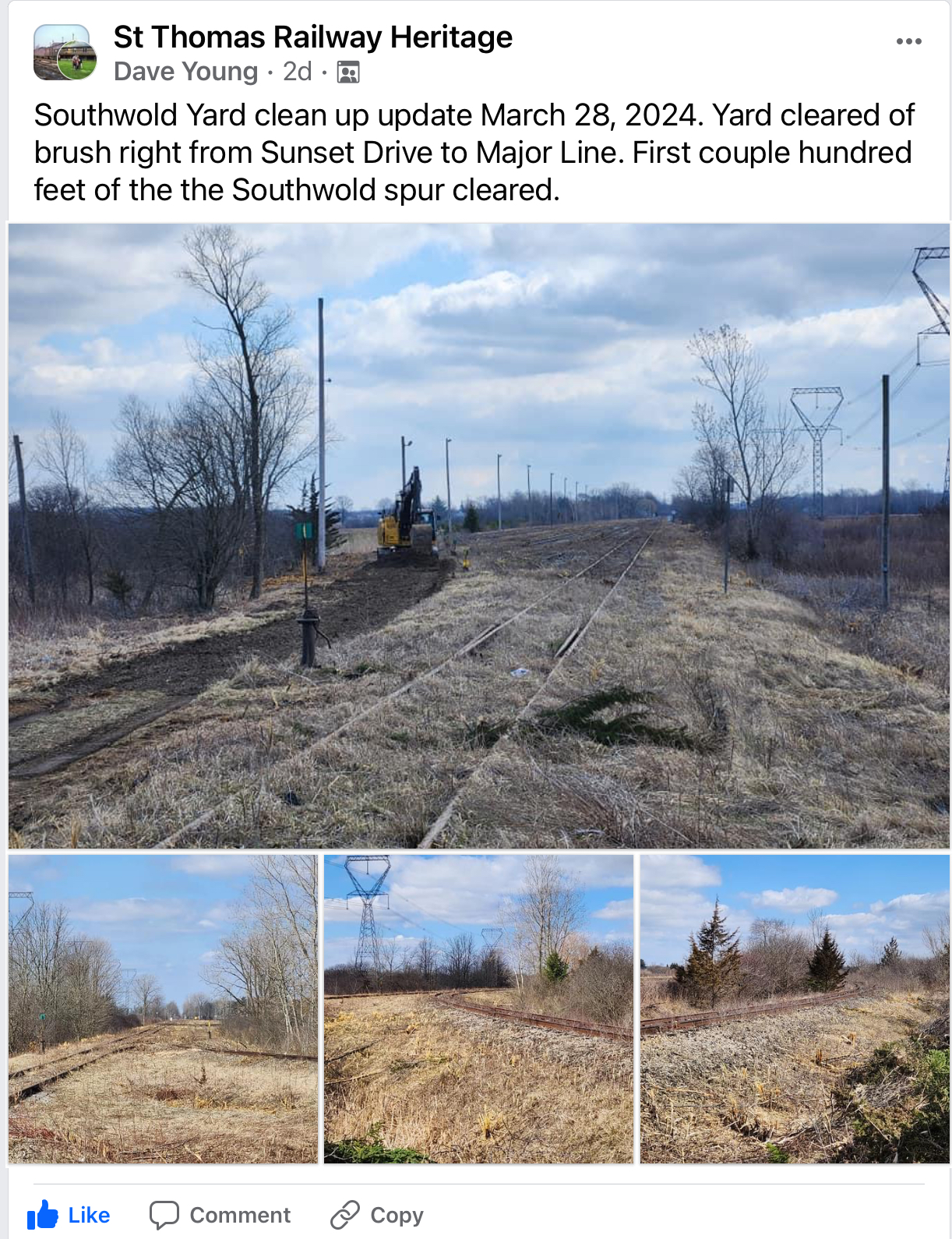

Found this on Facebook. CN is cleaning up its old Paynes Sub in St. Thomas. It was completely overgrown and impassable in recent years. It connects to the opposite side of St. Thomas from the VW plant, but has an old yard on it. CN might be planning to use it to store or marshal cars for the plant.

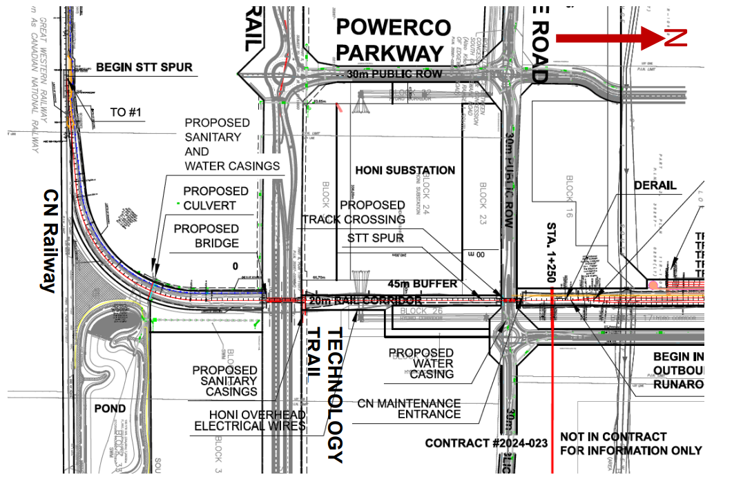

From the above, we can see the new trackage that will link the exiting to railway to the PowerCo/Volkswagen site:
The site will have its own City-owned rail yard. As at yesterday, according to this piece, the actual agreement for interlinking to CN required further work.

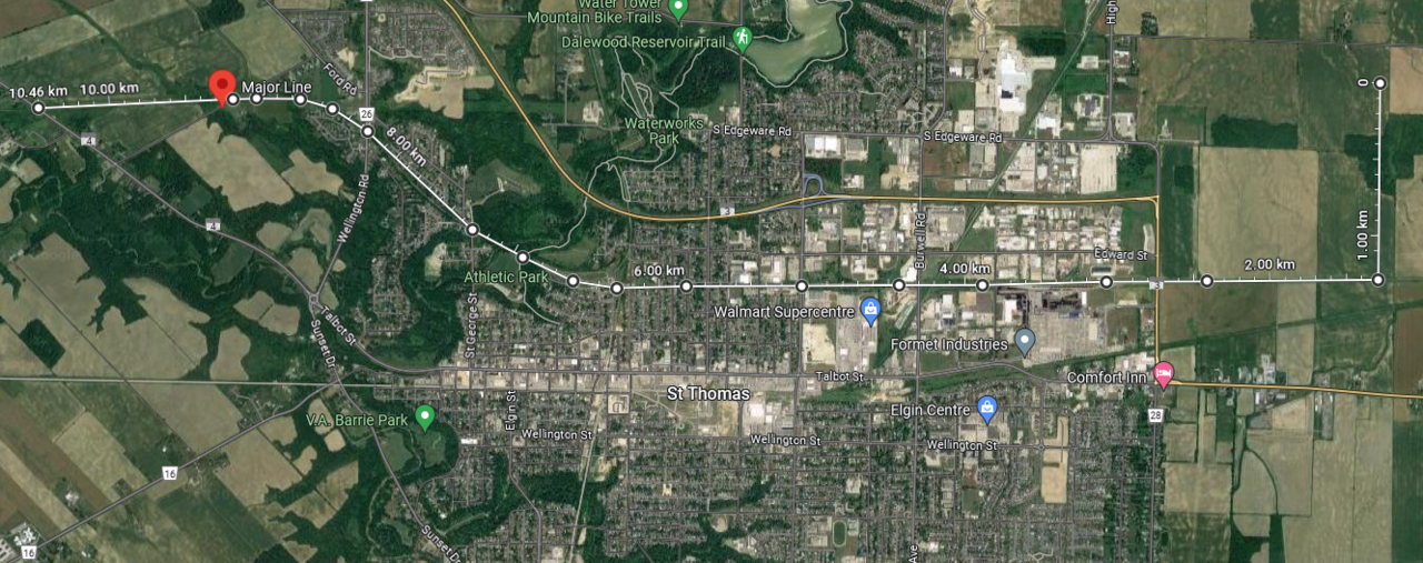

Using the description above and from @SaugeenJunction 's post, I have used google to follow the rail line from the work mentioned above ( near Major Street) which is on the left side of the image, to my best approximation of where it will enter the PowerCo lands. (right top)
Note the yellow of Highway 3 here, which will be extended to the east, and which the railway will traverse.

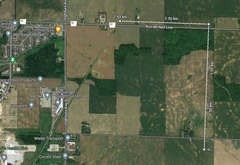

Looking at the the rough footprint of the 1500 acre industrial site (inclusive of Powerco), and placing my first white dot where the proposed PowerCo rail yard would be, I have drawn a line to the Ontario Southland trackage.
This is not the most direct route, but w/o the long term plans for the site, I drew around the 1,500 acres.
OSR is former CP trackage and to my understanding is leased from CP still. So you have intact ROW (albeit in terrible condition) to within ~2.5km of the plant, bit closer if you find another connection point further south in the site plan.

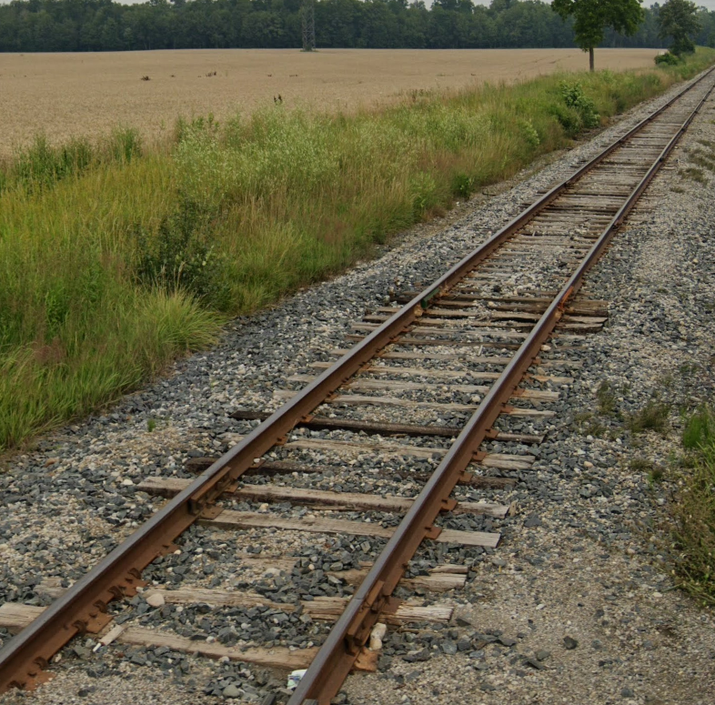

On matters of rail, I will overwhelming defer to your expertise Paul; but I must confess, this doesn't look great to my eye:
Street view: summer '23 Those ties looks per rough.

I'm not a track inspector, but it mostly looks bad because of the different colours of ballast, and the varying shades of crossties.
But I don't see many split ties, and the drainage is good - no mud. Surfacing looks good - Rails look level and I don't see any dips.
OSR runs Class 2 track which is good for 25 mph. Class 2 requires 8 good ties for each 39-foot section of rail, with a good tie under the joint bar.
The rest of the specs would mostly require measurement.
I do know that OSR maintains a pretty capable track maintenance staff, more people and experience than most short lines..

I was looking more at the rot on some of the ties, the fact they aren't precisely equal in length anymore, and that some are also not straight.
^^^ this is the expertise that I lack and you possess I was noting.
Using a spacing between ties of 19 inches, what's that, something like 16 ties over 39ft?
So 1/2 of them 'good'?
Hmm
I suppose i just think 'class 2' looks kind of junky in general if the picture I posted is representative of said class.
Obviously not all freight lines are going to be 'class 6' But that's a big step down from most mainline rail I've seen.
So long as the ties will still hold a spike, they are mostly considered a pass.
You are correct that a railway track of lesser speed will have some good ties and some not good ties. The number that must be good goes up with track class and speed. In a “mature” railway track, the maintainers will selectively replace the worst of the worst but only up to the needed standards. And if the track is downgraded, they can rest on their oars until things get really bad… a tie will last 50 years or more, after all.
In the photo above, one can see plenty of dark black ties which would be the new ones that OSR has inserted fairly recently. So my inexpert eye says they are keeping up with maintenance. Similarly where they have dumped the blacker rock, it speaks to having looked for what is needed. Certainly a major railway needing heavier use out of the track might do more in the way of undercutting the full length of the line and cleaning the ballast and/or dumping new rock more uniformly. But this, after all, a railway with only so much money available.
It would be interesting to compare this picture to the CN line that connects St Thomas to London. That’s where the auto traffic from VW will be carried. I bet it’s pretty similar.

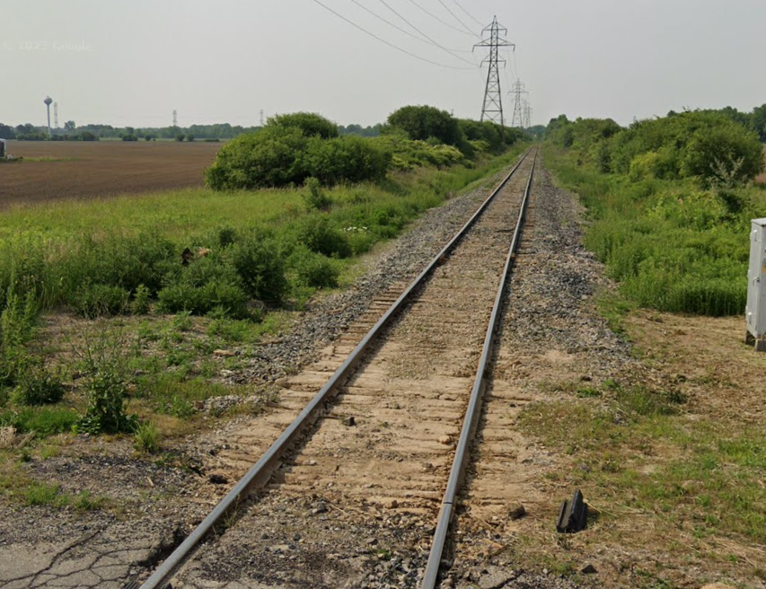

Since you asked, this is the CN line crossing Ron McNeil just outside St. Thomas:
I think that actually might look worse, but its definitely not materially better.
Ugh. See the spot in the foreground where the mud has pooled? That is definitely a problem in the making - it indicates that drainage is poor and water is collecting. The trackbed has “pumped” the mud up into the ballast and basically the rock ballast either isn’t there any more or is badly infused with silt.
The next thing that happens is that a low spot forms and eventually the trackbed softens. The low spot can lead to the underside of equipment making contact with the higher level crossing surface (possibly plowing up the asphalt) or even breaking the rail as the track will flex with every wheel that goes over it. As well, the ties rot out faster because they are sitting in water.
This is especially common at road crossings because the track bed has a different hardness than the roadway bed and things compress differently as trains and autos pass.
The solution is to undercut the track bed in the weak spot, put in new rock, and resurface to achieve a better longitudinal plane. And revisit the drainage away from that spot. But that only happens when the railway decides to spend the money.
All of this is a big digression from batteries and auto plants, perhaps…. Except that, with the amount of money that St Thomas and Ontario are sinking into new infrastructure to attract these industries …. Roads, utilities, Hydro substation etc….. it might be prudent to look at the state of the rail lines and ask if they are up to the task. Fundamentally, at the current time, St Thomas sits on lower grade branch lines…. Not unsafe, but not best possible either. Quite possibly CN, OSR, or whoever are already asking for this or have built it into their tariffs.
