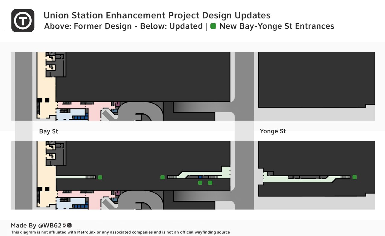

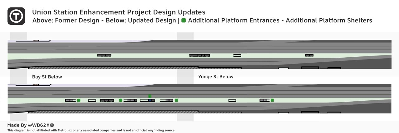

I created before and after maps to better represent the USEP scope change we found out about today:
The previous design forced up to two entire trainloads down one escalator into the concourse, and mobility challenged individuals would have needed to travel 400 metres to access the nearest elevator, this is no longer a problem in the modified design.
The additional entrance in the Bay East Teamway is good for commuters, without this entrance the Lakeshore services would be inaccessible from the teamway.
Now that Union Station will have a presence on Yonge Street, I hope there will be adequate signage guiding customers to things that can’t be accessed through these entrances, because the TTC and most points of interest are so far from this area:

I’ll have to come back later with a further analysis or potentially even a map, but here’s what I found today.
Revealed in the landowners tenants slideshow was a massive USEP scope increase on the east end:
This project now includes 5 additional platform entrances to the new platforms. 1 entrance will be built off the Bay East Teamway, the other 4 entrances will lead to tunnels under the rail corridor, with exits on the west and east side of Yonge Street.
This is a massive reveal of information, and expands the station’s footprint significantly, Union station will now span from Lower Simcoe to Yonge Street
I wonder now about access from areas east of Yonge. If a north-south pedestrian tunnel were built, those additional entrances would be able to serve both the Pinnacle One Yonge development, as well as any redevelopment of the Church Street parking garage. Jarvis will also now be less than 400 metres away from the nearest platform entrance.
I am a bit puzzled, are they thinking of building new teamways under the rail berm on the east and west sides of Yonge Street or only 'Virtual Circulation Elements to get one up/down from the new bridges to the north side of the berm and the existing (ghastly) sidewalks?
From the 3d diagram included in the presentation, it does look like they are building tiny lobby areas for
the new entrances:
My suspicion is that they’ll be extending these spaces north as the legacy platforms are merged and lengthened, to create full teamways. Something like this:
This appears to be a cut and cover project, so building the full teamway at once is impossible without cutting the rail corridor off.
the new entrances:
I wonder why there's no connection planned between the Bay vertical circulation and the Yonge west vertical circulation. They look like they wouldn't be far apart.
