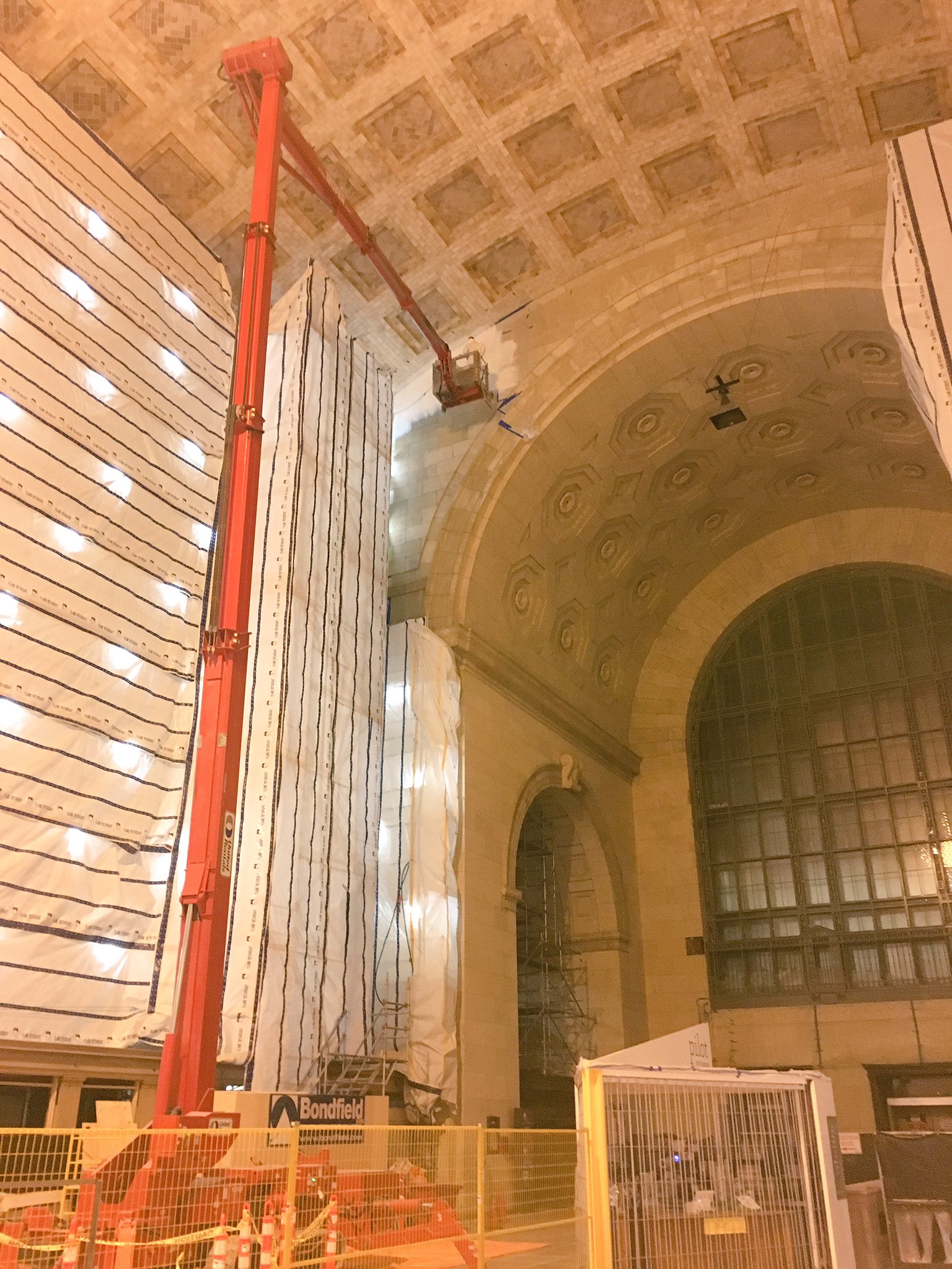

So this image was posted by Shawn Micallef on Twitter earlier this evening.
Any ideas as to what they are using to clean with? At first I thought they were shampooing the walls...

Lazer cleaner likely. Burns the upper layer of the limestone off, leaving clean limestone behind. Works similar on steel for removing surface rust.
I doubt laser cleaning would require or produce massive amounts of white (presumably cleaning) materials. My understanding is that laser cleaning burns it off clean.
If this is laser cleaning it is obviously being treated with some sort of a solution
Burning would leave it black or highly discoloured. It must be hot enough and of the right wavelength and focus to *vapourize* the accumulated material (much of it metal in many forms, mostly oxide). How specific can laser removal be? It can remove tattoos on human skin, and leave only the slightest of burns, like a mild sunburn, and leave the skin as clear as it was before the tattoo was applied.
And few pages back someone (Interchange?) posted an amazing video of laser cleaning of the Parliament building in Ottawa. They seem to be doing same here. The video is worth looking at and does not seem to involve any solutions.
UPDATE: Here it is: http://www.tpsgc-pwgsc.gc.ca/citepa...habilitation/parlement-parliamentary-eng.html

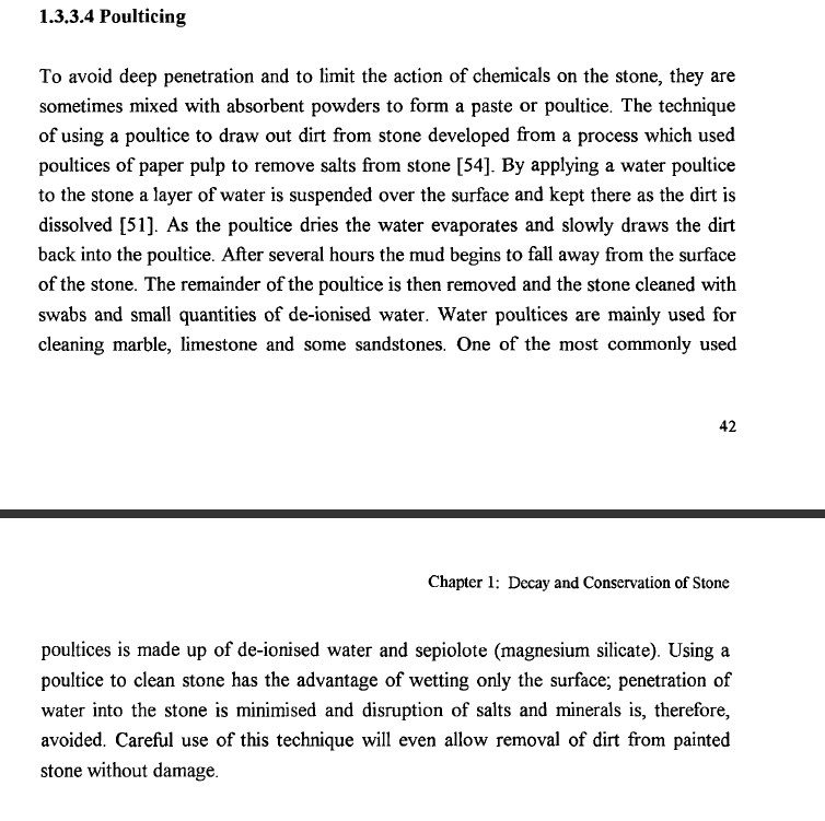

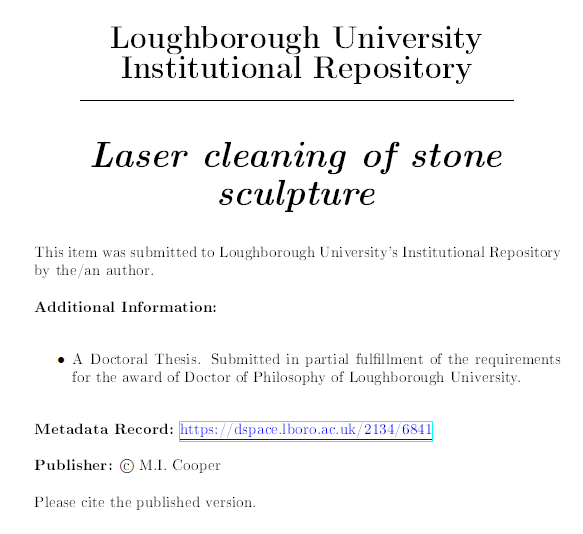

That's not laser cleaning. It's most likely a poultice or gel being applied: (it might be post laser to correct and stabilize the yellowing of laser cleaning)
http://www.buildingconservation.com/articles/poultices/poultice.htm
