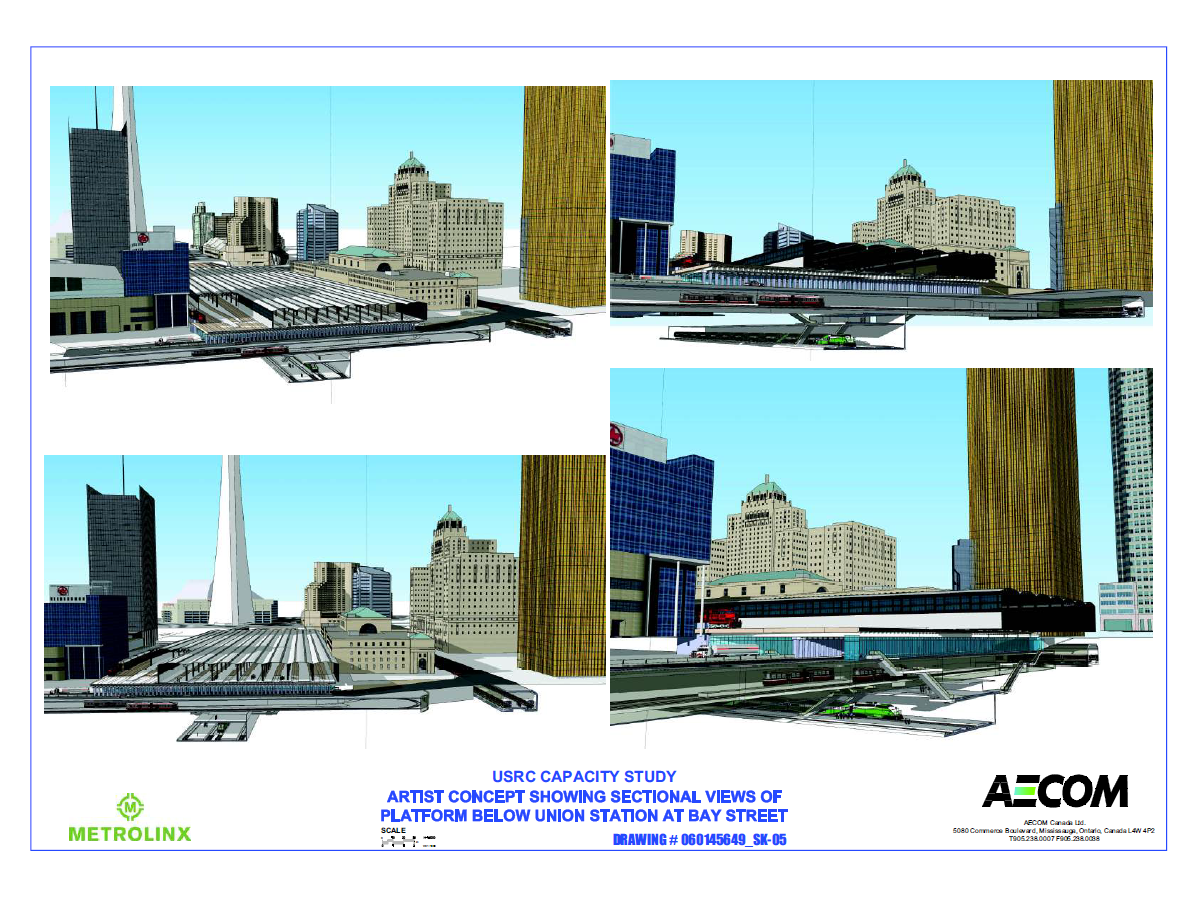

Nope - it was actually considered as a solution to the capacity problem at Union - from USRC capacity study report (hosted by Steve Munro):
https://swanboatsteve.files.wordpress.com/2011/12/usrc-track-study_ugstationdwgs.pdf
These plans were mentioned as late as this year in the SmartTrack business case, page 51: http://www.toronto.ca/legdocs/mmis/2016/ex/bgrd/backgroundfile-94599.pdf
Costs $900 million to build, and "Requires up to two new platforms at Unions Station. Costs provided for Simcoe Station concept - Underground Station with tunnel entrance just to the West side of Union Station. Costs from USRC EP Report based on the completed high level conceptual design"

It's quite a bit further down in the bedrock so I am not sure if one can just rough the tunnel in as a way of saving money now (not to mention you can't rough it in without considering how it relates to the rest of the station, tracks, etc). Having said that, there isn't even any planning for that eventuality - I don't recall the mall space is designed with future connections to underground platforms in mind. If it gets built, you can almost bet that the solution will be jury-rigged, just like the LRT loop.

As for tunnelling under that corridor, there's some very real problems tunnelling that deep in Toronto, the rock tends to compress. This isn't Stockholm or even Montreal unfortunately as per type of underlying rock.
No matter how you look at it though, hands are now tied to further expand track capacity at Union, save for this:
