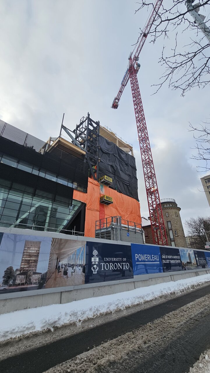

From this morning:
Honest question: why couldn't they just build it with an all steel structure? Can't imagine using wood saved them any material costs here.
The whole point was to do it in wood. It's not about 'saving material costs', it's a demonstration / 'learning' building for future construction tech.

Looking at the pictures, I'm hoping it's not just wood superficially wrapped around steel beams. Is it? It would be a shame if the wood is just for show.
Or are we just seeing two steel framed truss "cores" going up the height of the building, surrounded by fully wood-beam structures around them?
No, it's fully mass timber. The exit stair cores are steel as a requirement by Toronto Fire, due to the timeline that the building permit was submitted. If it were now, that requirement would not have been required.
Any steel used is due to the challenges have having a cantilever with mass timber...this is still a bit of a challenge out of mass timber, but the cantilever is required to make the floor plate viable for use.
