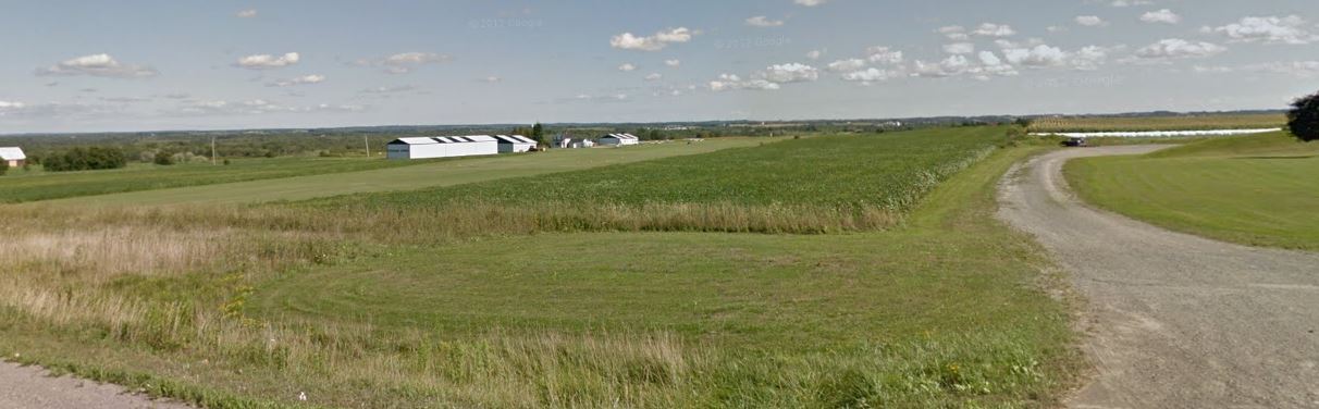

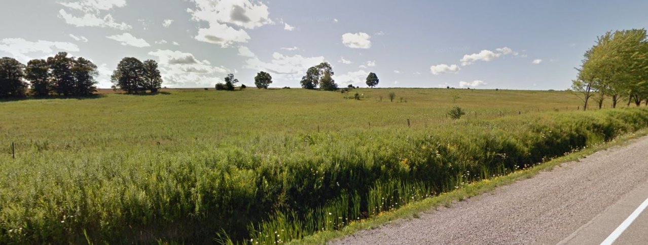

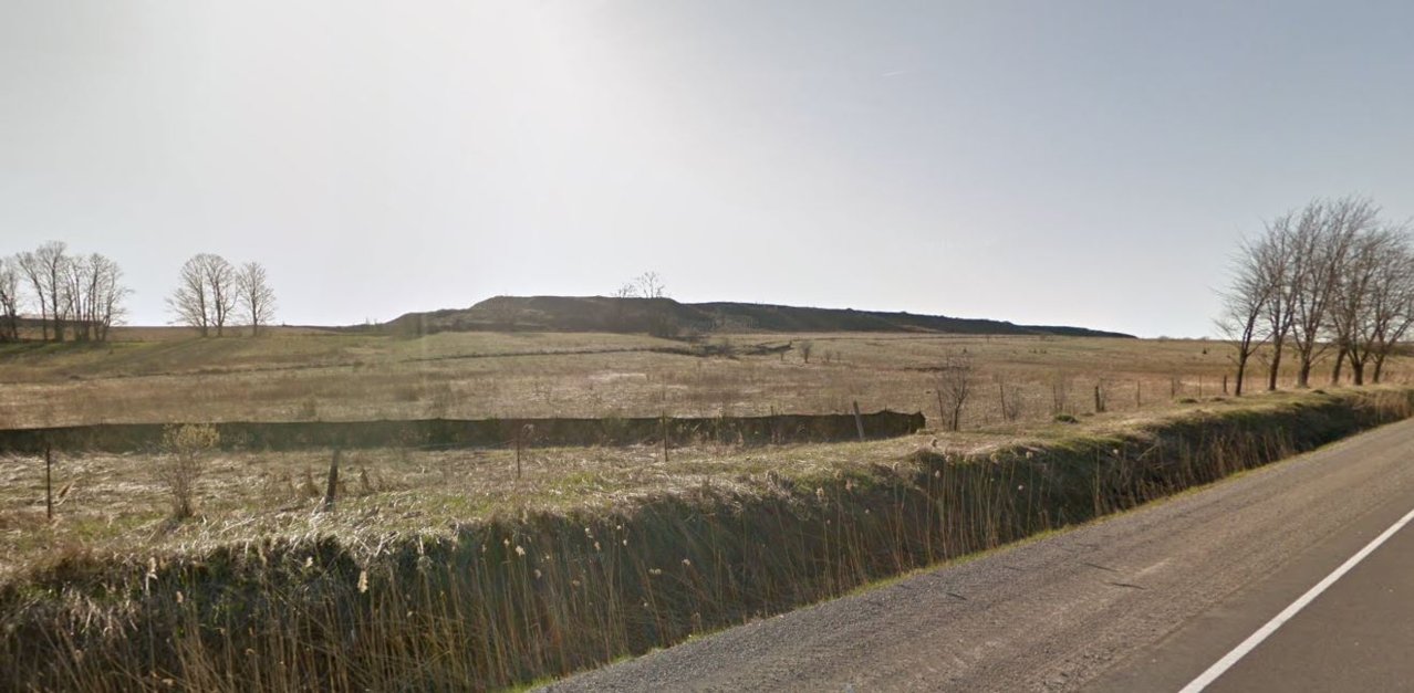

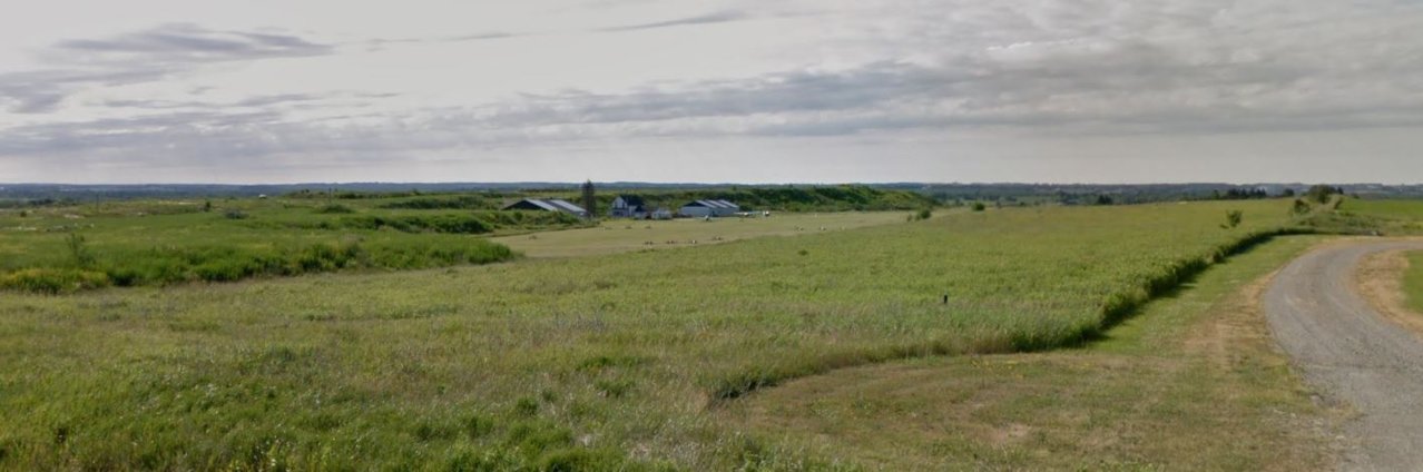

^ I prefer the view from Highway 12. My guess is that the volume of fill dumped is about double the amount that will be excavated from the Well, as of 2016 satellite imagery (the fill area is about 120,000sm, and appears to be about 10m tall)
2011:
2018:
2011:
2018:
