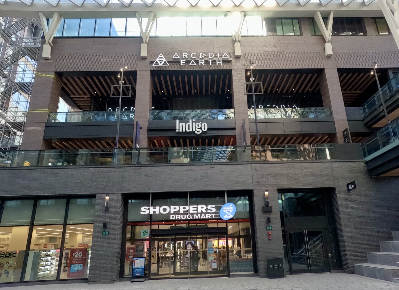

Also, am I alone in finding the Well slightly hard to navigate? I was on the top level, walked towards Indigo, then found there was no escalator/staircase to be found, so I had to backtrack just to get to the lower level.
It wasn't too cold today, but just being there felt like being in a wind tunnel.
There is an elevator by Indigo, but that doesn't seem like a scalable solution.
