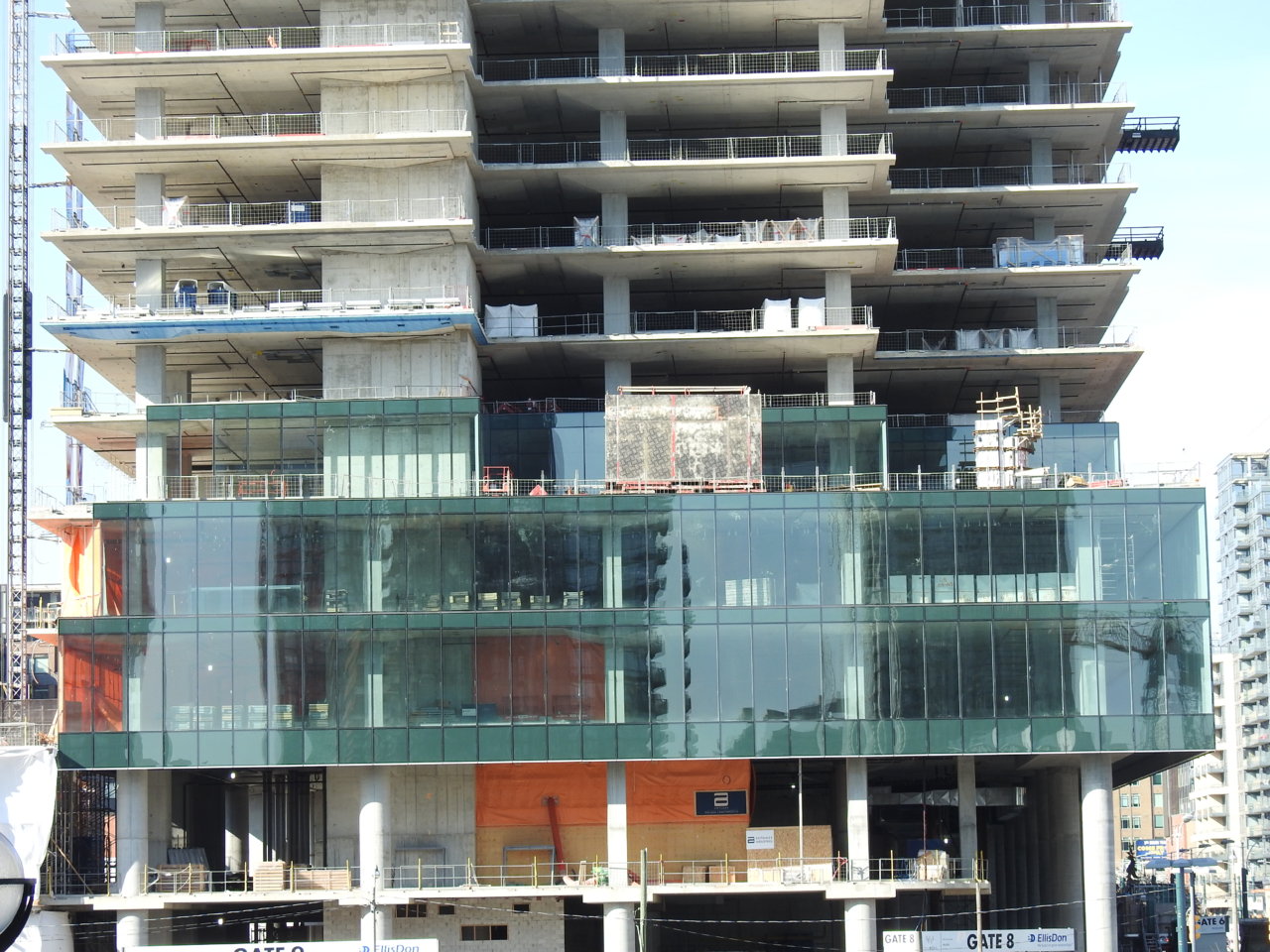

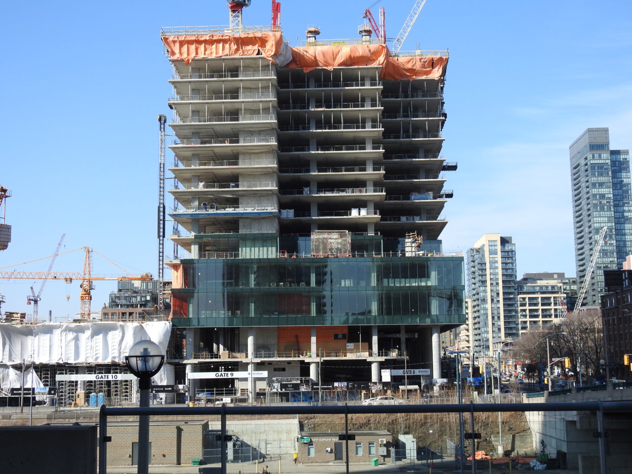

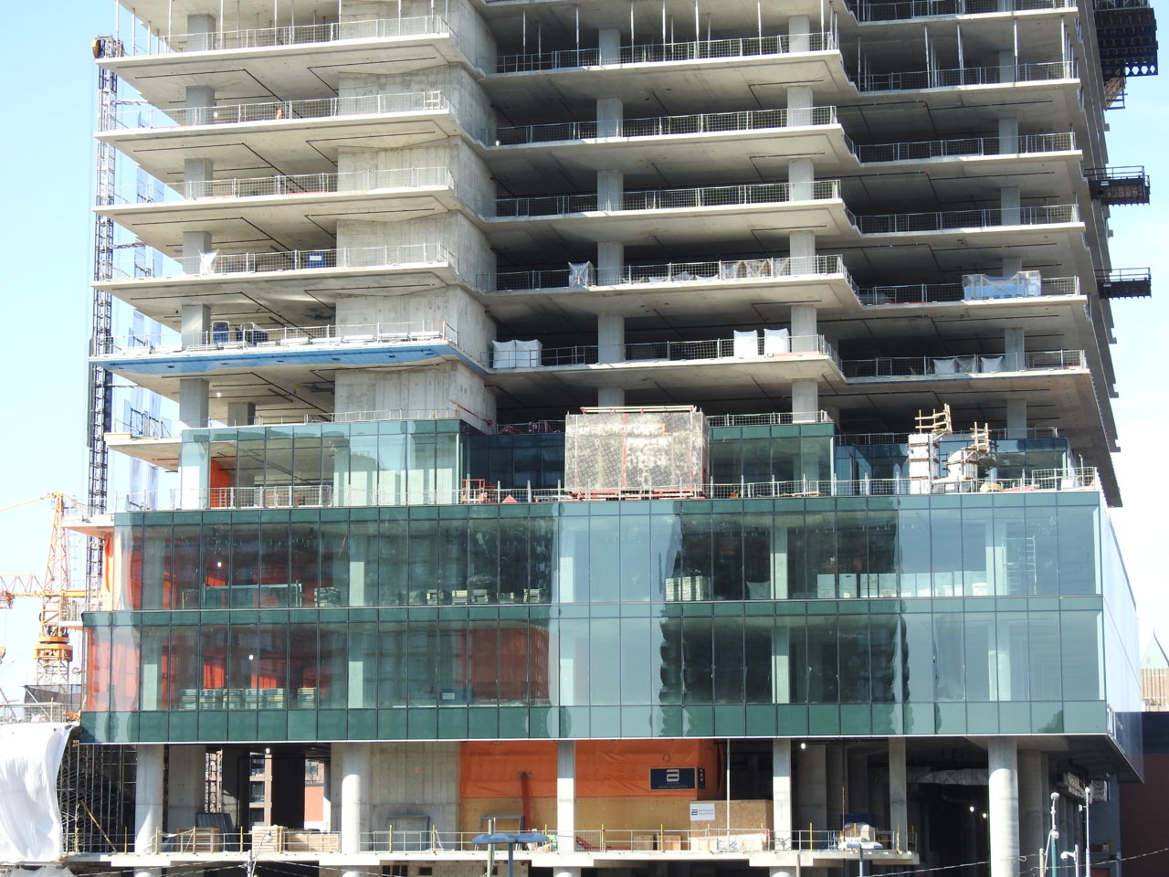

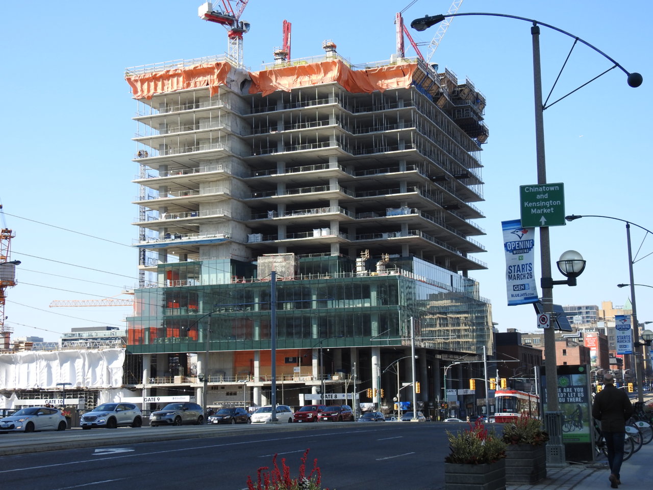

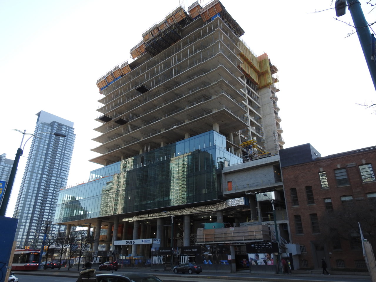

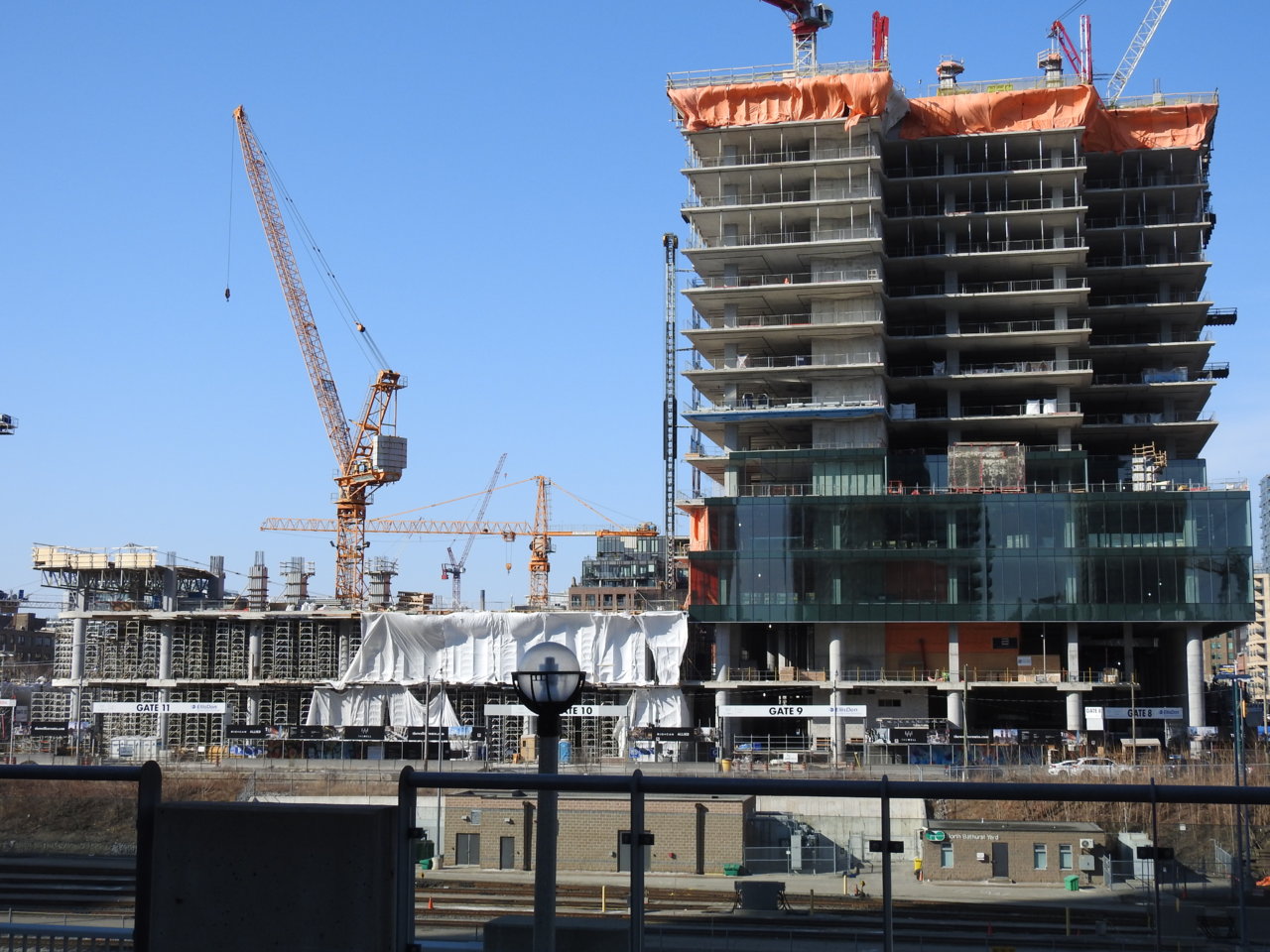

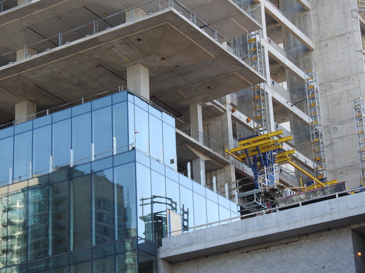

Nope, up to 12 metres (or the height of adjacent tree canopy, if higher) they have to apply markings on the glass, typically frit, no matter the colour.Seems like a situation similar to the LCBO building on Queens Quay.

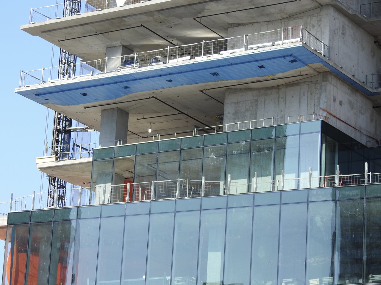

For those more informed and knowledgeable than me - does this have to do with the bird friendly guidelines? It doesn't seem that it's a coincidence that there may be a switch from translucent to more mirrored/reflective glass about 10M up or so.
"Let the record show I love The Well" - Larry David*Breathes sigh of relief*
The only exception is if they've sprung for Ornilux, which has a pattern that's only visible to birds. Weirdly, the SPA plans show a frit pattern on level 5, but not 3 or 4, so I don't know what's going on here.Nope, up to 12 metres (or the height of adjacent tree canopy, if higher) they have to apply markings on the glass, typically frit, no matter the colour.
