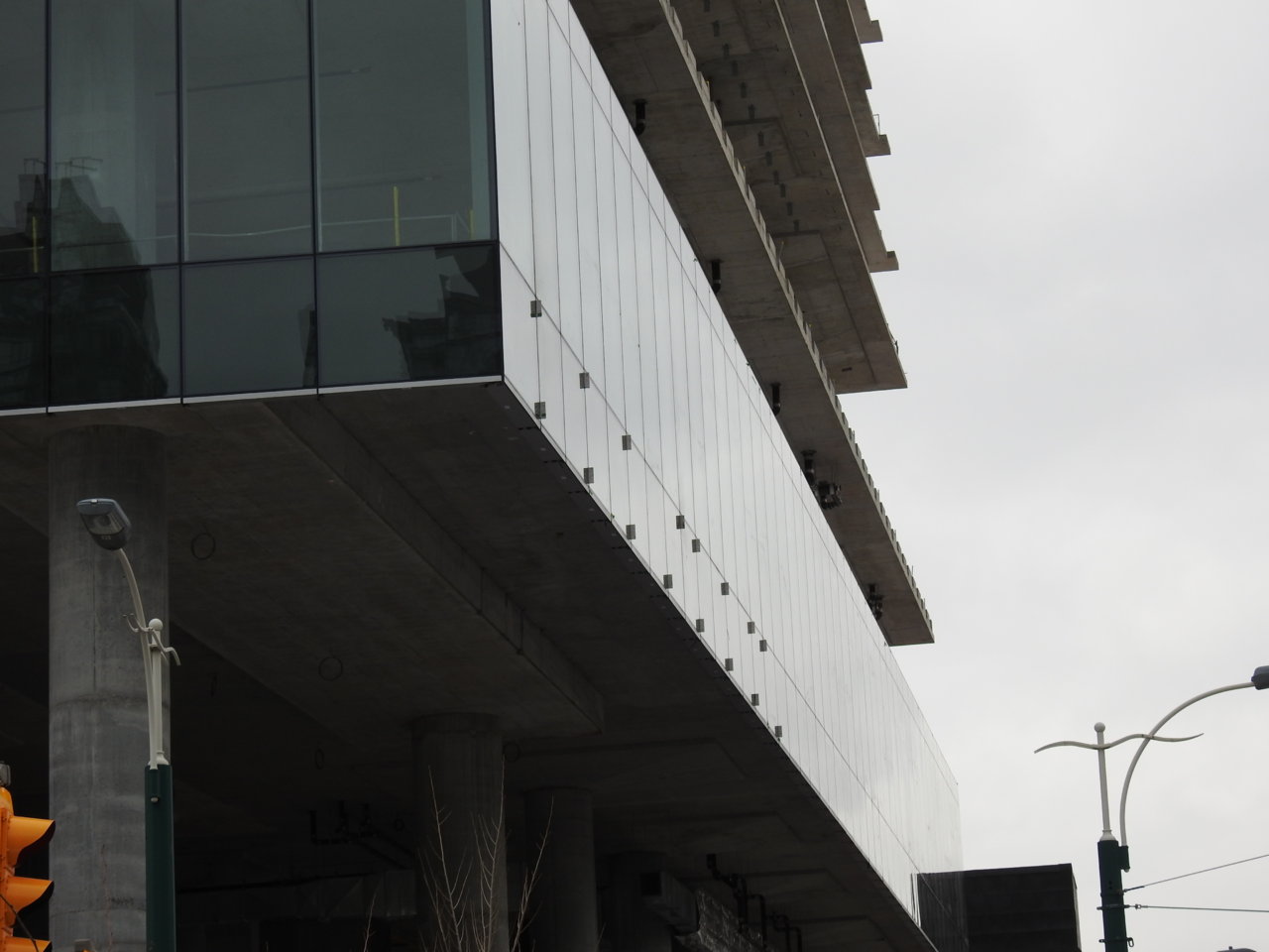

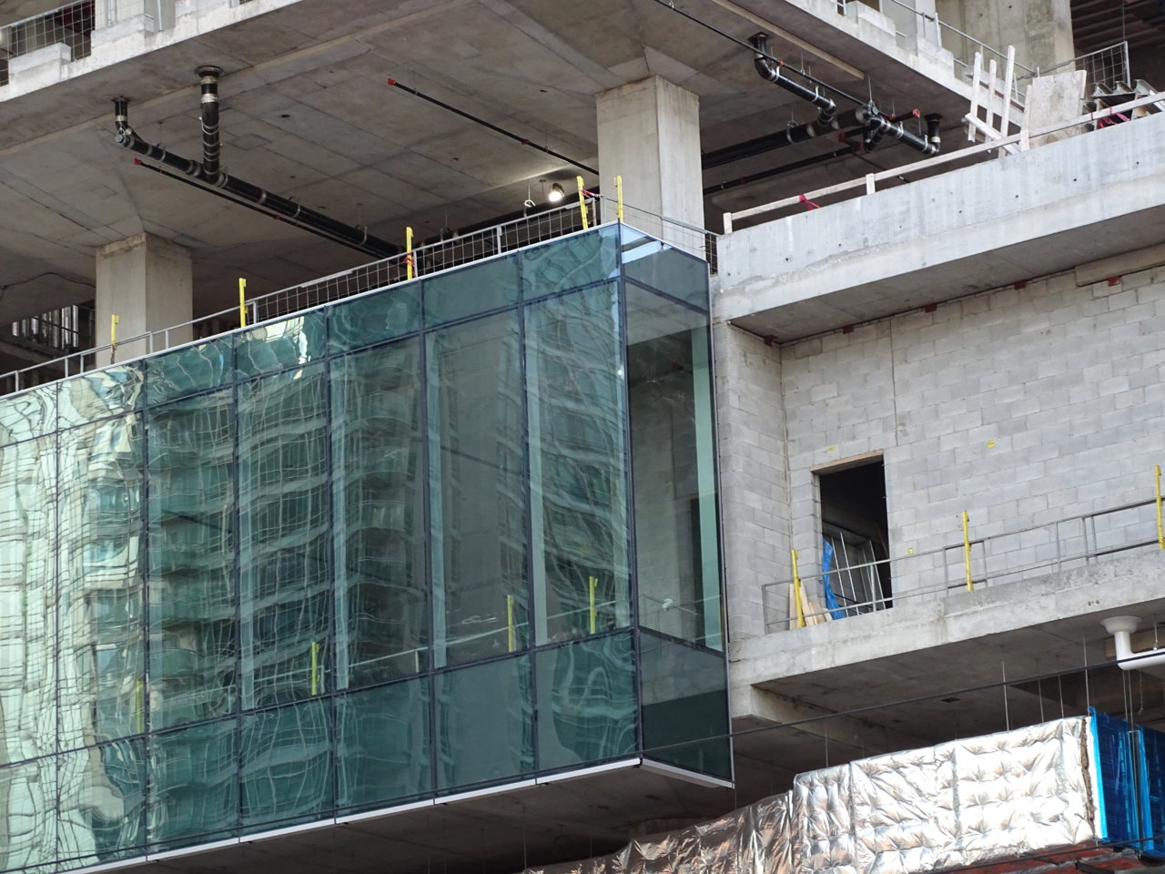

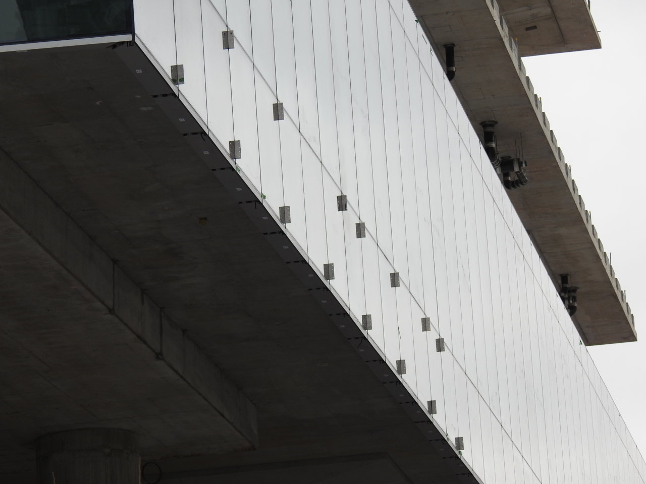

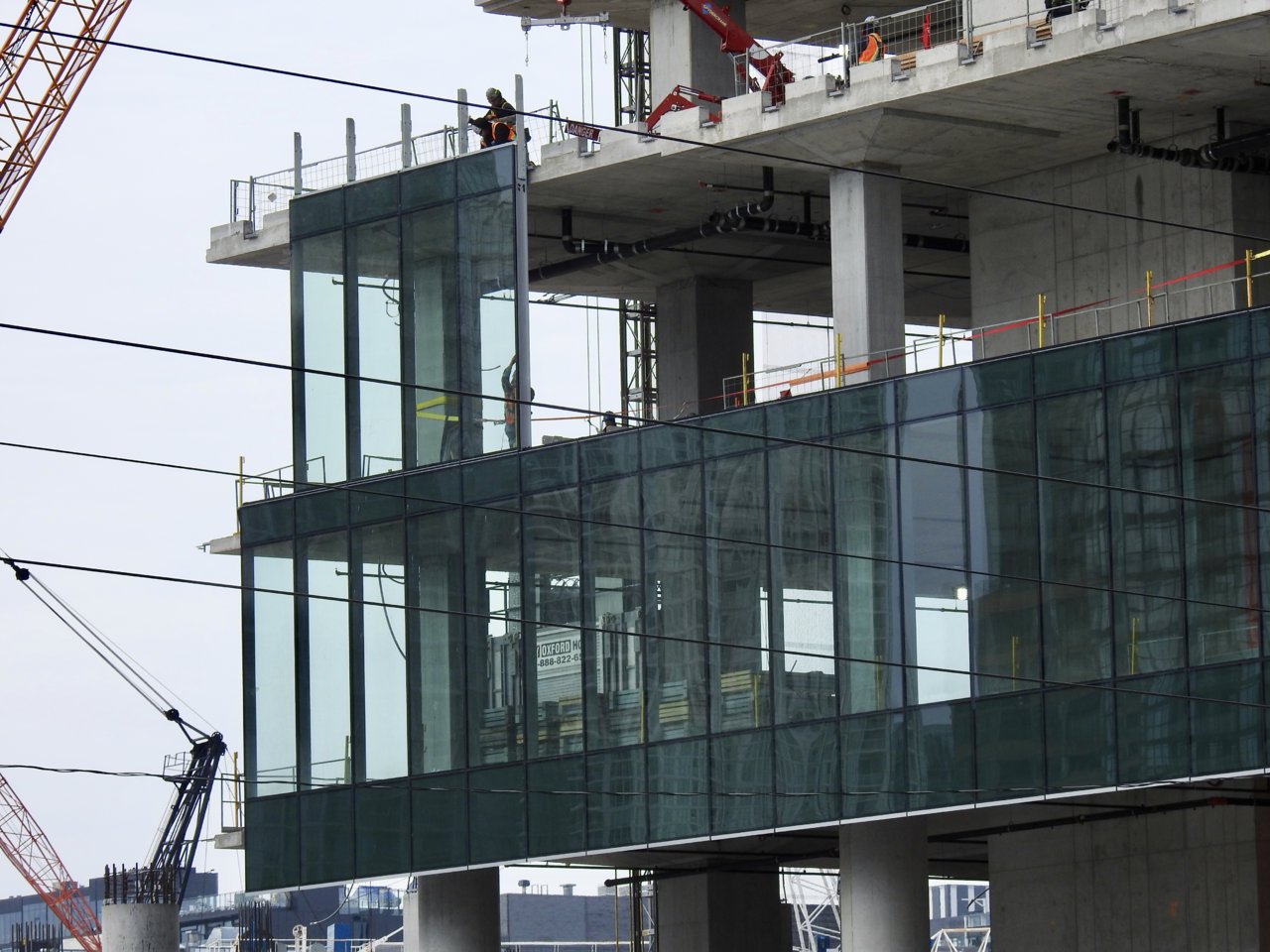

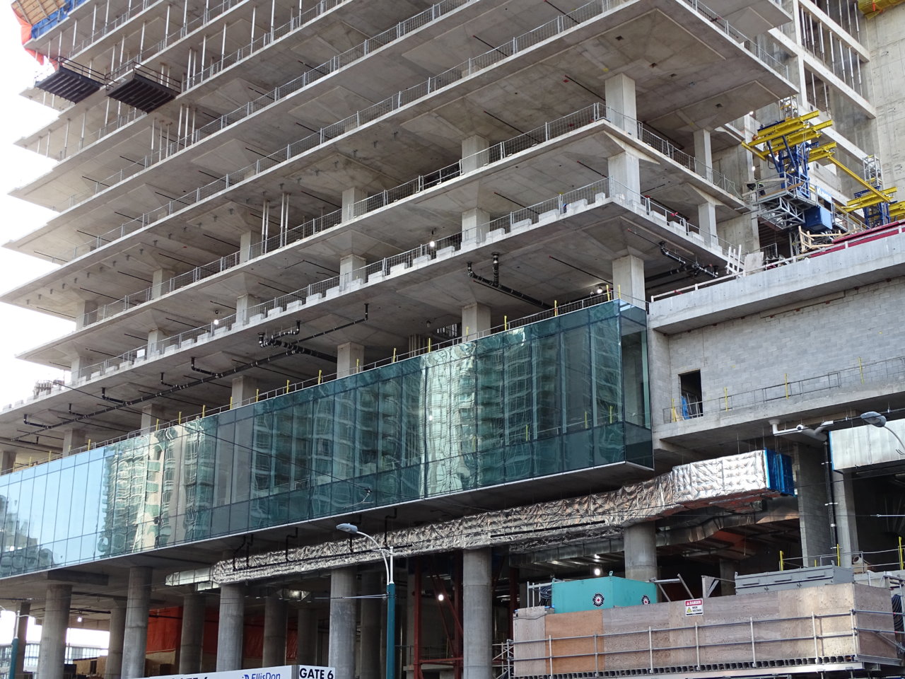

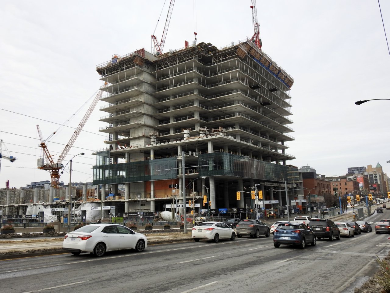

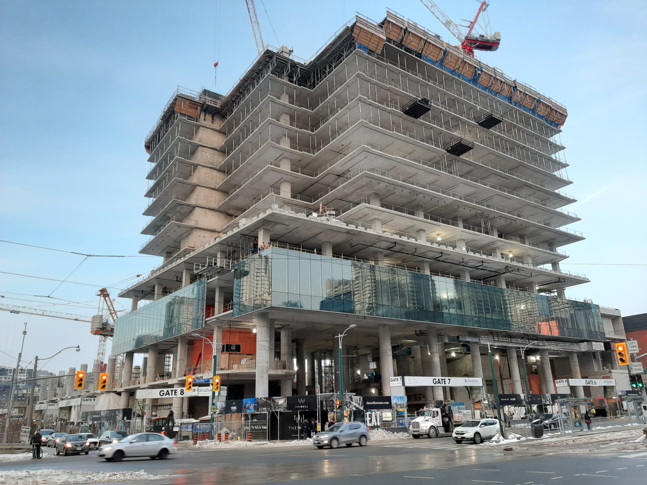

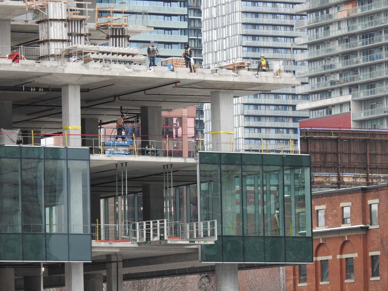

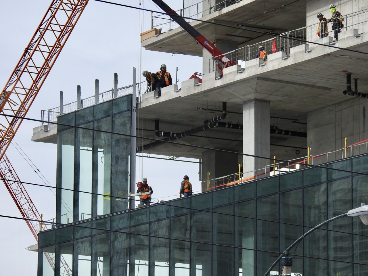

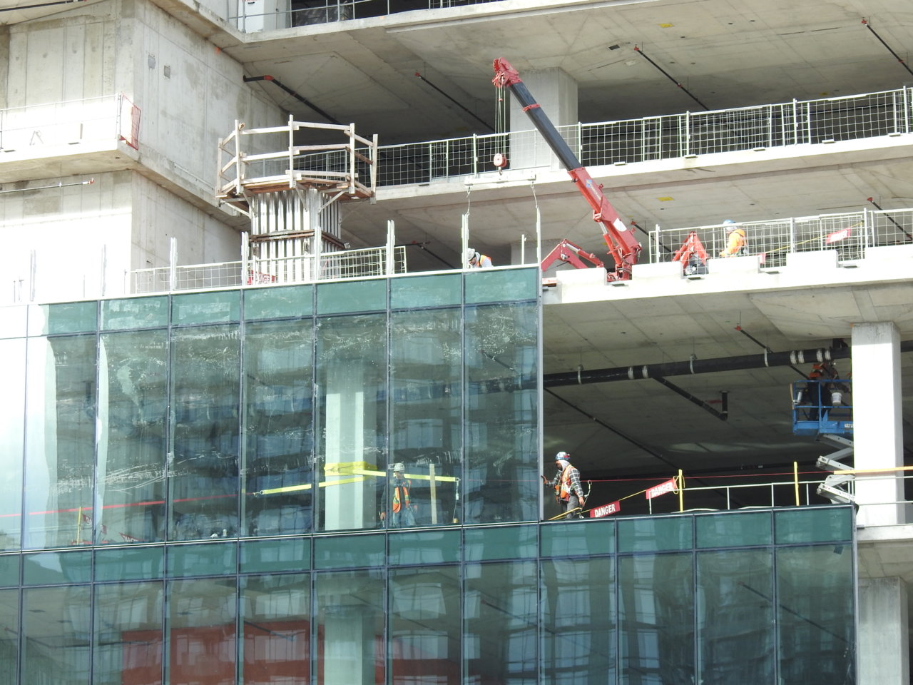

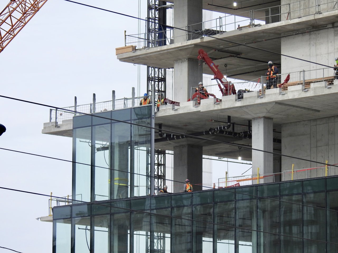

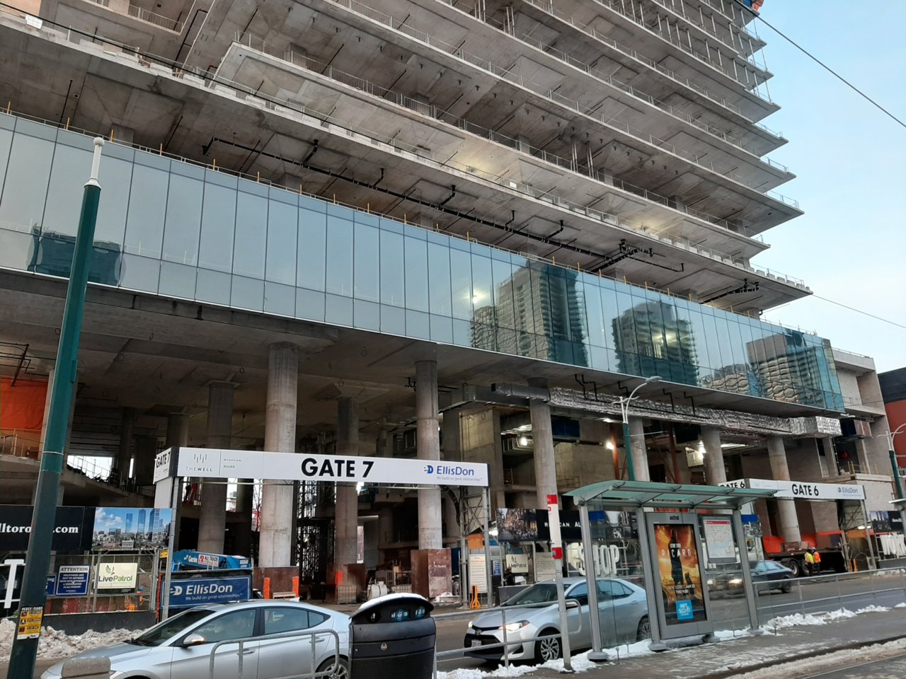

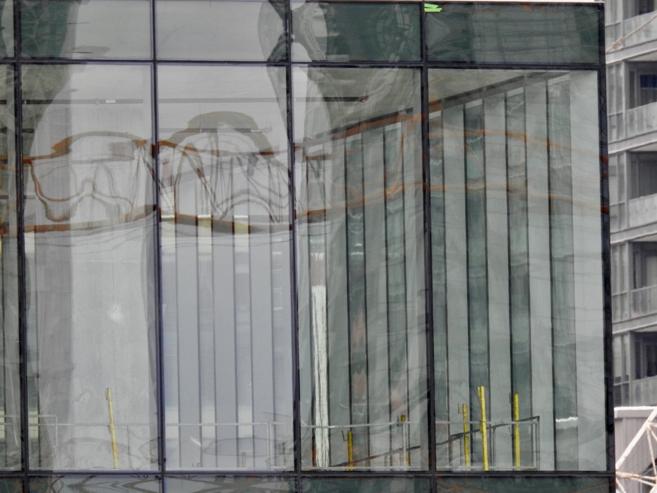

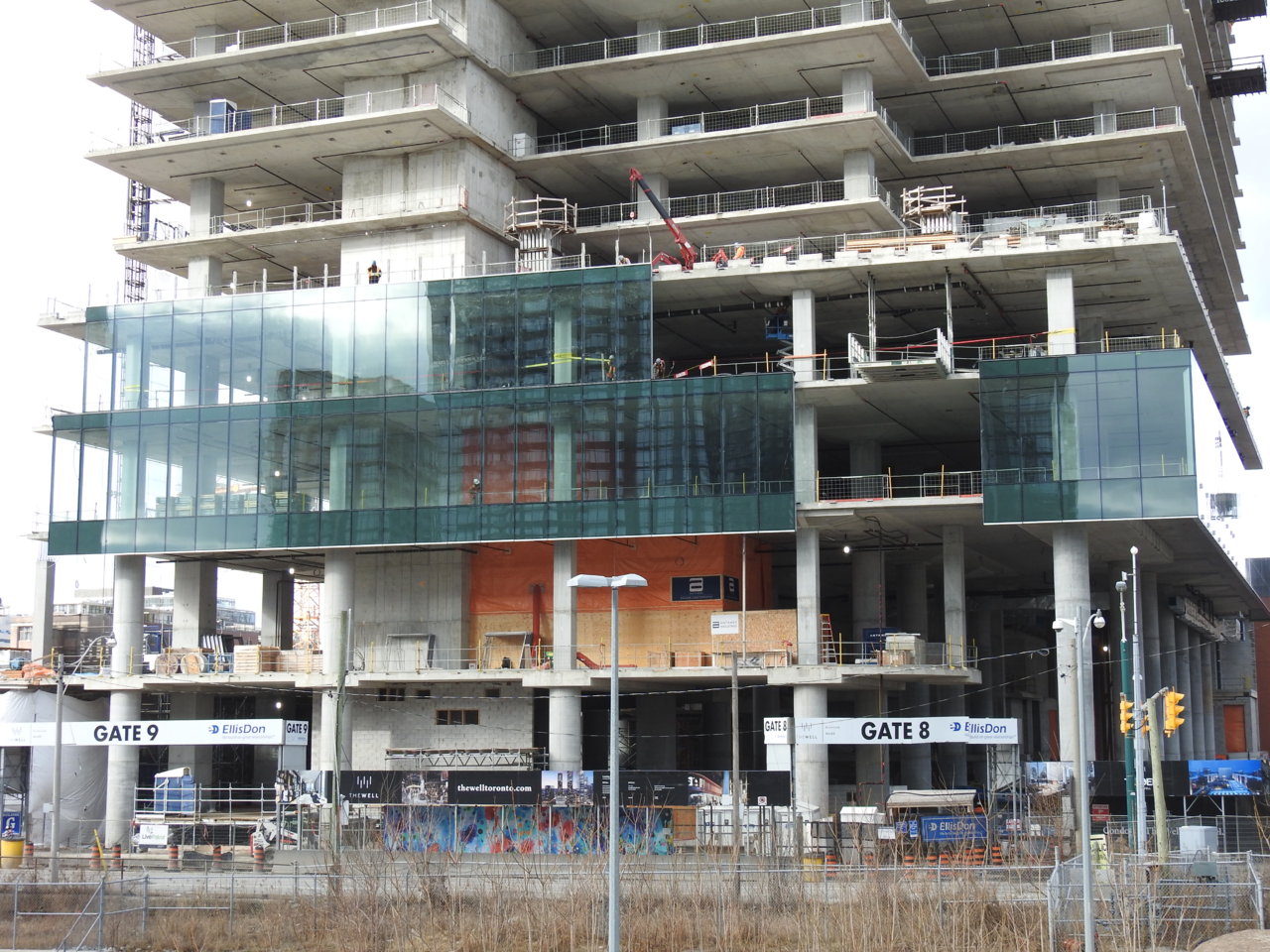

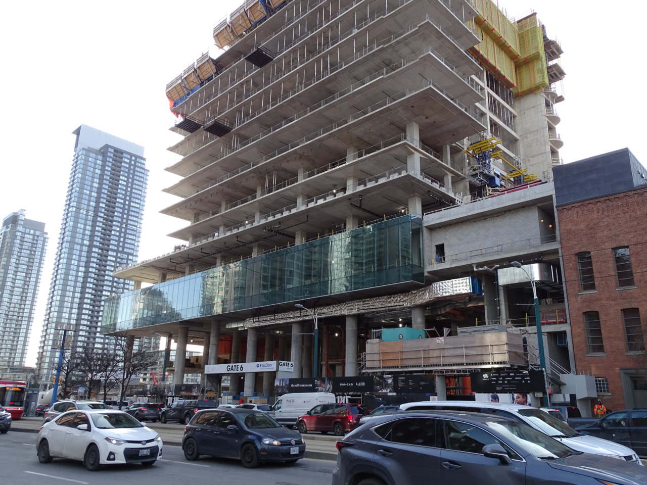

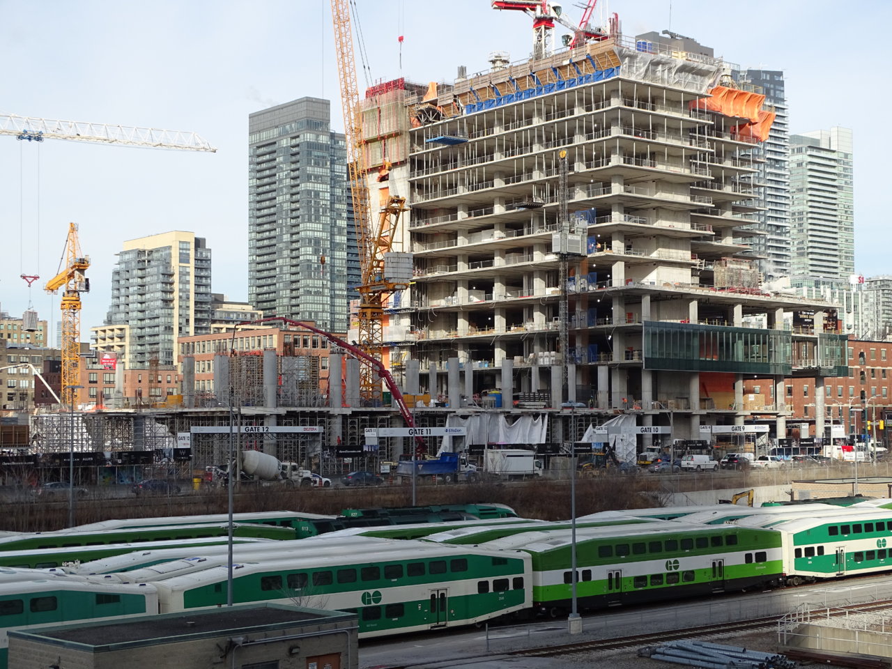

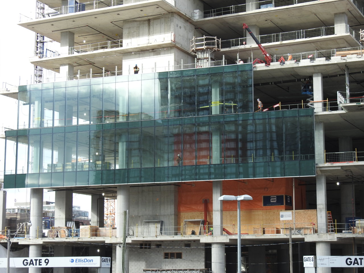

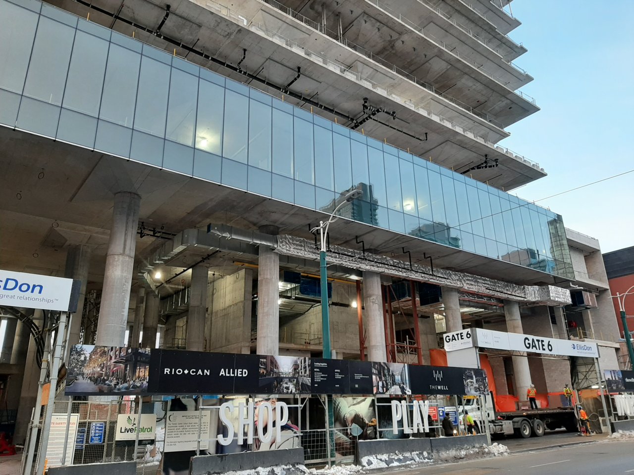

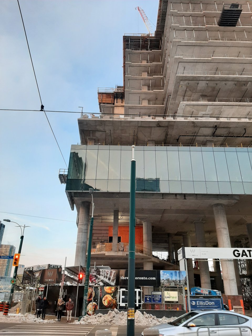

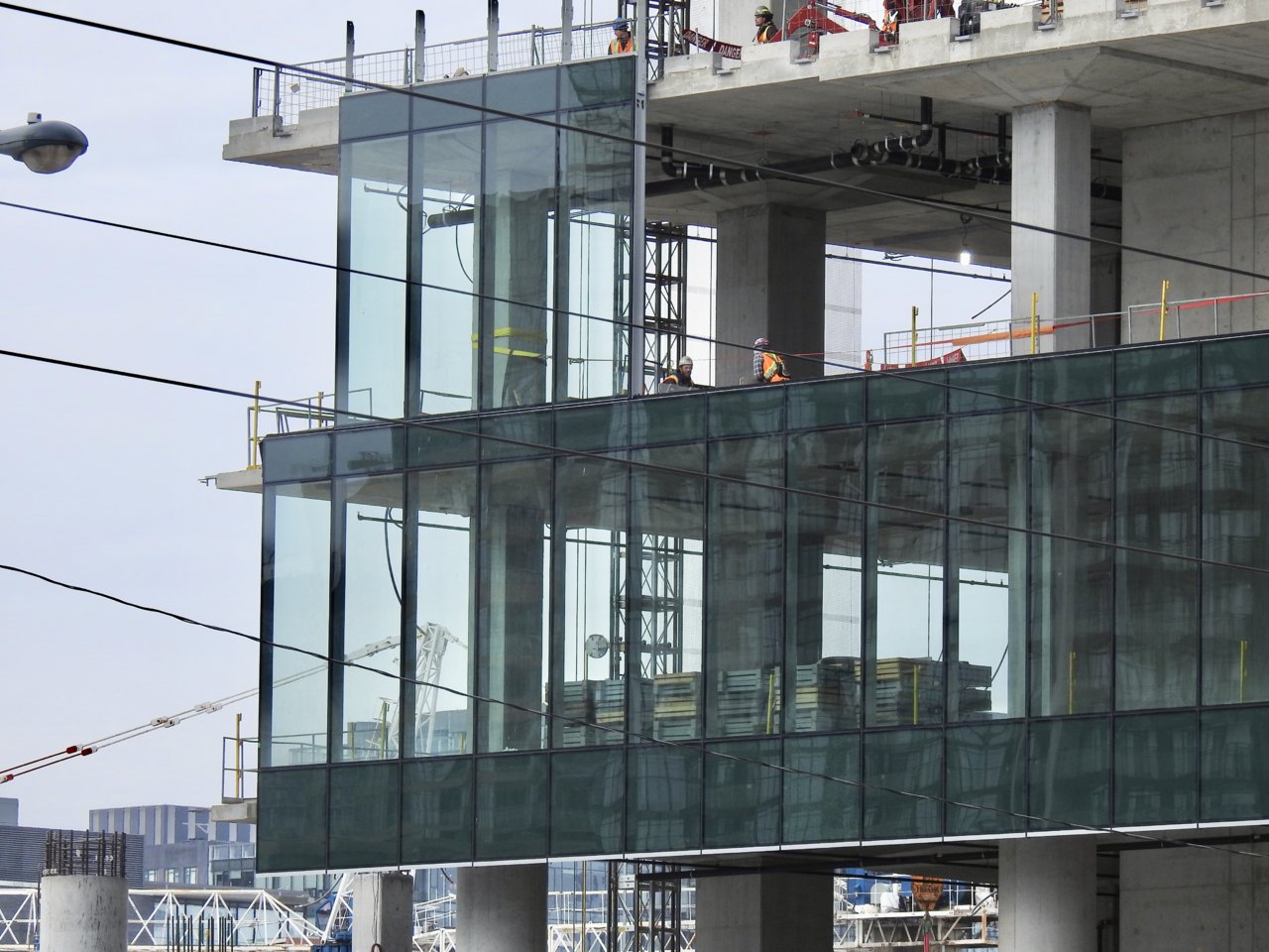

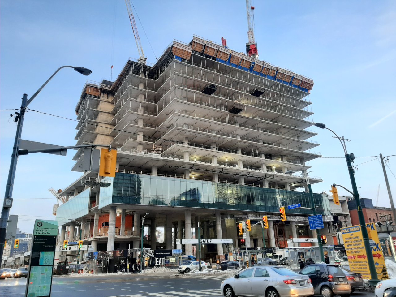

Comparison so far with the rendering of the office tower's podium:
Looks pretty accurate. I was cautious when only a few panels were on but with a larger surface now covered, I'm happy with this glazing.
Agreed, it does look fairly consistent so far. I'm curious to see how they execute the reddish material though.

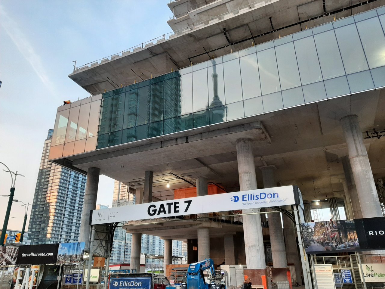

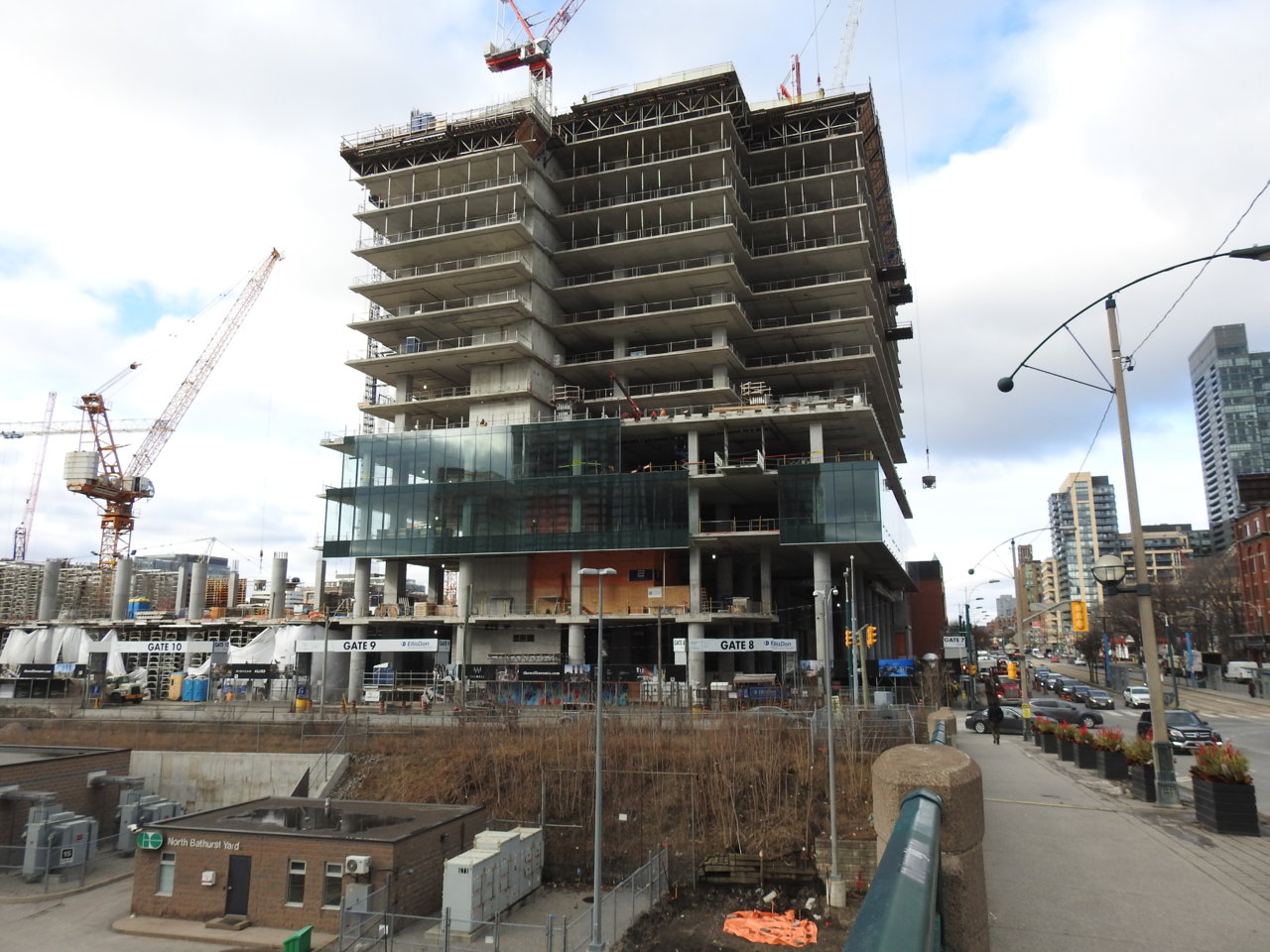

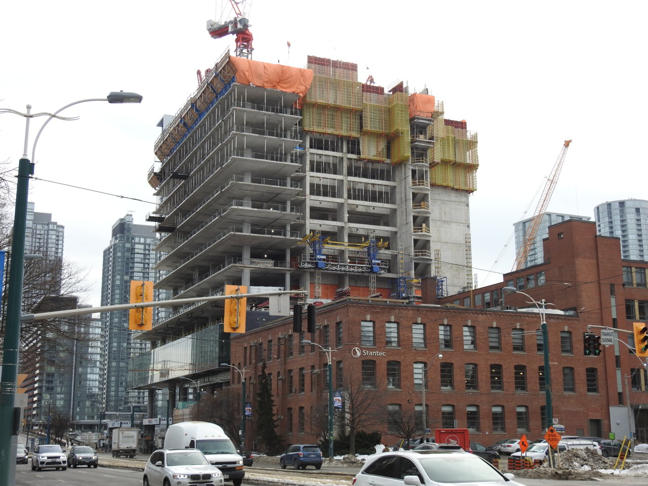

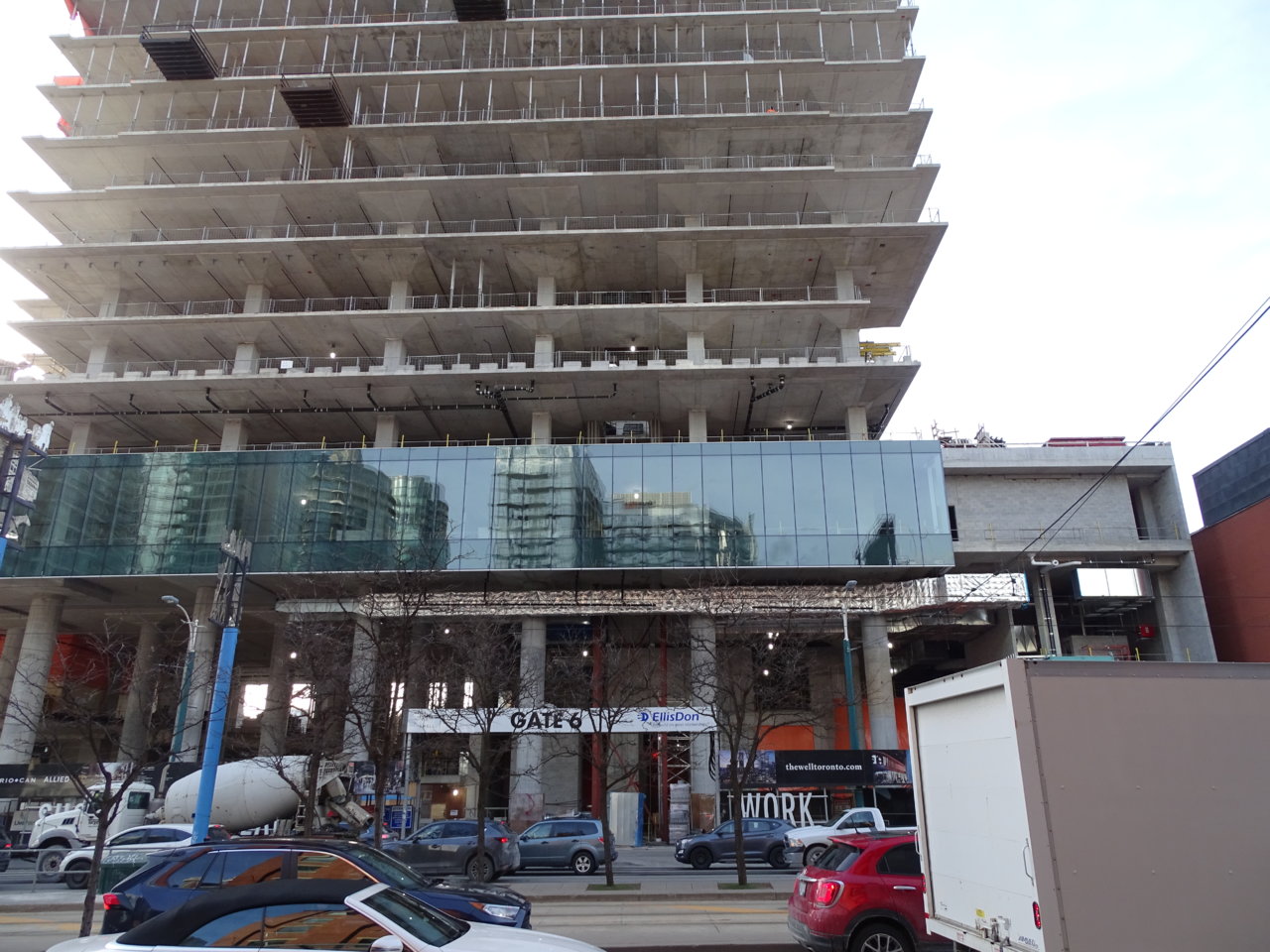

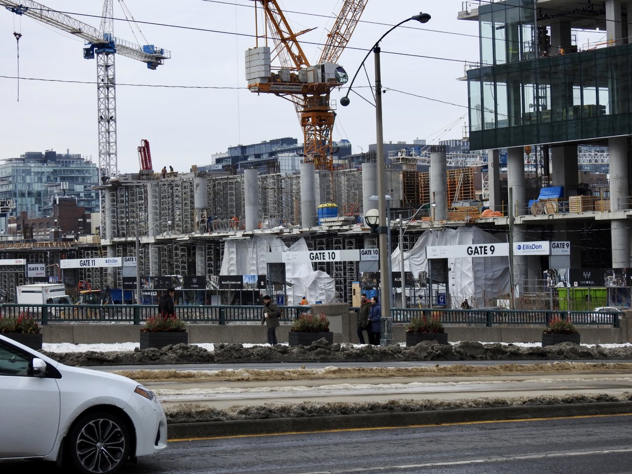

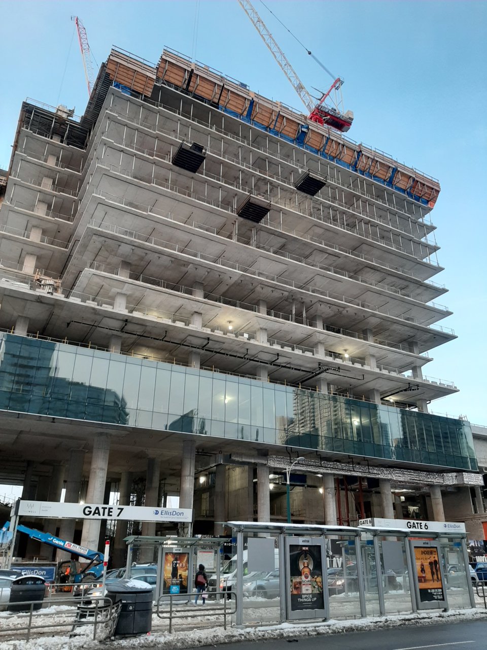

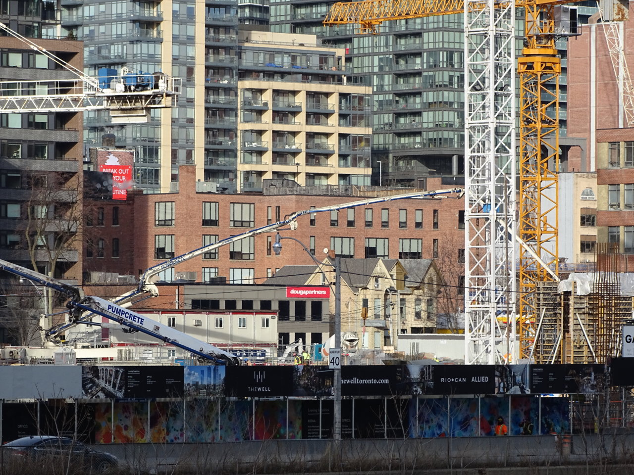

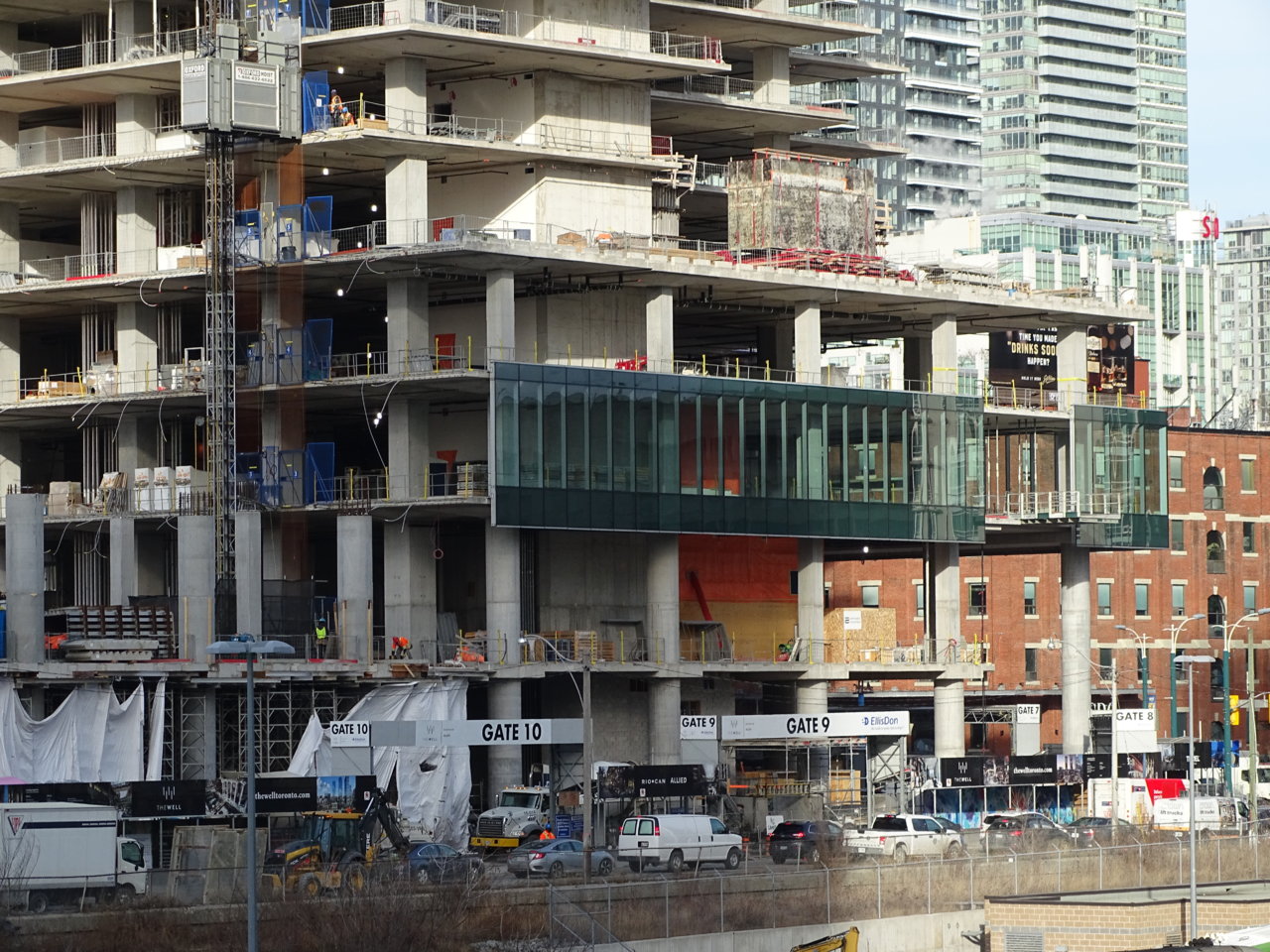

Well that's new. I get wanting to building The Well branding in the neighbourhood but this is usually done with posters on the hoarding, not adding the final signage when the building is still under construction and in fact far from completion.
I suppose in most cases the largest tenant usually has their branding at the top of the building (which comes last) but in this case the overall project has had an official name for quite a while and it's a good chance to get said namesake out there in a higher quality than most.

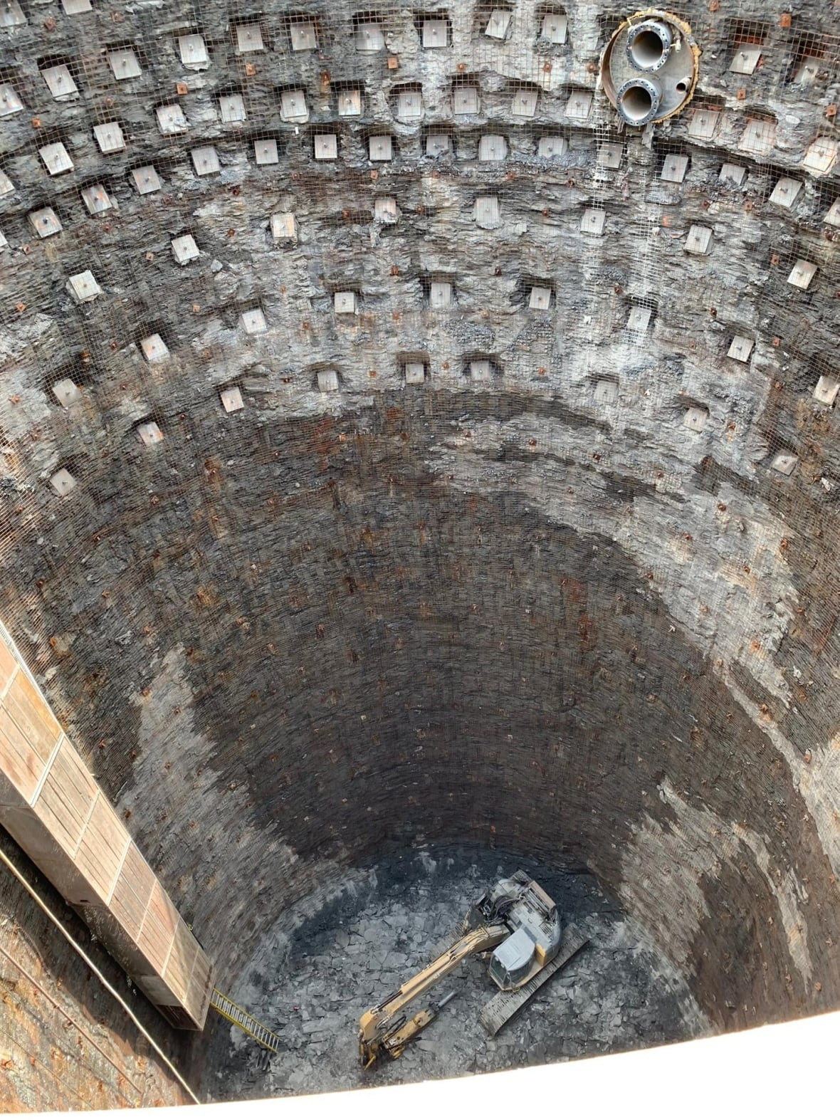

The project's name has a double meaning, as its northern access is onto Wellington Street. But at the core of the project is the well itself, a multimillion-litre underground hole that extends into the bedrock from below the lowest parking level to a few metres above sea level.
The solution stored in the well — it is not just water — will act as a giant thermal battery, said Gemming, cold in the summer for air conditioning and hot in the winter for heating.
