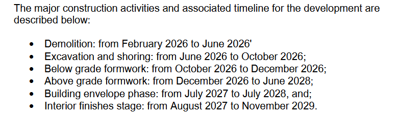

Construction Staging Report to the next meeting of TEYCC will give us a sense of the timeline here:
From the above:
The existing (newly improved) bike lane on Peter is impacted, but the intent is to retain it during construction, in painted form on this site, shifted to the east.
From the above:

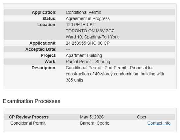

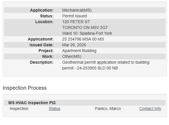

They already have their permit for the geothermal.
And, their shoring permit is nearly granted. I'm sure it'll be finalized by the time the geothermal work is done.
The rest will come later.
