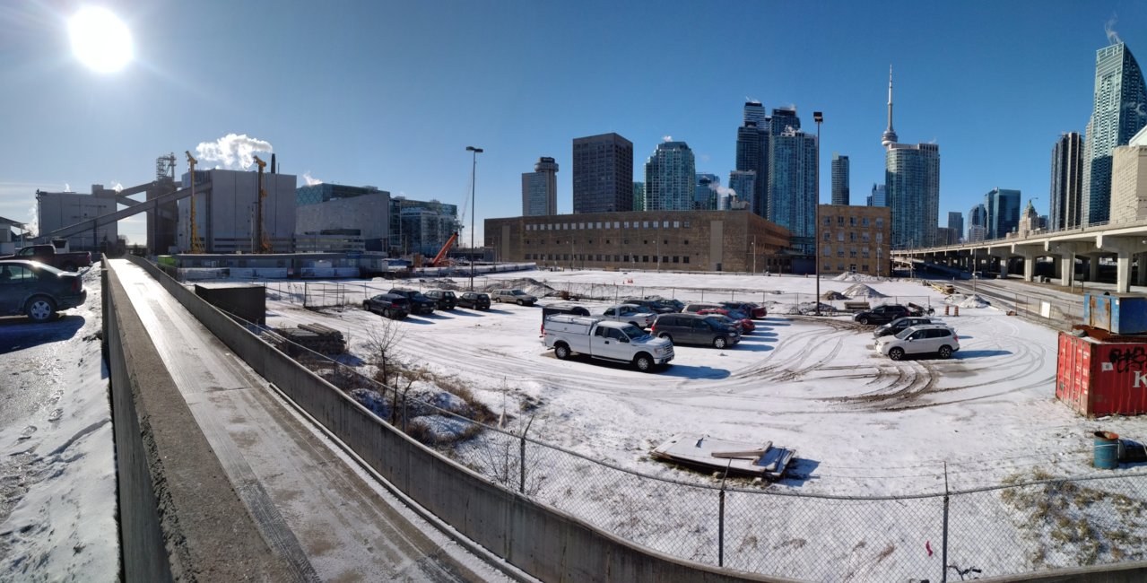

I don't mind the design here, it's just you know, nothing special. If only they could use a cool color instead of the typical blue/green glass. Why not gold, bronze, auburn tinted glass?
