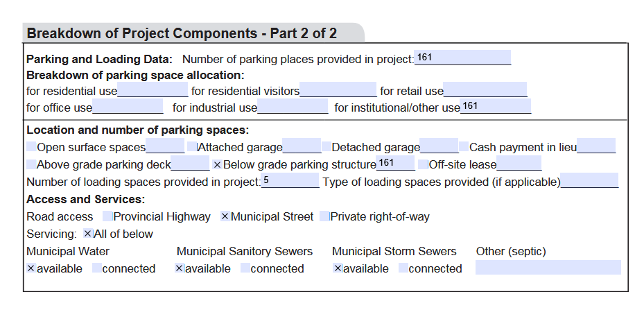

So hold on just a moment................I've already made my opinion clear on this proposal....but the Project Data Sheet gives me yet another concern....
161 parking spaces for a shelter and an LTC in the heart of downtown? What? Is money growing on trees?
