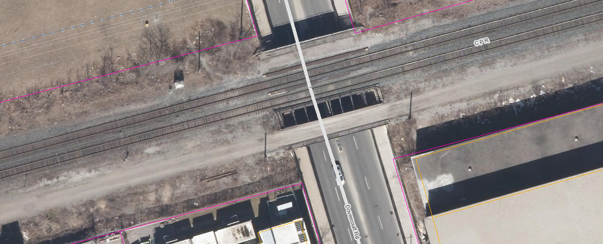

This is an overhead image of the corridor at Dovercourt, and you can see the space available in the ROW:
Obiviously, new track woudl be required and some new rail bridges as well, but no property acquisition.

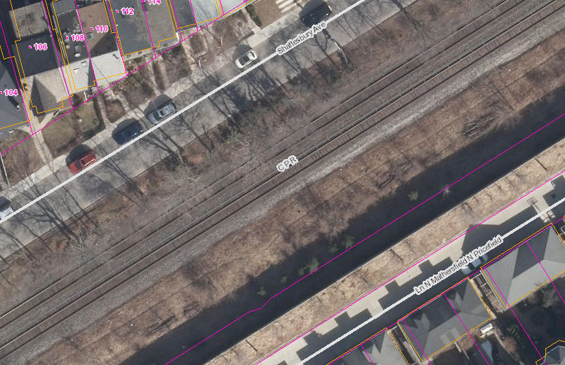

Below is a section just east of Yonge, which might require an embankment widening (though the ROW is large enough).

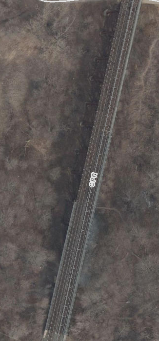

Hideously expensive though, would be quad-tracking the bridges (meaning a new bridge) over the West Don Valley:

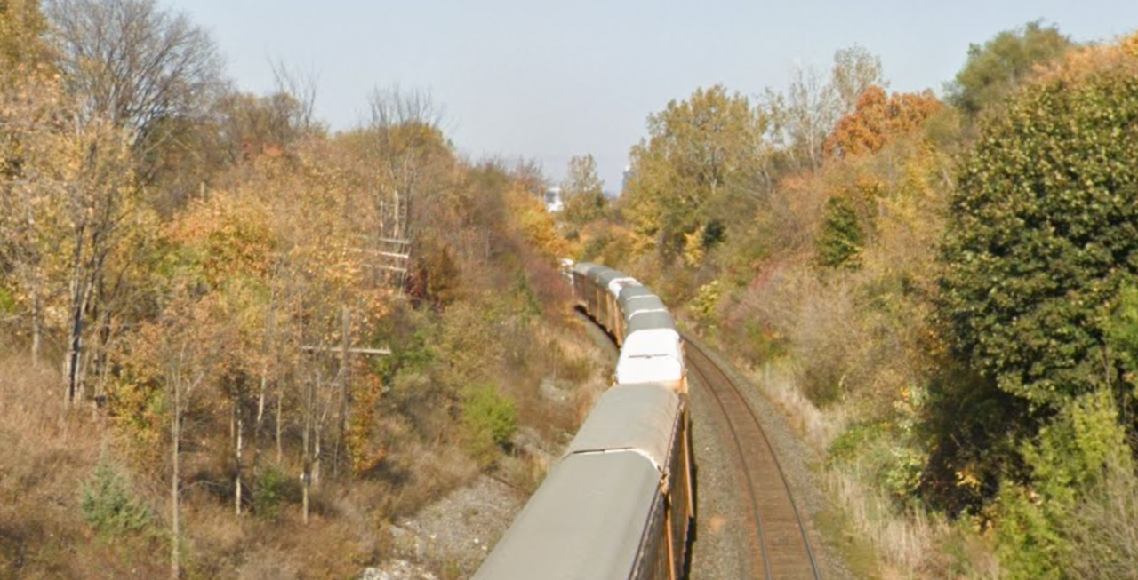

Is quad tracking the CN North Toronto Sub possible?
No and in most cases not even 4/6 tracks without rebuilding bridges and building retaining walls to get 4/6 tracks in. All you go to do is go to a few bridges in the east and look at CN corridor. If I remember correctly, Yonge St is a good example.
