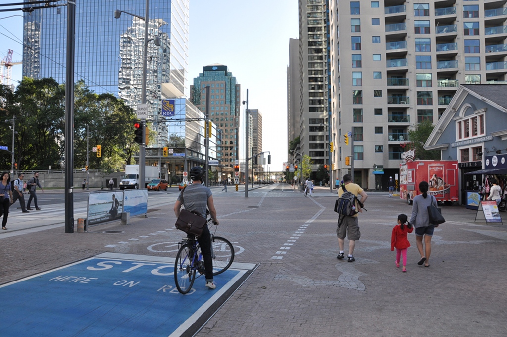

The pedestrian-bicycle conflict zones are not intuitively designed, which results in people having different expectations of other users than those users have for themselves, and vice versa. THAT is what causes near-misses, frustration and anger.
I've posted this before, and I'll post it again (original post here). We need to define right of way in terms of the ordinary rules of the road rather than making up some new rules of the road for Queens Quay that (surprise, surprise) people don't even understand, let alone obey. Heck, we've even had arguments on this very forum about some of the meanings. If a group of interested people such as us don't even agree on expected behaviour, then there's little hope for the average person.
"Cyclists yield and obey signals"
That's two contradictory messages! Traffic signals themselves are supposed to assign priority - green means you can proceed with the right of way and red means someone else has the right of way (a bit oversimplified, but that's how the average person sees it). Put simply, green means go. It doesn't mean "go, maybe, if the way is clear, possibly", that's what flashing yellow is for. All road users tend to get upset when something gets between them and a green light, whether they're driving, cycling or walking. So it's no surprise when cyclists get mad at pedestrians who unintentionally obstruct the bicycle path. The real translation of this sign is "the bike path is not clearly delineated in the places pedestrians tend to cross, so you'll probably encounter people wandering across your path inadvertently and we'd like to blame you if something bad happens as a result".
Unsignalized Crossings
The unsignalized pedestrian crossings at Spadina are a classic example of the lack of clarity in this design. There are big blue boxes with "watch for pedestrians" in advance of one conflict area in each direction (but not both):
Image taken before "WATCH FOR PEDESTRIANS" was added
In the initial (intended) design, there wasn't any text in the box - just these blue squares. There are a lot of shapes and symbols in the road marking vocabulary, but a big blue square is not one of them. Not here, and not in any of the countries Queens Quay visitors might be from. Any of the following would on the other hand have been appropriate: zebra crossing, ladder crossing or simple line crossing (priority crosswalk styles), shark's teeth (yield line), upstream "X" (pedestrian/railway crossover ahead), advanced yield symbols, etc.
But hey, why use road markings people have seen before when we could make up our own system and get mad at people who don't get it. Surely people on Queens Quay are there to learn a completely new system of traffic markings. It's not like they are using it to enjoy the waterfront or actually go somewhere. </sarcasm>
Since people clearly had no idea what the blue boxes where supposed to mean (shocker!), Waterfront later added the text "Watch for Pedestrians". Even if on-road text right at a conflict point were practical way of conveying information, what does that even mean? If you do spot a pedestrian, then what? "Watch for _" is typically what you'd see on roads where there is some kind of potential hazard that you might have to avoid, but in general you can proceed unless you think a collision is imminent. Common examples are where some hazard may suddenly appear on the road, such as pedestrians, deer, moose, falling rocks, and my personal favourite: trees.
Seen on Autoroute 20 in Québec
Add in the elephant's feet markings along the path, and all indications seem to suggest that pedestrians need to wait for a gap in bicycle traffic, right? Wrong! Because those were just the indications visible to cyclists. The clues visible to pedestrians indicate the exact opposite! The paving materials in the conflict zone are continuous with the sidewalk on either side, not the bicycle path. That's a very strong subconscious indicator of right of way. Also visible to pedestrians (but not as much to cyclists), there is a large stop bar on the bicycle path on one side (but not both!) of each crossing point. Pedestrians could logically assume that cyclists are expected to come to a stop. But in fact those stop bars are completely meaningless because they are not paired with a traffic control device which would require anyone to stop there, namely a traffic signal or a stop sign. And besides, with only one stop bar are cyclists expected to stop at one and wait for a gap at both crosswalks? Who knows!
To allow people to get along, traffic markings need to unanimously indicate a single priority regime. Not half indicating one way and half indicating the other. That's not "shared space", that's just bad design.
My vote is that pedestrians get priority at unsignalized crossings, because there isn't enough room for many pedestrians to wait for a gap in bicycle traffic after having crossed the road.
Stop lines
At signalized locations stop lines are indeed warranted, but on Queens Quay they are often poorly placed and always poorly designed. They cover the entire width of the bike path, which makes no sense, since the left half is for oncoming traffic. This bizarre (aesthetic?) decision means that the stop lines on Queens Quay are unrecognizeable as stopbars, which resulted in basically no one obeying them. The words "STOP HERE ON RED" have since been added to the bizarre blue boxes at signalized intersections, a classic example of applying a 'blame the users' bandaid, rather than addressing the cause of the problem, which is that the road markings are nonsensical.
But to make matters worse, there are locations where the stop bars are illogically placed, which results in some people disregarding them even if they recognize their intent.
At most intersections, the stop bars are set back about 5 metres from the road crossing, to leave enough room for pedestrians to cross in front while bikes wait at red lights. This makes good sense given the heavy volume of both pedestrian and bicycle traffic. But there aren't pedestrian crossings at all signals. At Spadina Loop (just east of Spadina) and Robertson East (just east of Rees), there are no pedestrian crossings yet the stop bars are still set back as if there were. The same is also true at Fire/EMS on the east side:
This is a case of road markings "crying wolf". There is no reason for people to stop where indicated rather than rolling up to the actual conflict point like they would naturally tend to do. People may notice that they're pointlessly stopping far back and learn to disregard the stop bars - even though there are some locations where the setback is actually warranted.
But these 5-metre examples are nothing compared to eastbound at York Street where the stop bar is set back a whopping 21 metres from the edge of the road crossing.
I am genuinely surprised that anyone ever obeys such an absurd stop bar location
The only conflict in that distance is with the pedestrians inadvertently wandering all over the poorly-marked path. Meanwhile, the signal timings conveniently ignore this ridiculous crossing - for the crossing distance of 47 metres, a 20 km/h road would need a 9-second all-way red clearance interval. But in fact it's only 4 seconds. Without the required all-way clearance time it's actually physically impossible to obey the stop bar, because you could pass it legally and still not get to the vehicle crossing before cars start occupying it.
Obviously a 9-second all-red clearance is absolutely ridiculous and would just create mass confusion. Instead, the stop bar should be moved to where people would naturally expect it: right next to the road crossing. The pedestrian crossing is so far away that it can be dealt with as an independent unsignalized crossing like I suggested above for Spadina.
Paving Materials
I could go on about the paving materials, but at this point my post is so long that I've probably lost all readers anyway. I'll just settle for a picture:
How is that supposed to make sense?
Let's be clear. Cyclists who run a red aren't doing it because signage is confusing. They view rules as optional. You see cyclist after cyclist look around as they approach a red, then proceed anyway. They know they have to stop but go anyway.
Yes, there are places where a yield sign should exist versus a red light but that doesn't mean that people are free to break the law. That's a separate debate. I agree with your call for better design but no matter how much signage we change, cyclists are going to ignore it. If nobody is following the rules, there are going to be accidents. And I see them happening every day. It's the culture that must be changed, and the only way to get cyclists to start obeying the rules is to make it clear that those rules will be enforced.
Yep, that's about right. No cyclists follow the rules, and no cyclists will ever follow the rules. So no point in addressing the countless nonsensical design elements that contribute to a mentality of disregarding signage and markings.
</sarcasm>
Let's be clear. I'm not saying that everyone should break whatever laws they like whenever they like. I'm saying that there are clear changes we can make which will reduce law-breaking behaviour. Because as satisfying as it is to punish law-breakers, it's more beneficial to society if we reduce the rate of law-breaking in the first place. And design is far more effective at doing that than enforcement.
And because you're probably going to misinterpret the last sentence, I'll spell it out for you:
Design is more effective than law enforcement. This does NOT mean "Let's not bother with law enforcement". It means that first priority should be making an intuitive design, with law-enforcement as a stopgap measure.

What does not stopping at points of crossing have to do with intuitive design? Sure there are places where the issue is design related and can be rectified, but at the end of the day, it is but one driver of behaviour.
[...]Let's be clear. I'm not saying that everyone should break whatever laws they like whenever they like. I'm saying that there are clear changes we can make which will reduce law-breaking behaviour. Because as satisfying as it is to punish law-breakers, it's more beneficial to society if we reduce the rate of law-breaking in the first place. And design is far more effective at doing that than enforcement.[...]
I agree with this completely. One of the reasons many cyclists (just as an example, I am not picking on cyclists) don't adhere to some rules of the road is because those rules, and the manner in which they were implemented on our streets, were developed without any regard to any road users other than motorists. It's more than just developing clear and concise traffic markings and road design which safely accommodates all users - it's even more basic than that.
For example, people complain that cyclists often do not respect one-way streets. While there are some one-way streets which cyclists should adhere too for safety's sake (Logan Avenue between Danforth and Riverdale comes to mind), most of them exist either to reduce automobile infiltration in neighbourhoods or to facilitate automobile traffic. Why should cyclists be bound by one-way streets whose existence has nothing to do with them and which unnecessarily complicate their commute? We'd likely have much greater compliance with one-ways by cyclists if the one-ways which applied to them made sense.
Similarly, pedestrians will usually jaywalk when streets are designed to corral pedestrians to cross at locations which are convenient for car traffic but have no regard for actual pedestrian patterns. There was a great set of tweets this past weekend by Sean Marshall about what a nightmare it is for a pedestrian to walk down Spadina to the waterfront, because it literally took him almost 9 minutes to legally cross the intersection of Spadina and Lake Shore (no motorist would put up with a 9-minute red signal waiting to get through an intersection). And then we wonder why pedestrians dash across the street, hoping not to get hit.
Queens Quay at least was designed with all users in mind (cars, transit, bikes, pedestrian), which in my mind is why we need the patience to get it right. Reaper, your suggestions and comments on the design of it were very interesting.
Yes, it is but one driver of behaviour, but it also happens to be the most significant. The more unreasonable rules and expectations there are, the more people will develop the mentality to take the rules with a grain of salt. There are a lot of good examples here - I personally identify with Skeezix's example of one-way streets which are such for traffic calming reasons, rather than traffic control. Living downtown, I would cycle south down Victoria Street until Wellington, even though it becomes one-way northbound for two blocks at King. Because even riding illegally down a quiet one-way street is still safer than the alternative, which is to cycle legally down Yonge Street.
This applies to all road users. I expect that this mentality is the same one that explains why average speeds on 400-series highways are routinely 15 km/h above the speed limit. The signs say "Maximum 100", not "Minimum 100". I was recently in New Brunswick, and I found that although their speed limits are generally higher than ours for a comparable road, people didn't actually drive any faster. In New Brunswick, when the speed limits drop to 30 for a school zone, people actually slow to 30. Ditto for an 80km/h construction zone on the highway. Because most of the time the speed limits are consistent with what people consider 'reasonable', they don't develop the mindset to take them with a grain of salt as we do here in Ontario.
So you're right that correcting these counter-intuitive designs will not single-handedly end all law-breaking behaviour. But each change we make toward a more reasonable road system will contribute toward attitudes of respect toward rules and regulations. As it stands, Queens Quay is one of the worst places for intuitive design, so it is critical to fix in order to restore road users' respect of traffic engineering.
