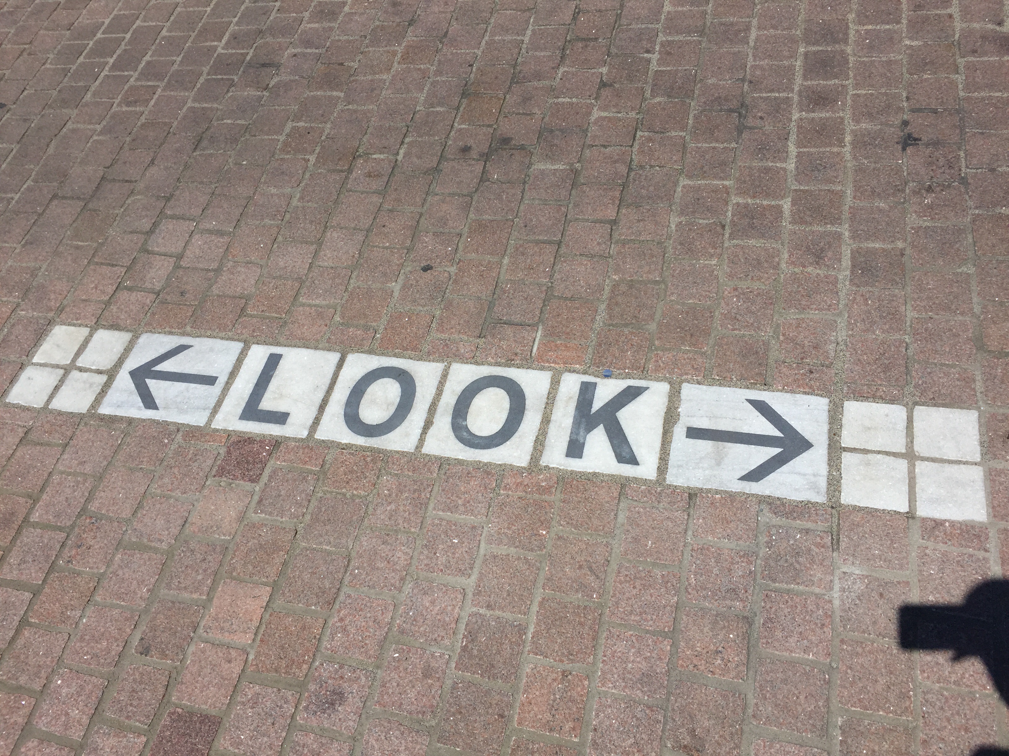

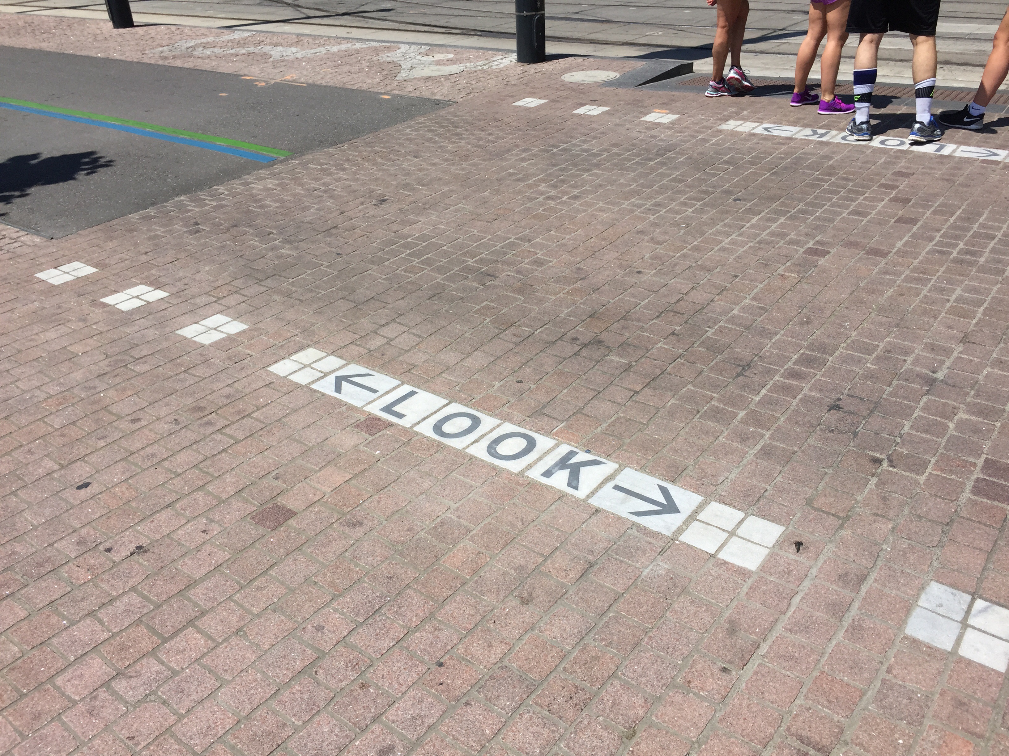

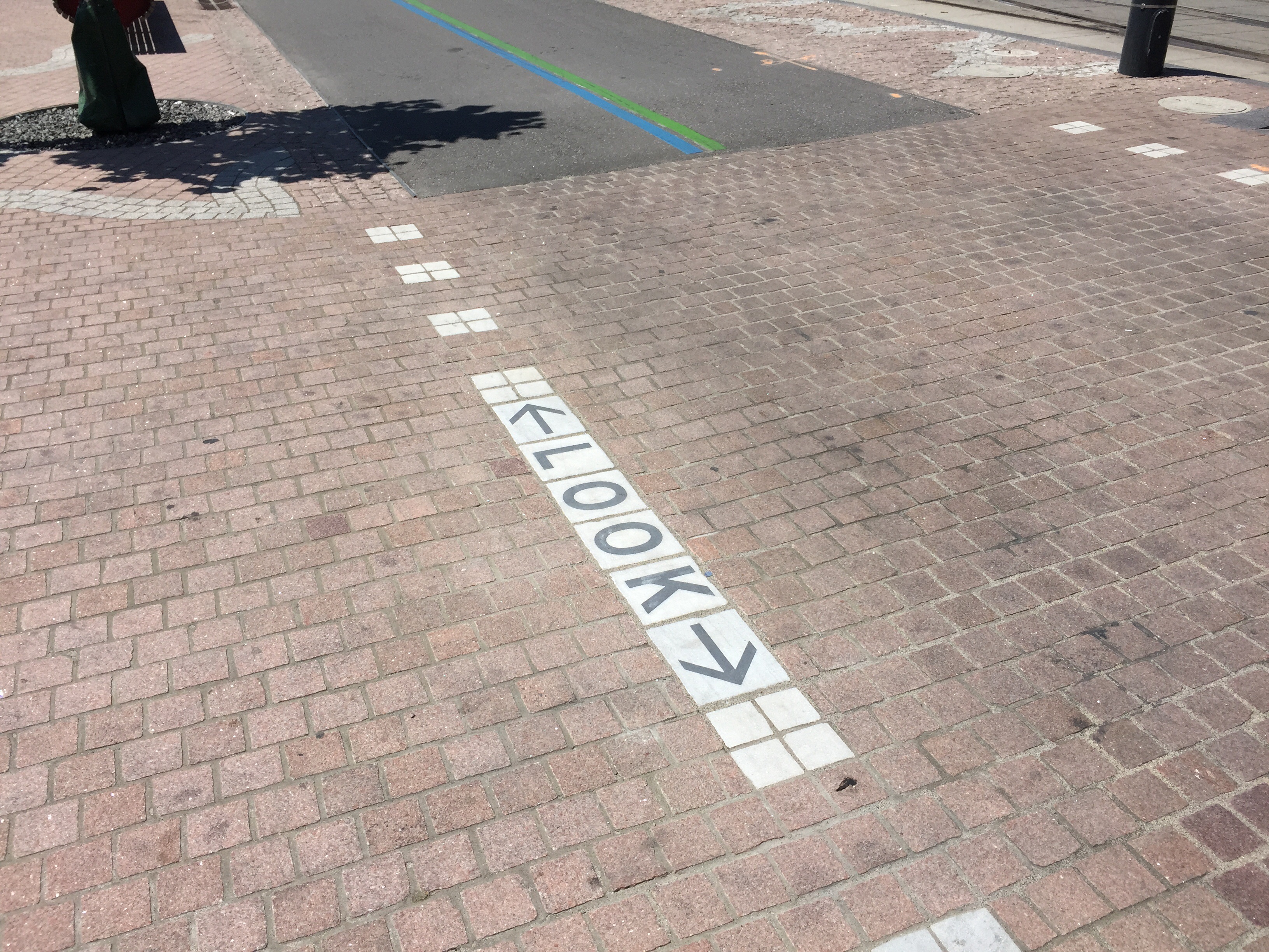

I don't think I've seen anyone post these yet. They replaced some of the small stone pavers with larger granite blocks etched with the word "Look" on them. Saw these at a bunch of intersections, along side both edges of the cycle path.
For me, the necessity of signage of almost any kind is often the most obvious indicator of a fundamentally flawed design. IMHO, if you're a designer and you're banking on people reading stuff (especially in heavily touristy areas) to understand how to use your space, you're displaying fairly extreme naivety.
Looks kinda Cyrillic if read upside down. Personally don't think this is enough, and we should place attractive fencing staggered intermittently between the sidewalk, cycle path, and streetcar tracks. It'd still be the same concept of an open space for all, and the fence could have openings every ~25m to pass through. But it'd do a much better job at preventing a collision imo.

I think what they should do in the mixing zones is ditch the garnet and put in asphalt to let pedestrians know to be careful in thath area. For example in Wrigley field just before the wall they have a strip of grass after the warning rack to let players know careful you are heading towards a brick wall.
Those are ugly as hell.
Well this is a signal that they at least recognize there's a problem. It's still too subtle. Think about the Chinese tour groups wandering aimlessly or the local teenager catching pokemon....these people aren't going to notice this. Reminds me a little bit of the "look right" signs in London at intersections. Those are actually useful because they stand out more.

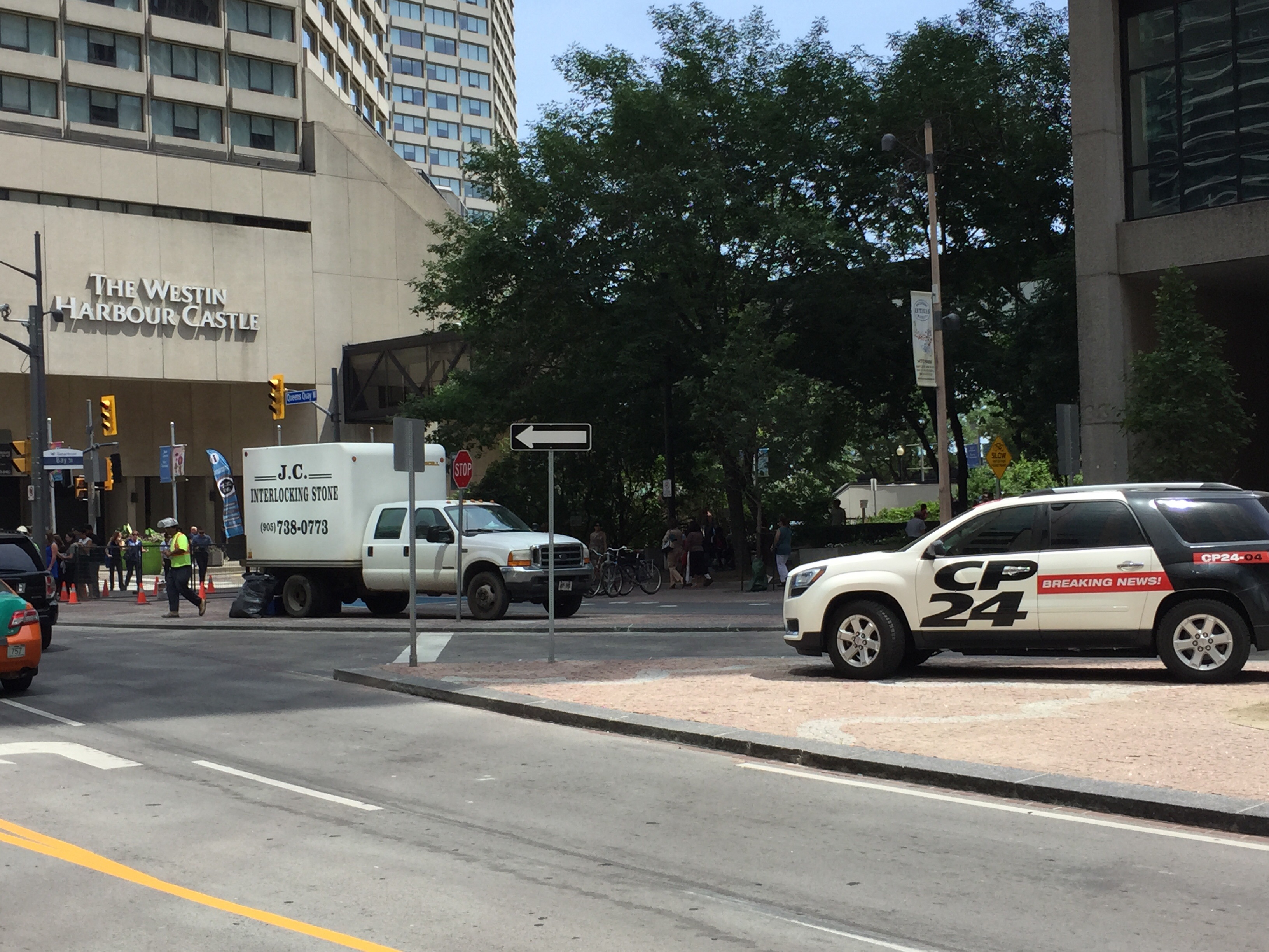

Walked past the Bay St intersection and this crew is installing more of the "Look" paving stones here
Wonder if this is breaking news on CP24 :) ha
