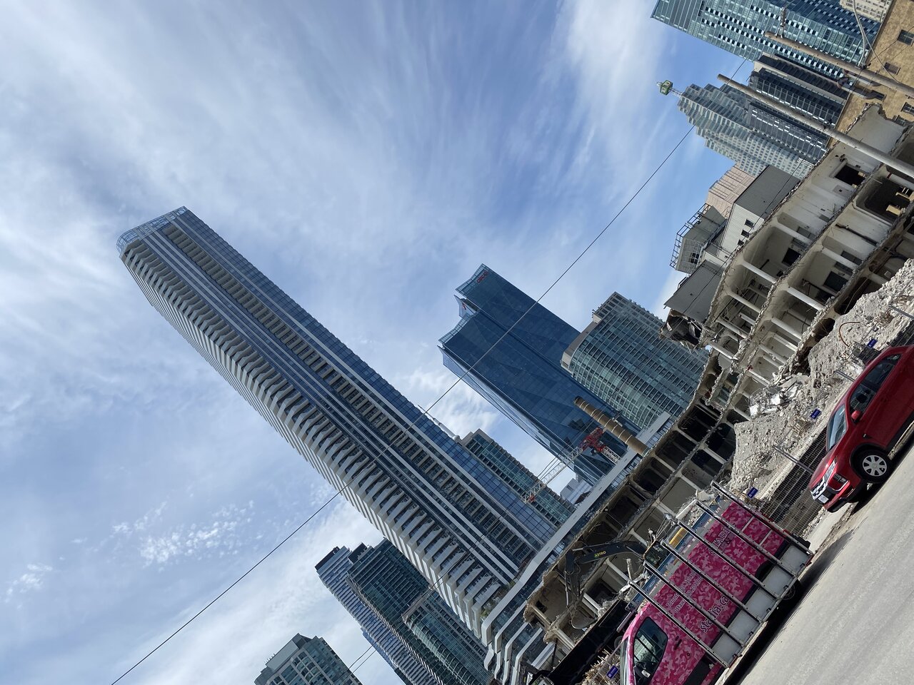

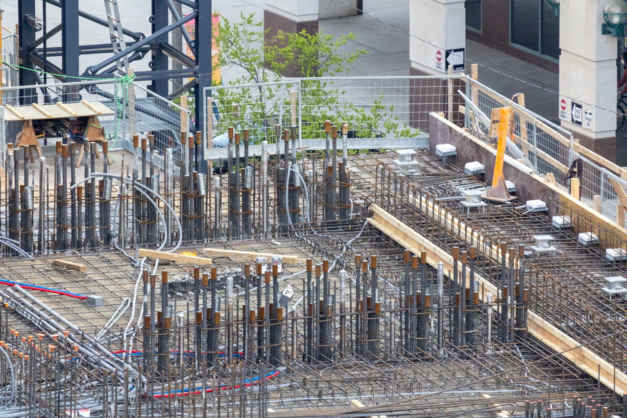

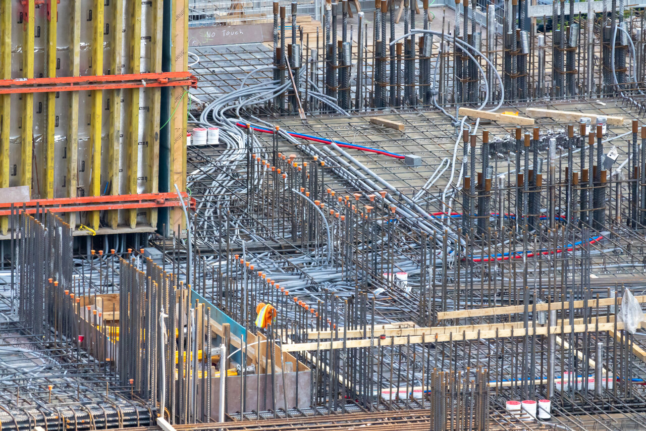

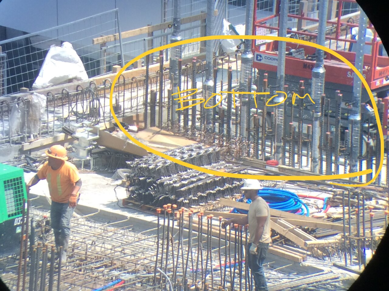

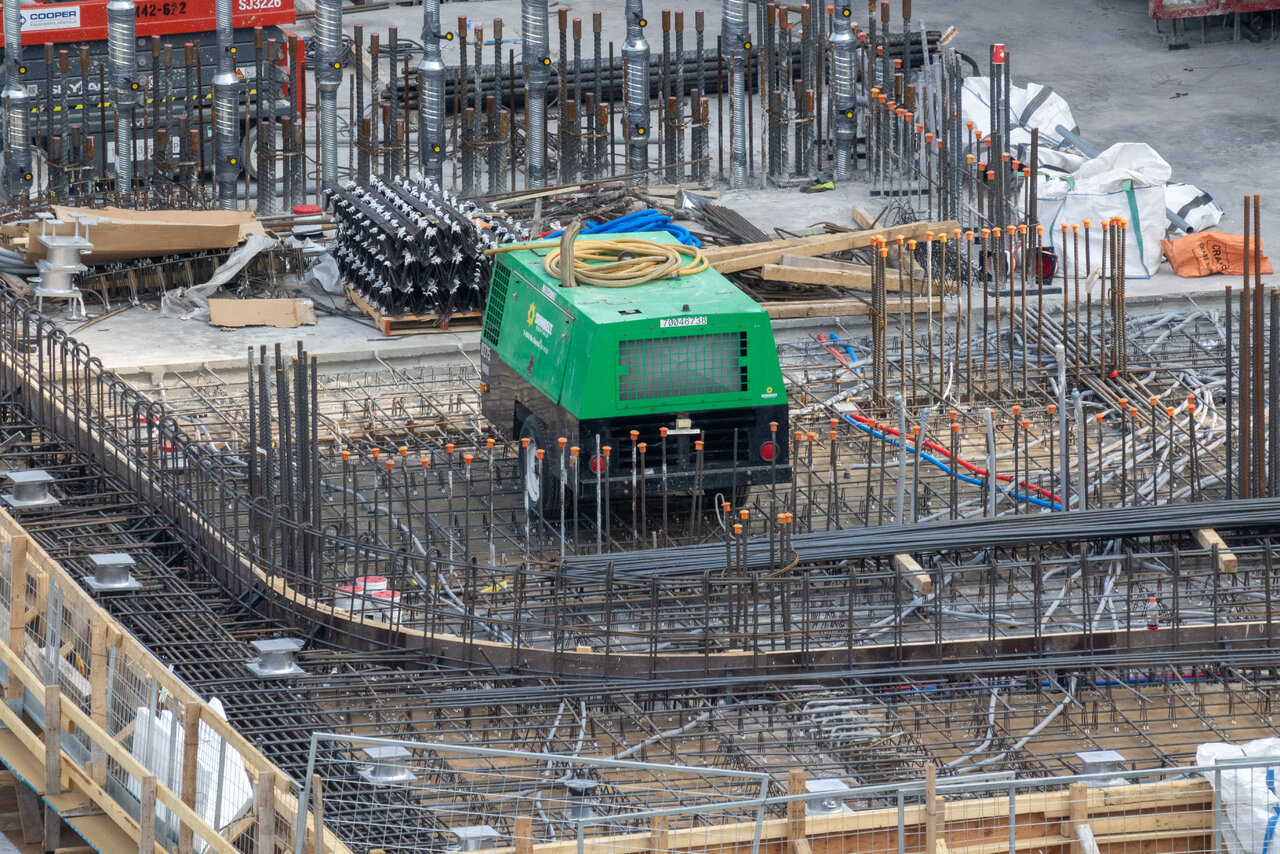

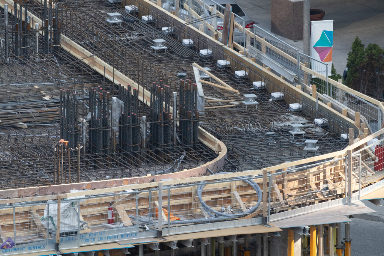

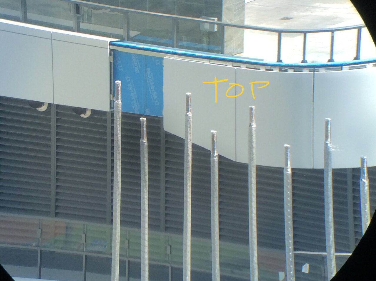

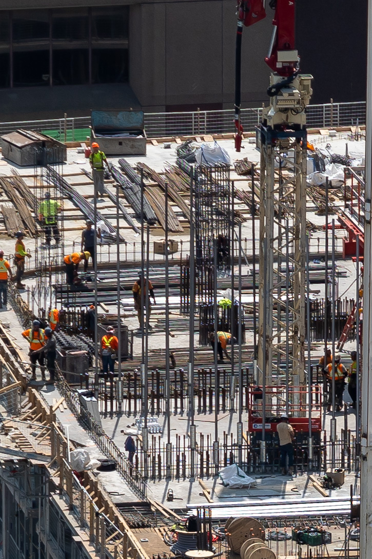

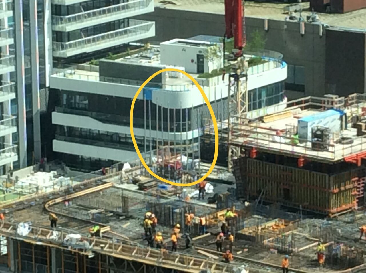

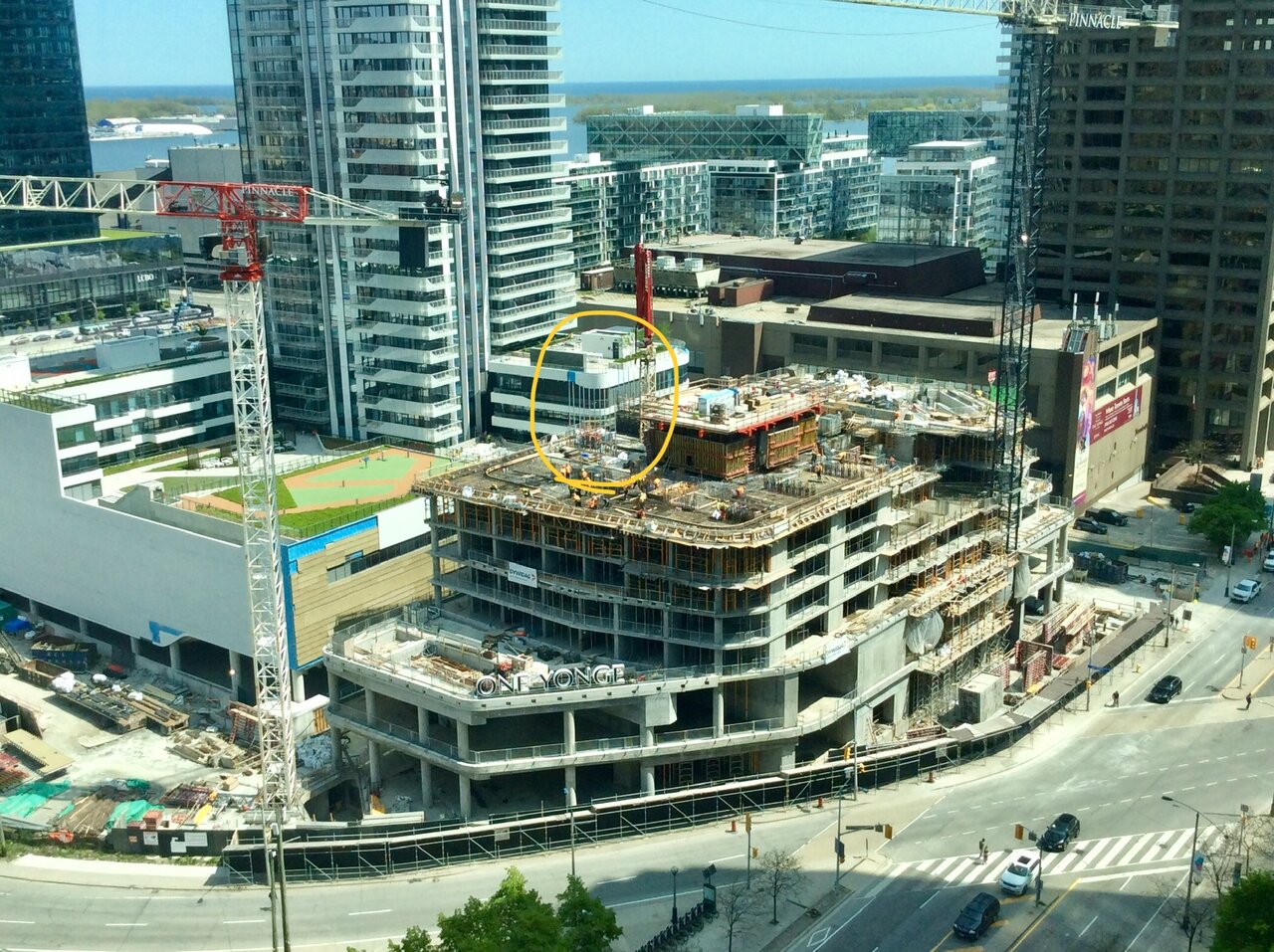

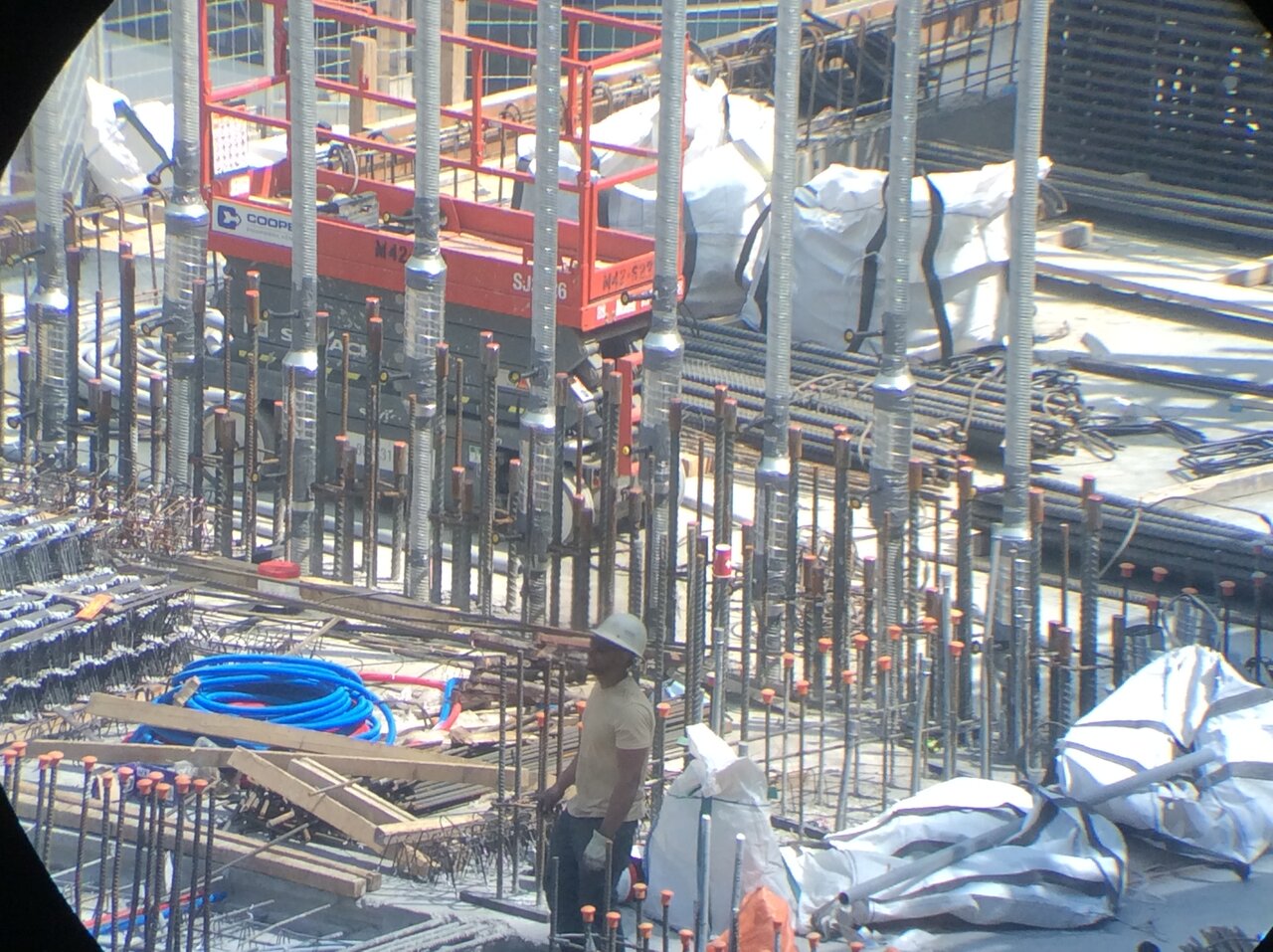

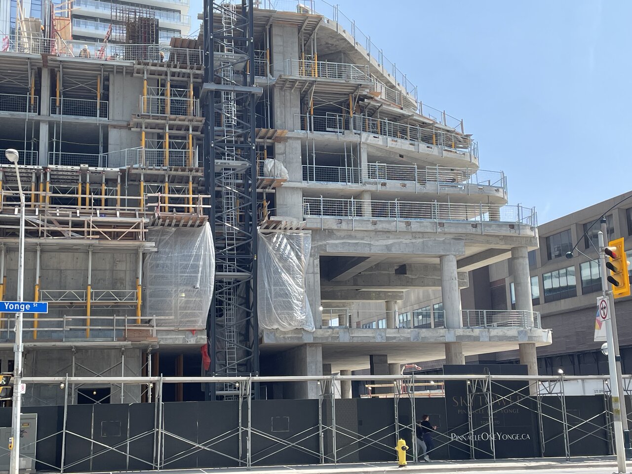

In the yellow bubble appears10 silver tubes/pipes/hoses, what are they? I thought they were part of the concrete pumping system but I see 10 more of them to the south and they’ve built rebar around them in a wall and they are staggered. Now I’m thinking they will pull cables through them and then prestress them in tension, does that make sense? Thoughts?

I think you’re right with the tension cables. Some on the other longer west side walls too.

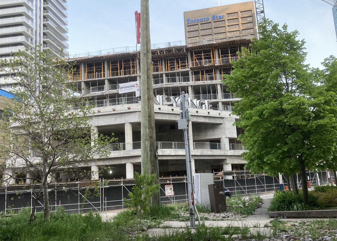

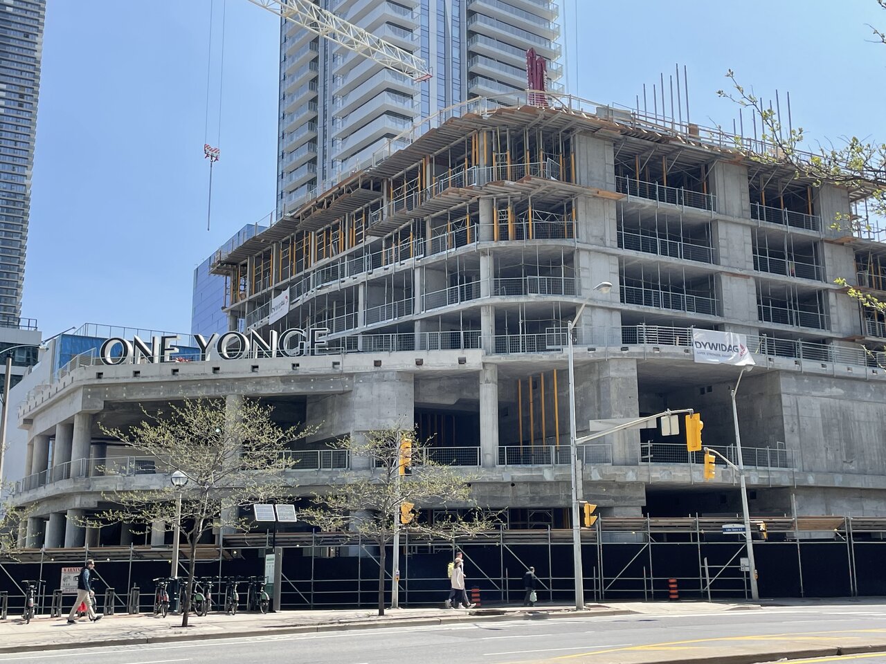

Pictures from May 8 & 10 and 14.

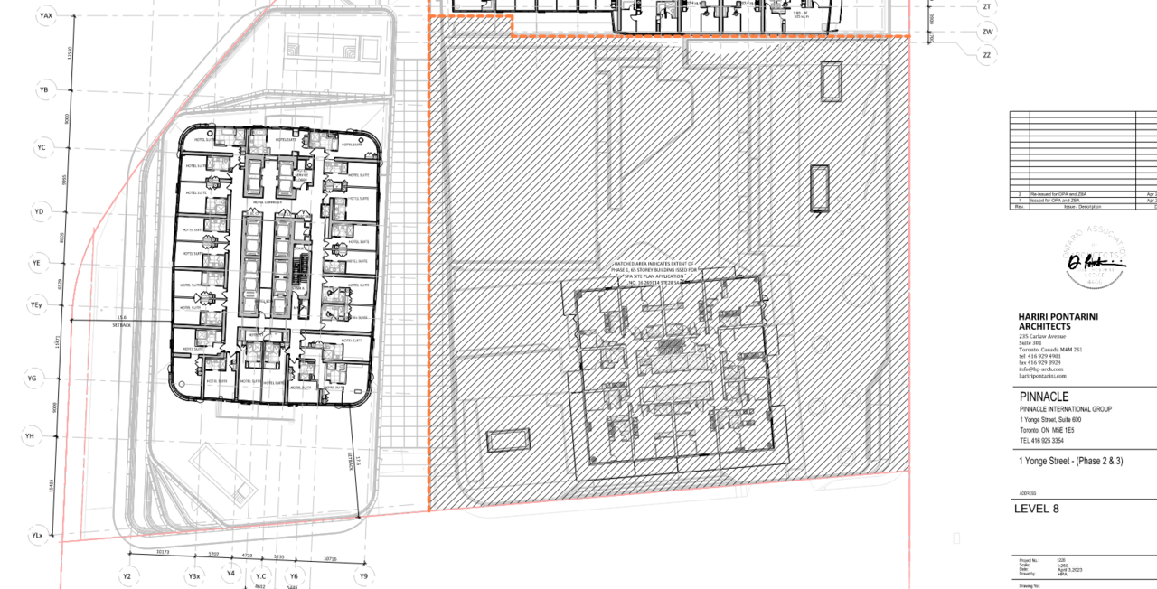

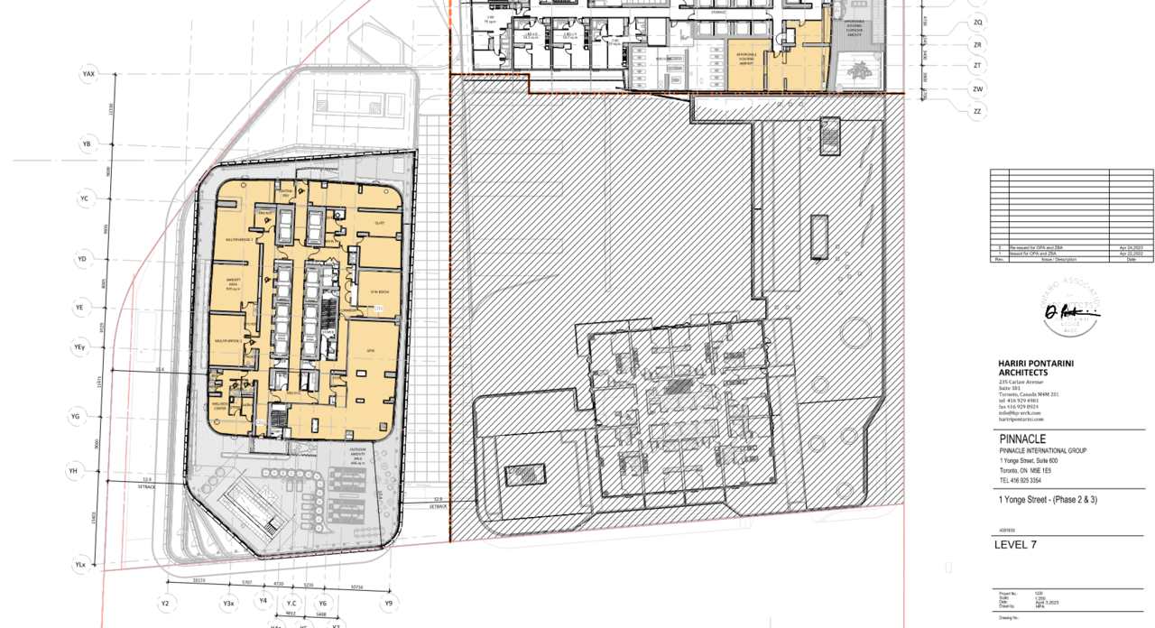

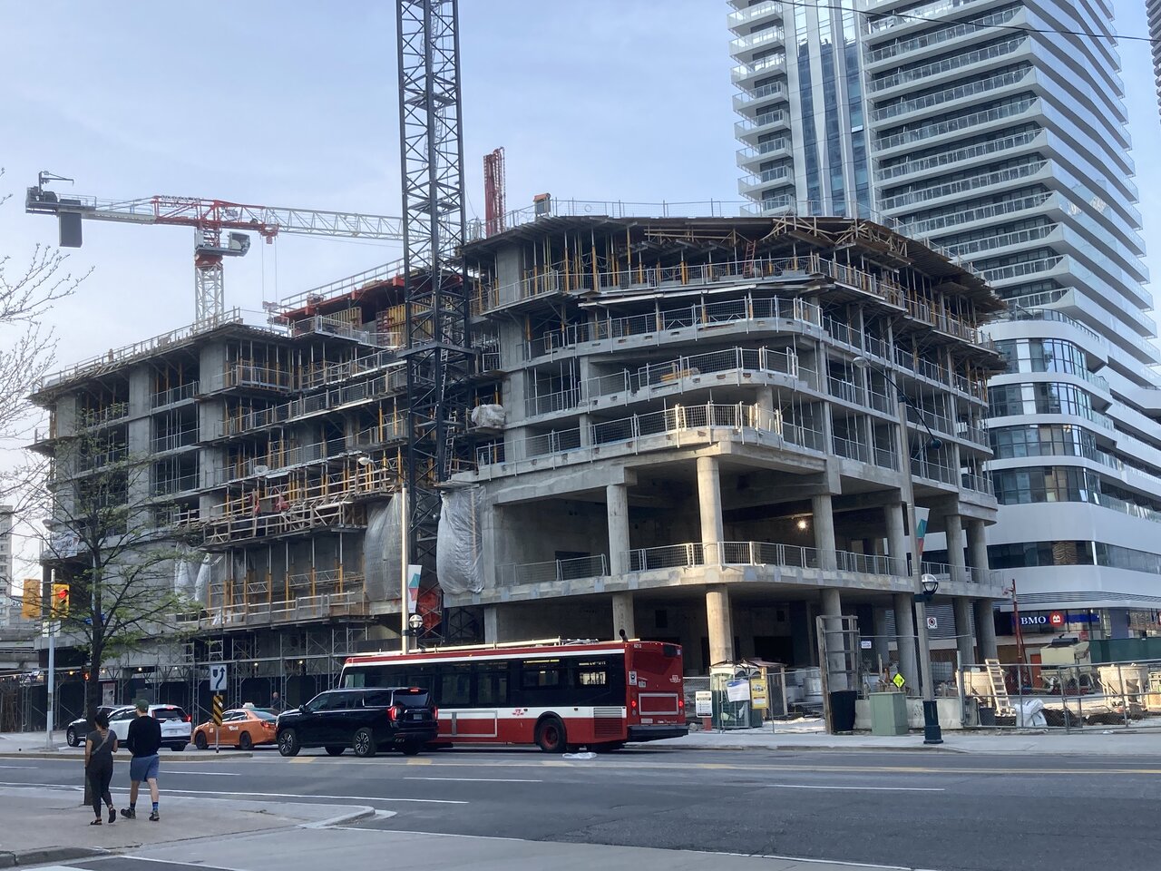

Not 100% sure if tensioners or not, but from the planning documents the 7th floor is the amenity level which is more open concept (image below) so the walls on this level have to support the change in layout from the hotel level above (8th & First Tower floor) which matches the one on level 6.

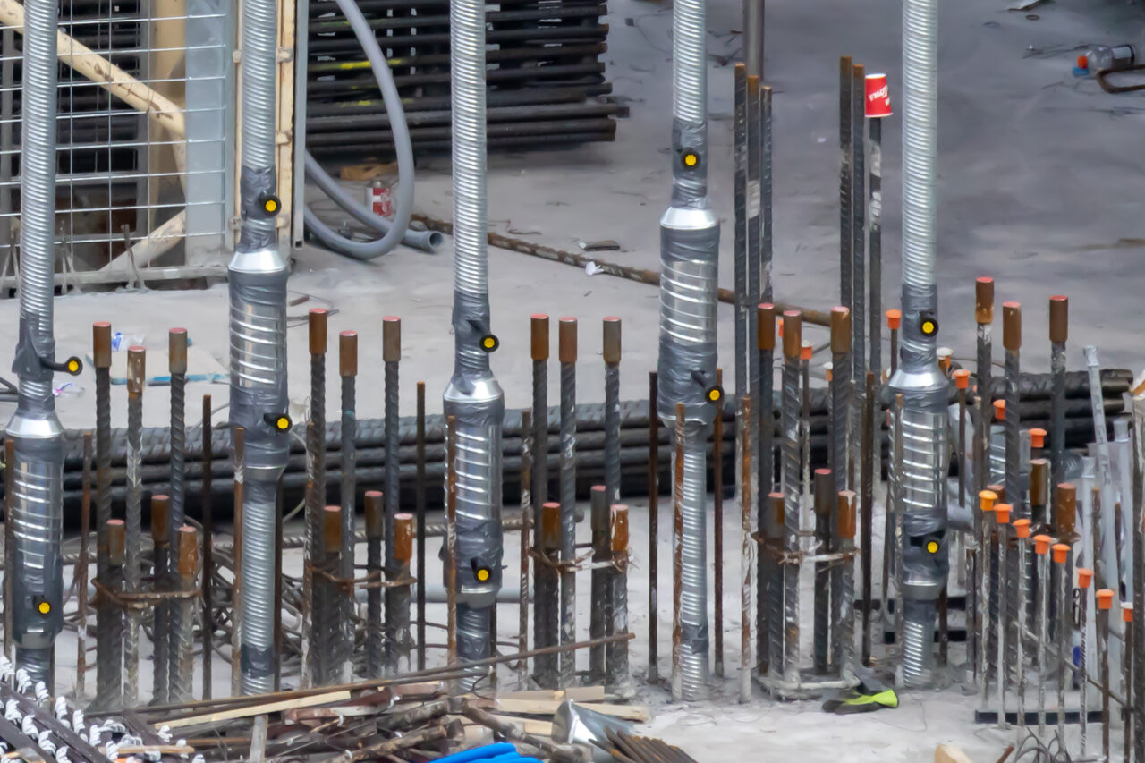

View attachment 477438View attachment 477439View attachment 477440View attachment 477441View attachment 477442
They are Dywidag threaded bars and sleeves that are part of the post-tension system that will help compress the building.
