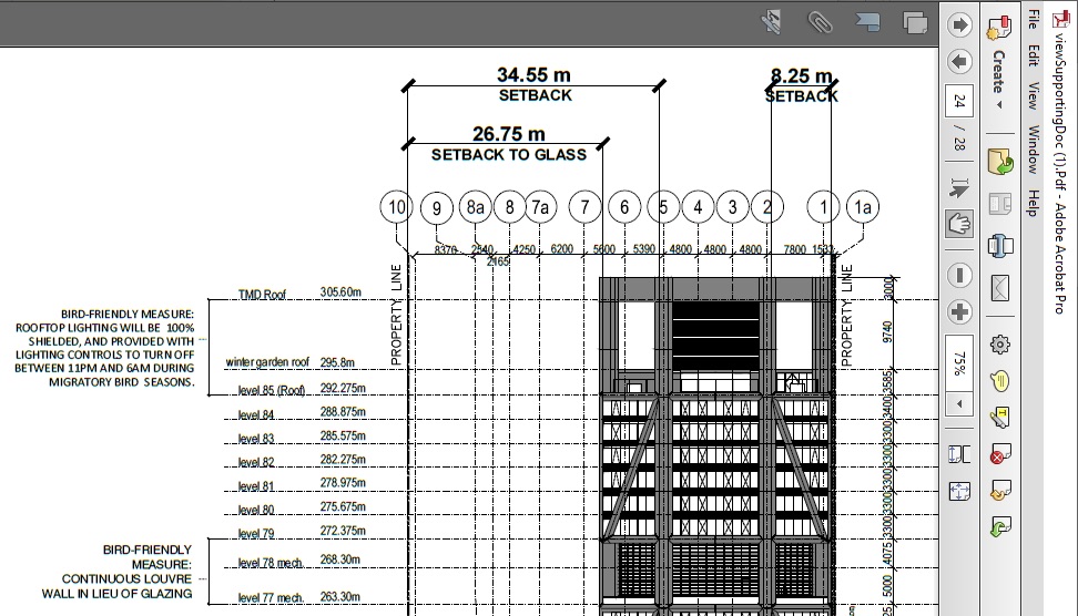

Here's the top of The One:
You'll notice on the left above that the "TMD Roof" (that stands for Tuned Mass Damper) is at 305.6 metres. On the right, you'll see another 3000 millimetres are to be added for the top of the super-column structure, so a total of 308.6 metres, or 1,012' 5 ⅝".

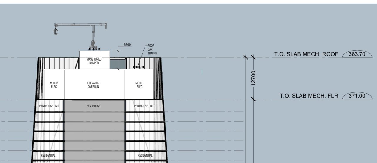

The top of Pinnacle One Yonge's Sky Tower appears on its Architectural Plans on the City's site as below.
That "Top of Slab Mech Roof" is 383.7 metres. That's above sea level. It shouldn't technically say Slab Mech Roof though, it should say Screen, which the actual mechanical roof slab sits below by a few metres. Anyway, take away ground level of 76.8 metres and you get 306.9 metres to the top of the screen. So, that's 1.7 metres shorter than The One.
Thing is though that there's a tuned mass damper on the roof of this tower too, and we we can see it's 5.5 metres high, but we don't know exactly how far it sits above the screen… but using a ruler to compare heights on this not-legal-document, it appears that 2 metres of the TMD's 5.5 metre height are sticking out above the screen. That would make the height 308.9 metres, or basically 1 foot taller than The One.

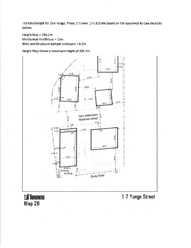

However, when I approached Pinnacle's PR people about their claim today, they said that this tower is 313.4 metres tall. I have asked for documents to back up that claim. We shall see what we get, and I'll wait to make a change to the database file and the thread title until they've gotten back to us.
