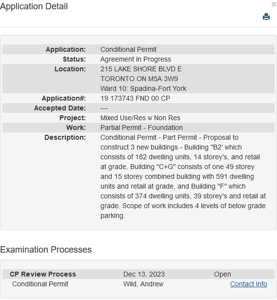

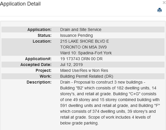

On what basis do you draw this conclusion?
I don't see any evidence of a shoring permit.
A shoring permit would typically end SHO
Shoring permits are often conditional or partial.
I examined each permit above, none have been issued, including 'drain and site service' which would generally pre-date any shoring permit in the process.
I have talked to the City Engineer in charge of this project several times. What I have stated is true.
For clarity, I didn't suggest you were being deceptive. Simply that the evidence on the City's site doesn't corroborate your position.
I appreciate your sharing of information, by the way; so thank you. That said, the way this is being handled is anomalous to my experience.

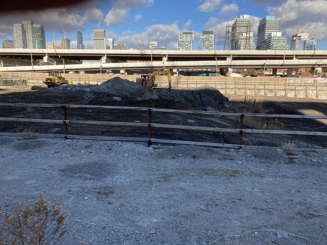

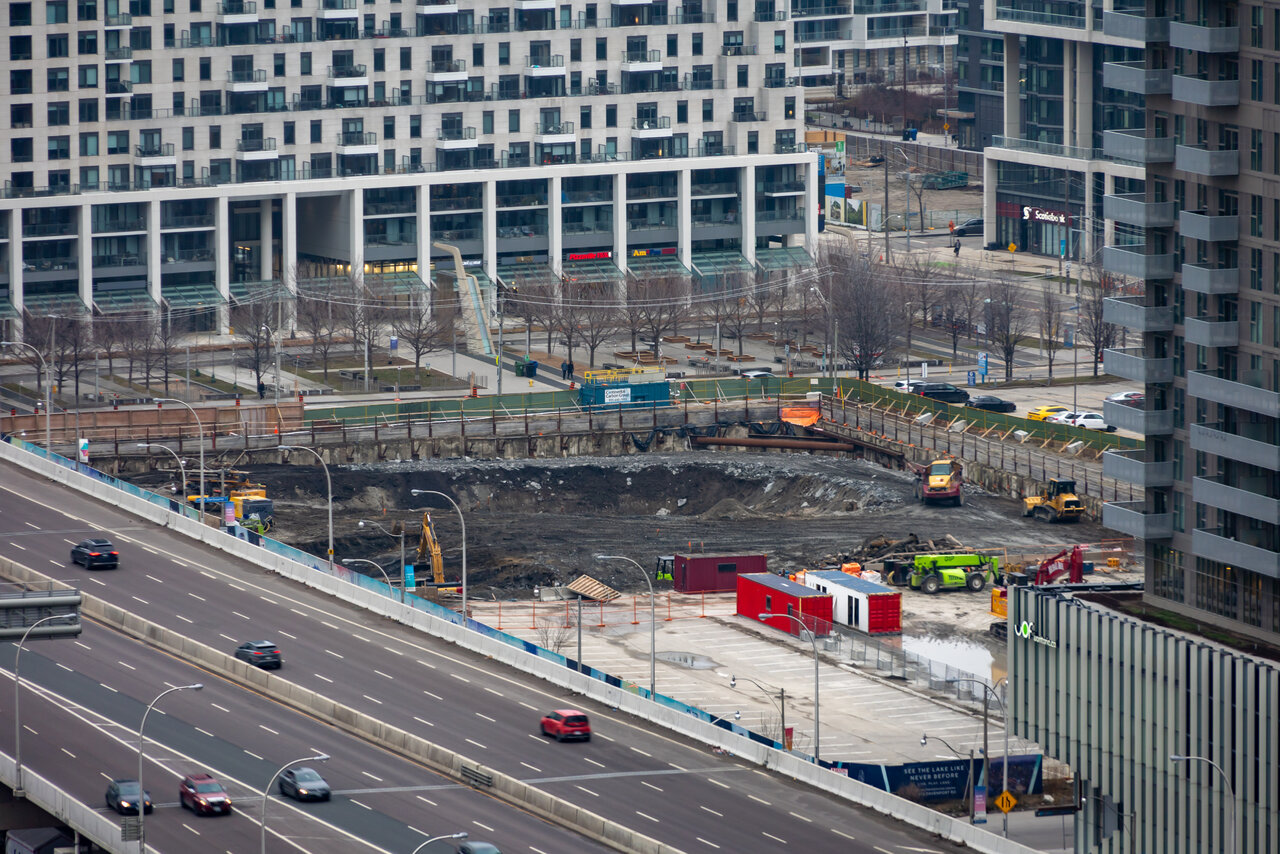

From today.
The site has shoring installed from the previous shoring and excavation permit. Why would they need to go through the whole process all over again?
You apply for shoring to the depth of the building's foundation. You don't do it twice once for contaminated soil removal and again for construction prep.
It's not a good sign for pending construction if the hole happens to be in the process of being backfilled.
I believe Norther Light-san was suggesting that the shoring there now was for soil remediation. If they want to excavate to build, they would need to request a separate application.
