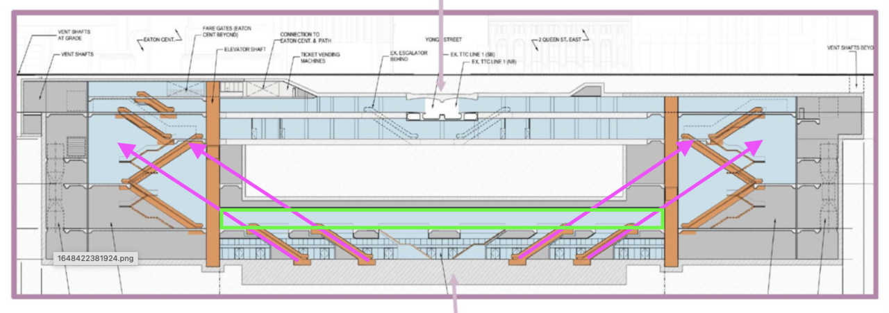

As we talked about before in the Ontario line thread, for some reason (probably Canadian/US building codes) they won't be using very long escalators to get down there. 5 escalators from street to platform is pretty embarrassing when other cities do that depth in 1 or 2 escalators.

The Queen station cut through shows that only one or two flights of escalators would really be required, rather than 5 - as in many other places.

It's not Ontario building code. Ottawa Rideau station has a 35.3m long escalator which would reach half way to the Ontario Line platform from the surface.
Wheaton Station (Washington) has 70m long escalators (35m vertical-rise) which could reach the Ontario Line platform from the Queen mezzanine level (if horizontal travel allowed for it). They'd probably have to underpin the existing station rather than building vertically adjacent to it though.
Definitely too late to change the design now, but in theory you would replace 8 banks of escalators with 4 banks of 2x escalators. The length is perfectly doable!
This is why I consider public consultation and meaningful engagement to be useful - rather than the opaque design process that the Ontario line has been using.
Alon Levy does a great bit why a full height mezzanine (in green) is unnecessary - requiring more digging than is necessary. Even recent stations in Toronto have escalators from surface direct to platform level, unsure why this has been put in. I suspect caution regarding fire safety, but recent international projects (cough Crossrail cough) show this not to be the case - esp. with platform screen doors for smoke/fire protection...

Could be that wear and tear on a really long escalator would be worse with the expected passenger volumes.
Possibly, but good maintenance solves that problem! Most contemporary escalators/elevator contracts include purchasing maintenance direct from the supplier - i.e. you pay a smaller amount upfront and then $x a month for 20 years rather than than just the upfront cost of the escalators/elevator.
Many transit agencies that have very long escalators that run 20+ hours a day!
As per the terms of the contracts, the selected consortium is still in the design process. This means that the designs presented here continue to be subject to change until pens down. The cost saving incentive as part of the innovation aspect of the contract may result in some of the suggestions here to use longer elevator spans to reduce cost.
