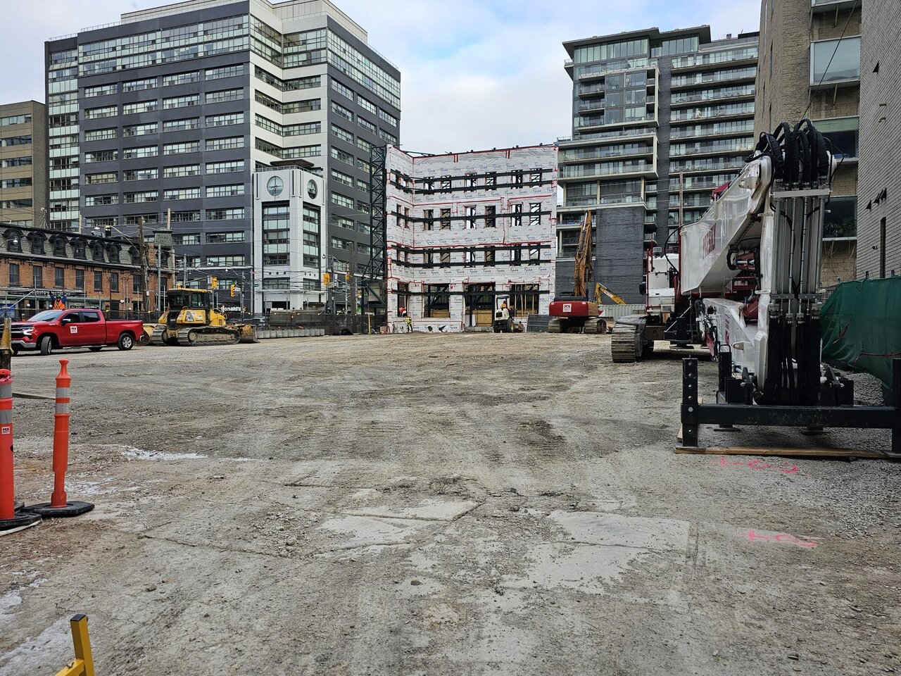

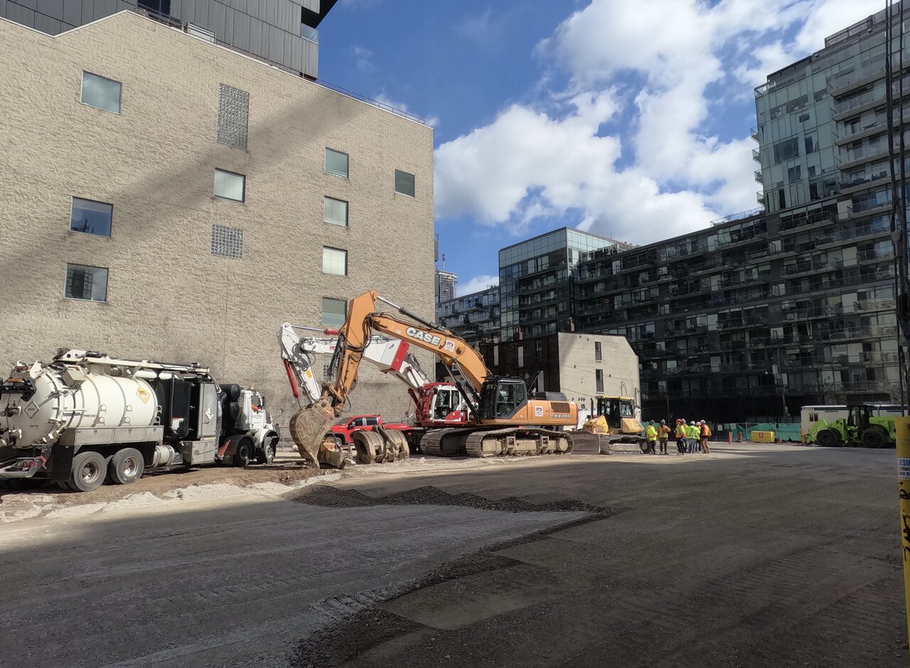

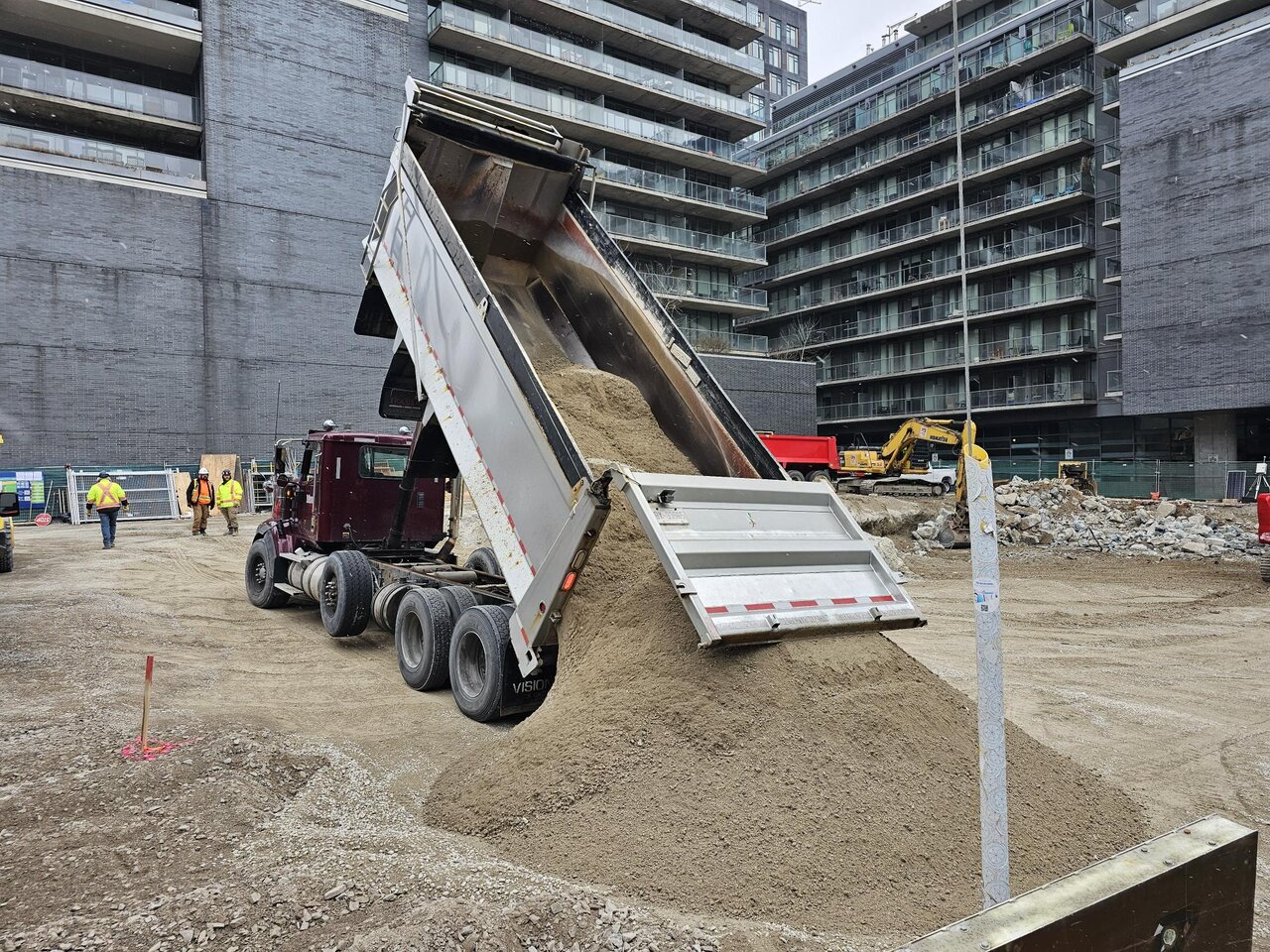

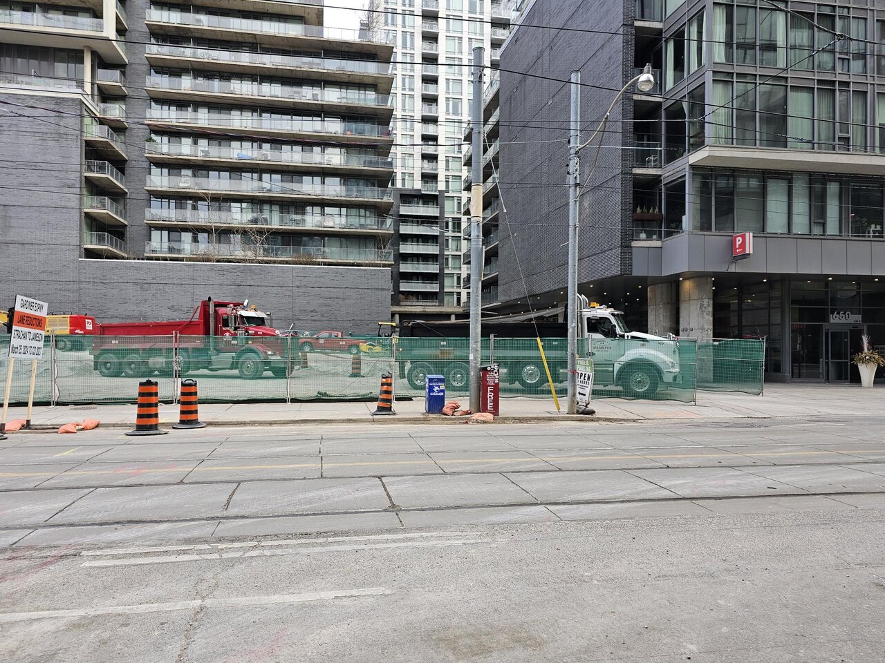

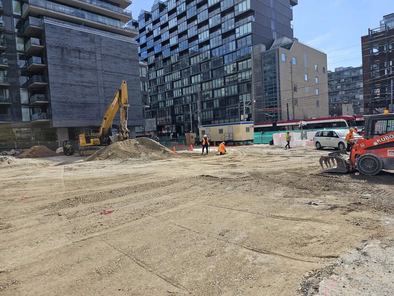

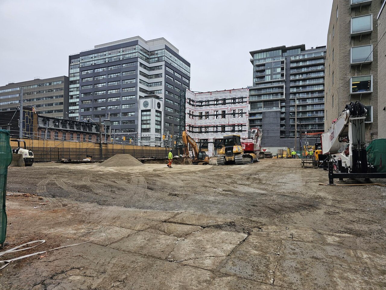

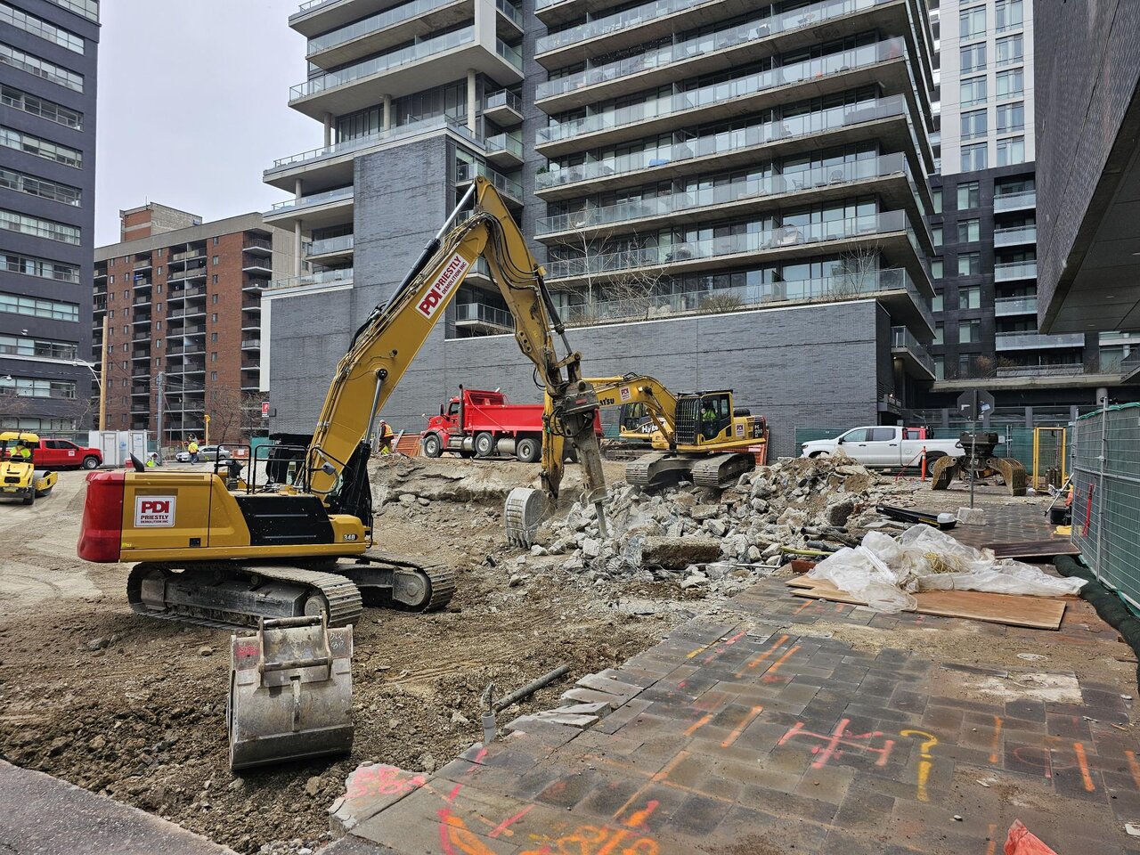

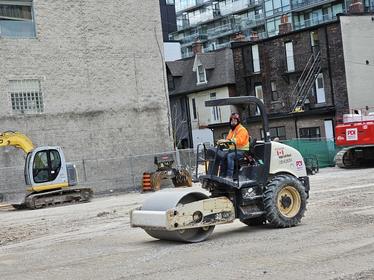

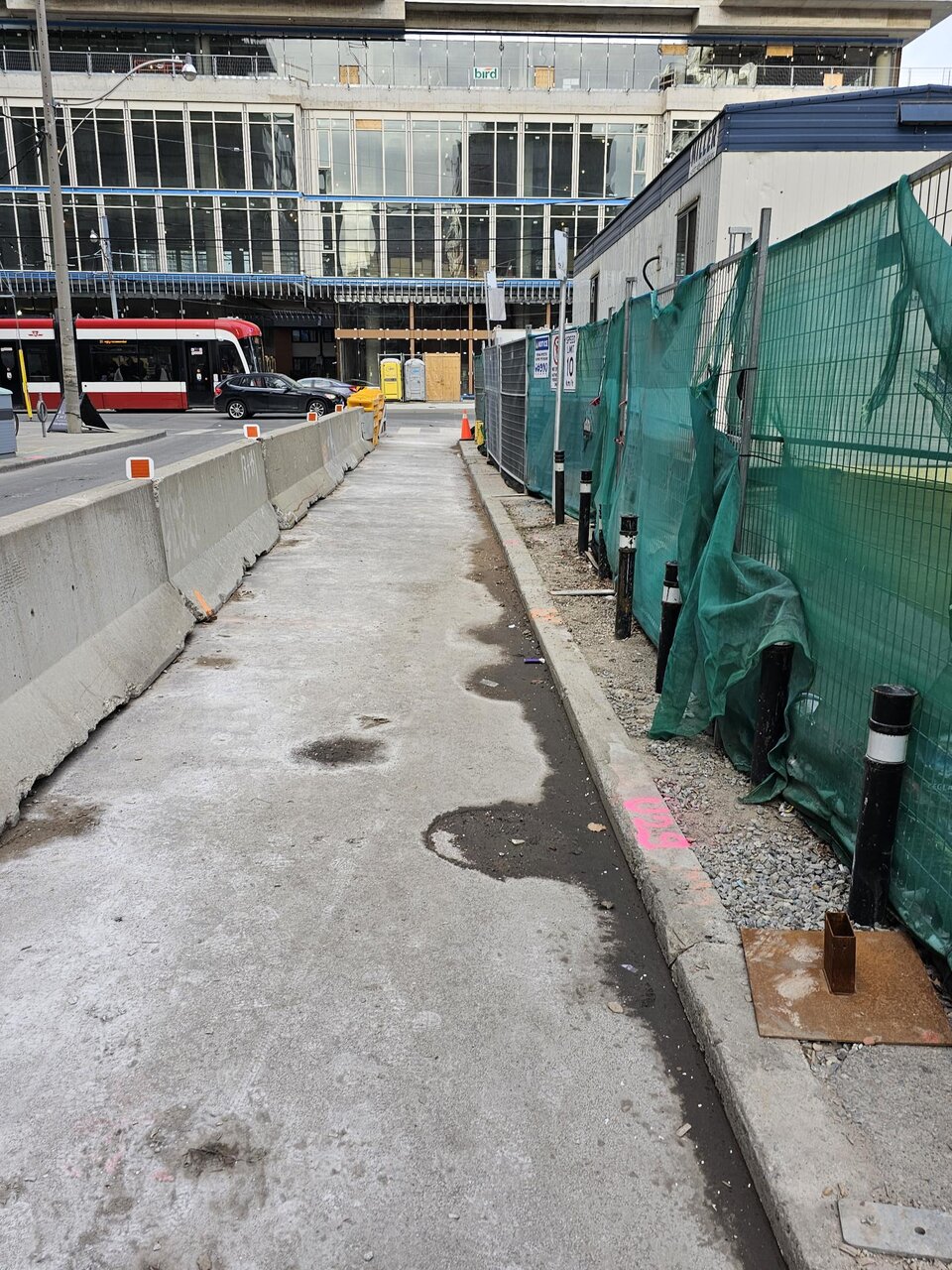

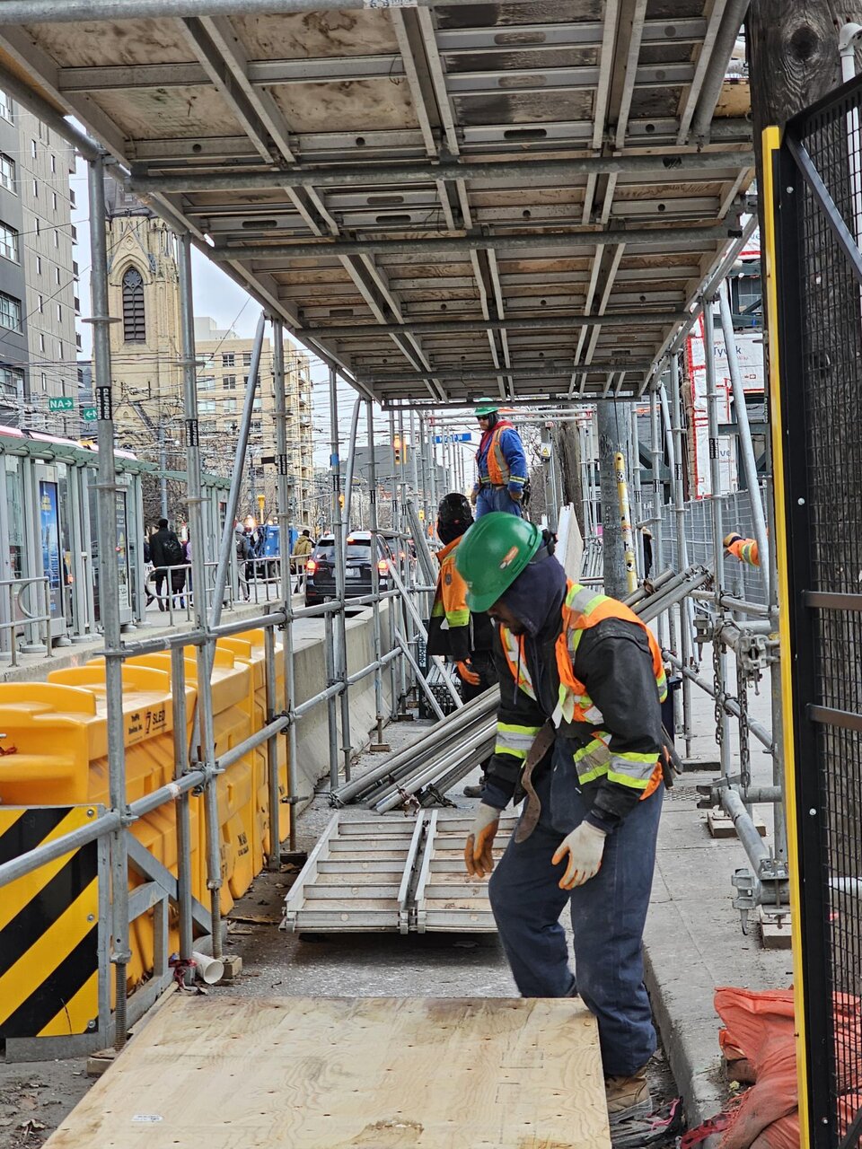

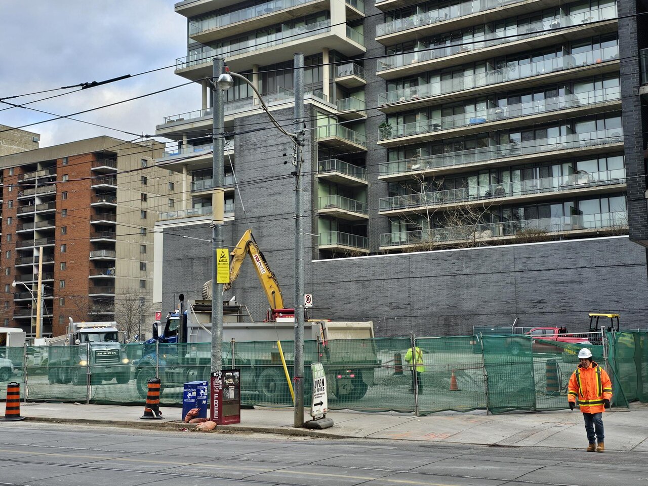

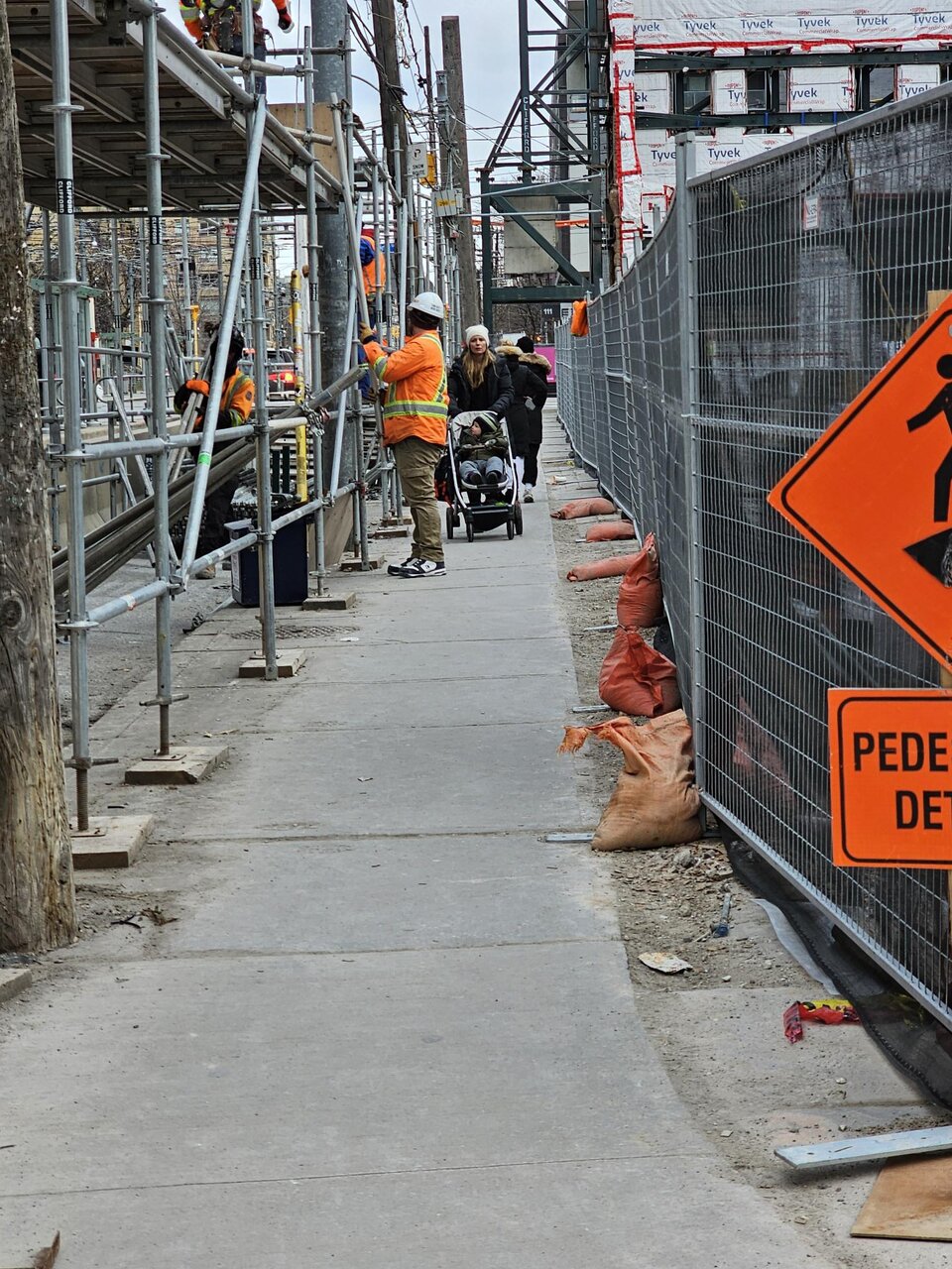

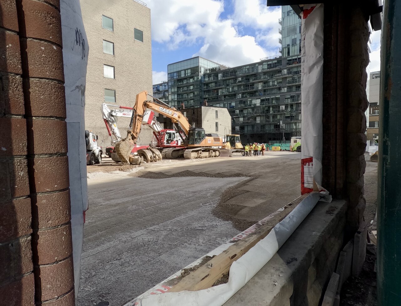

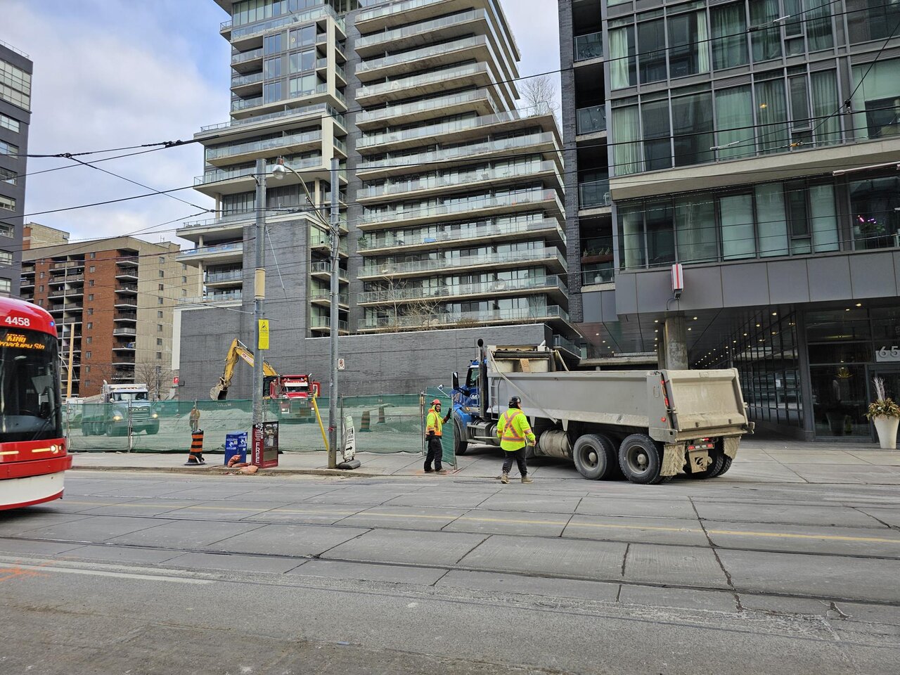

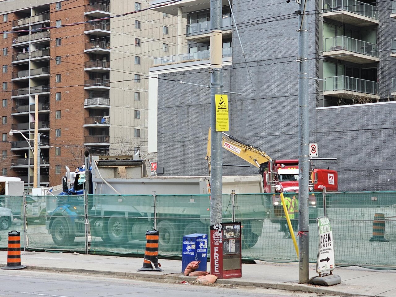

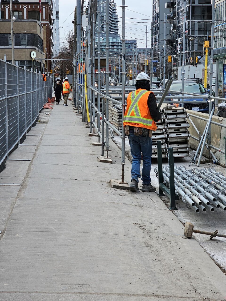

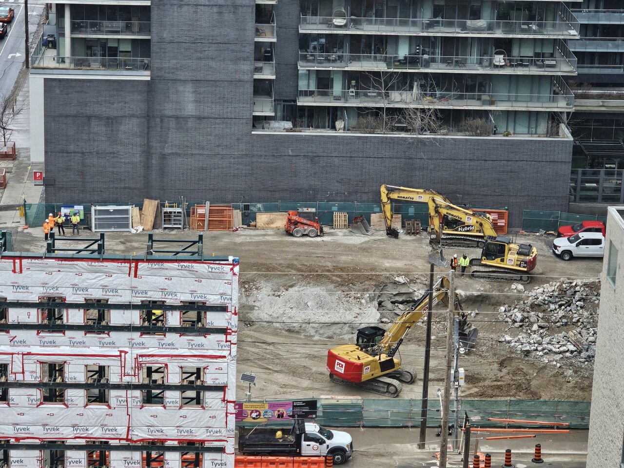

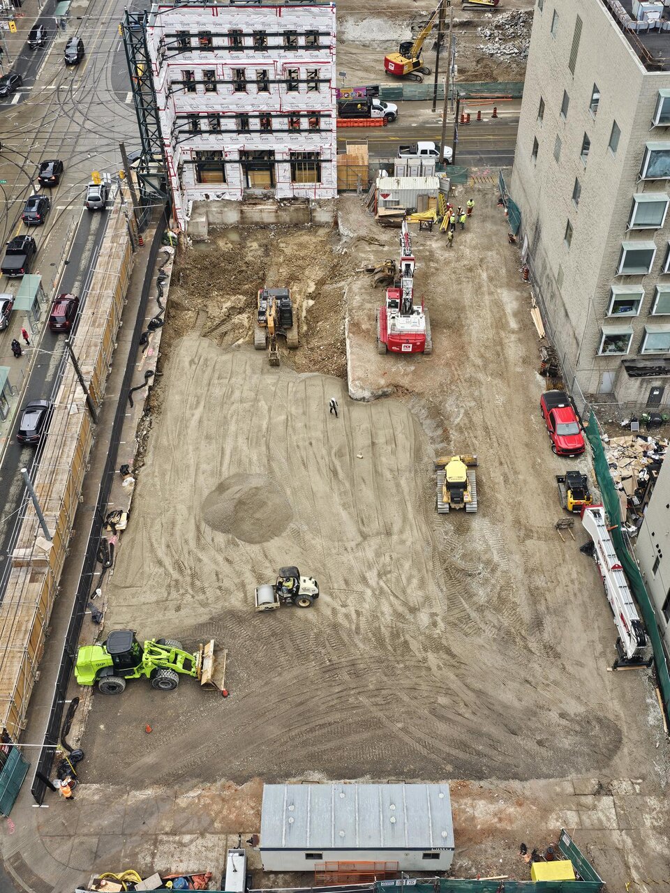

March 21: Some pictures from today. First, backfill and leveling of the south side, to prepare for shoring and excavation, is virtually complete. Second group of photos - Bathurst Street sidewalk has been reopened, and the final remnants of hoarding are being removed. Third set - still some excavation work being completed at the north end of the site on the north side of King Street - a lot of activity, with a number of dump trucks on site, being and waiting to be filled.
My understanding - the shoring equipment is anticipated to arrive on the south site on Monday, March 25, and the north of King Street side on Tuesday, March 26.
South side of King Street
Stewart and Bathurst Street Sidewalks, and in the first image, a side view of the recently delivered site office trailer:
North Side of King Street - Lots of Activity, a constant stream of dump trucks arriving, being filled, and leaving:

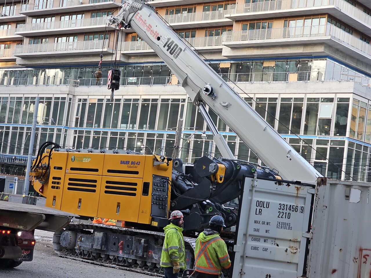

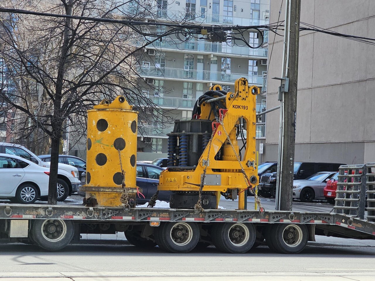

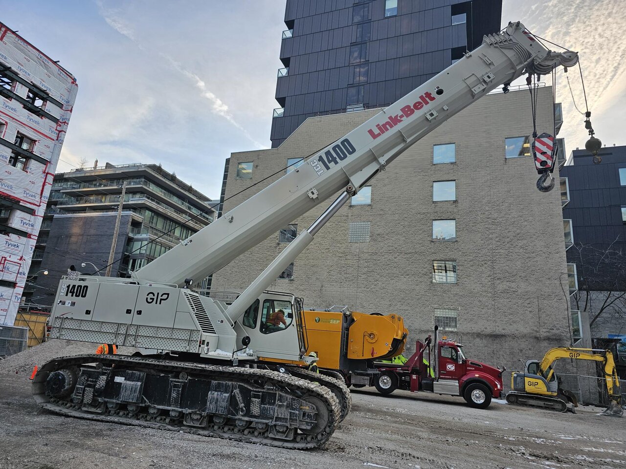

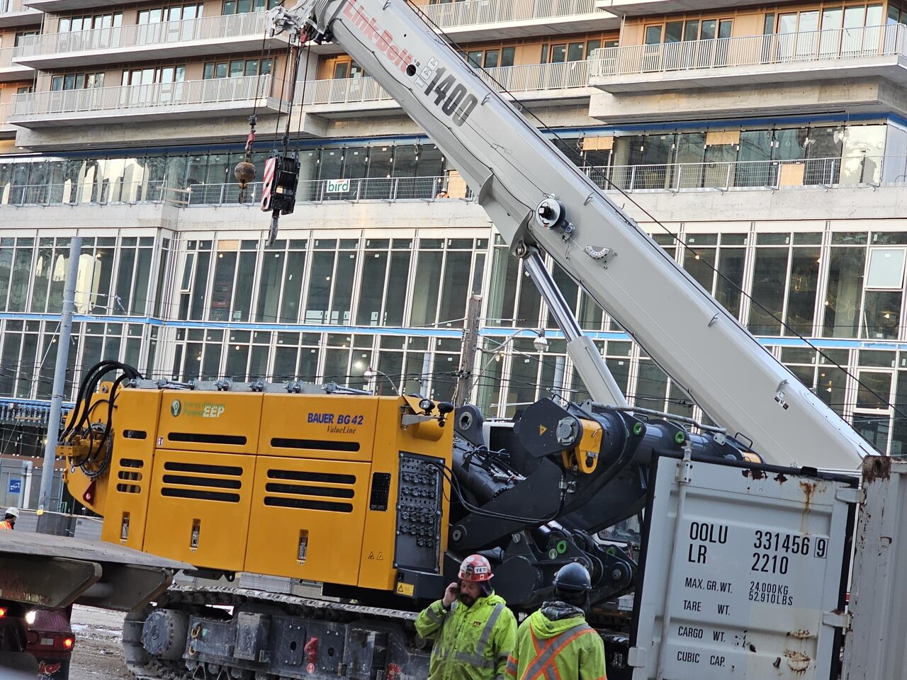

...I think that's one of those mobile retractable crane thingies though.

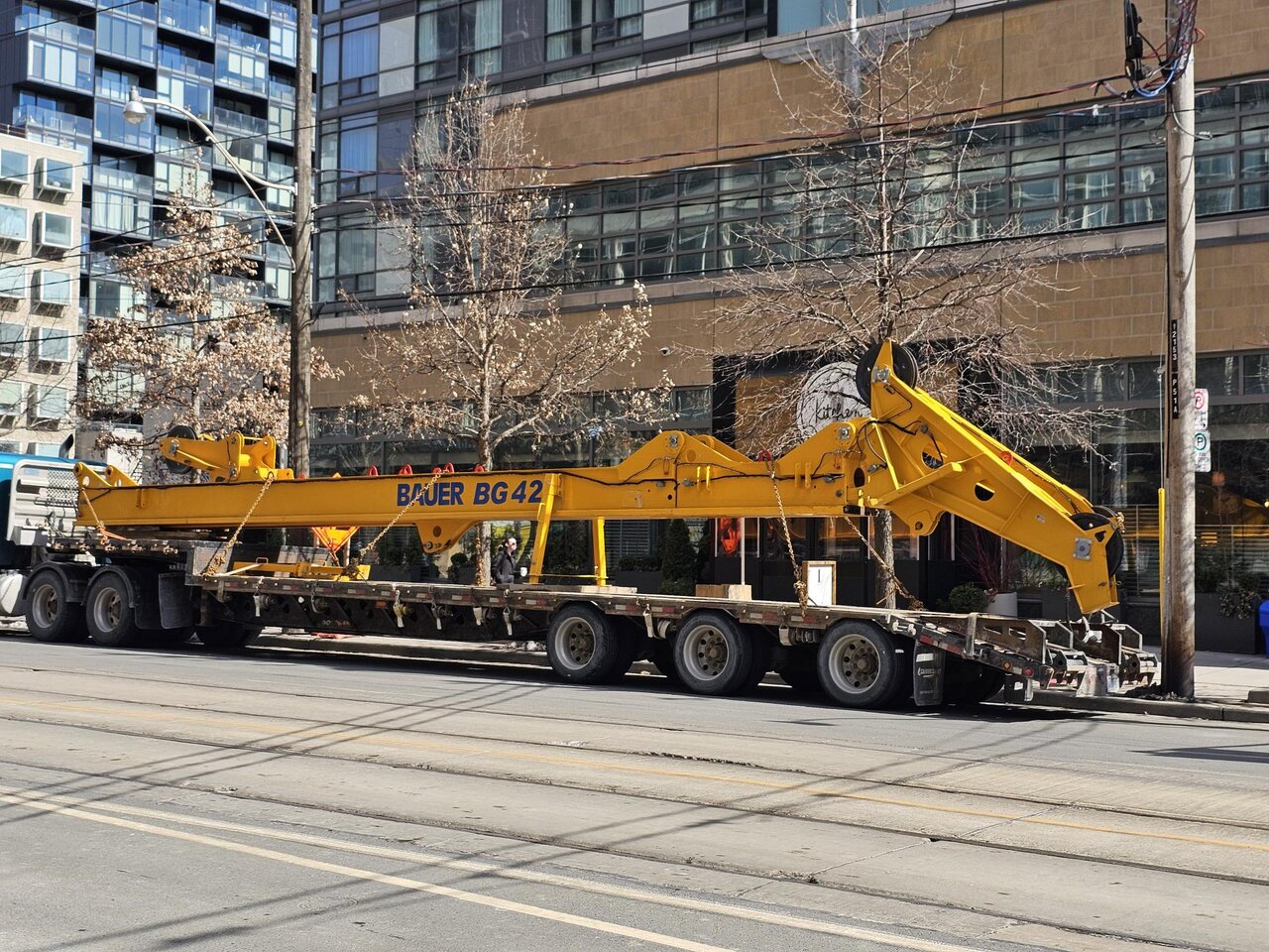

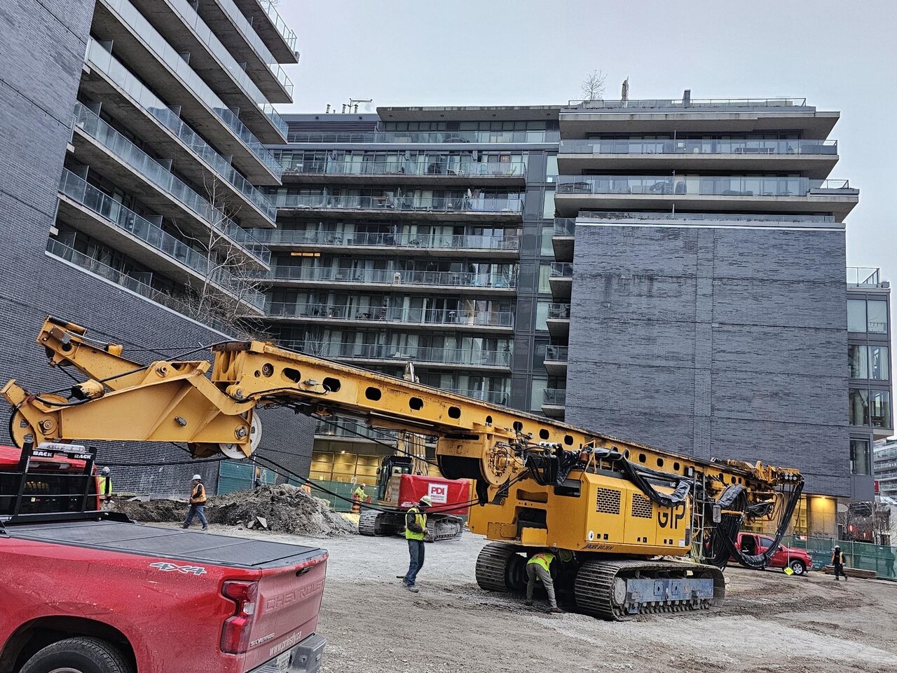

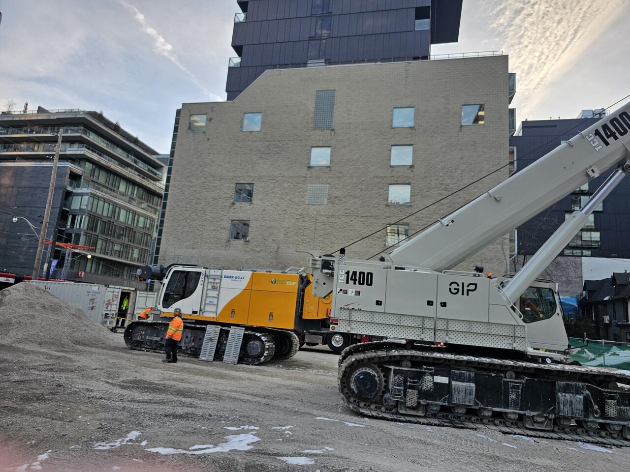

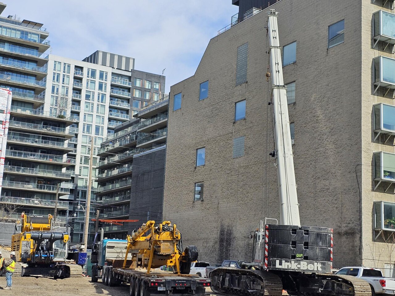

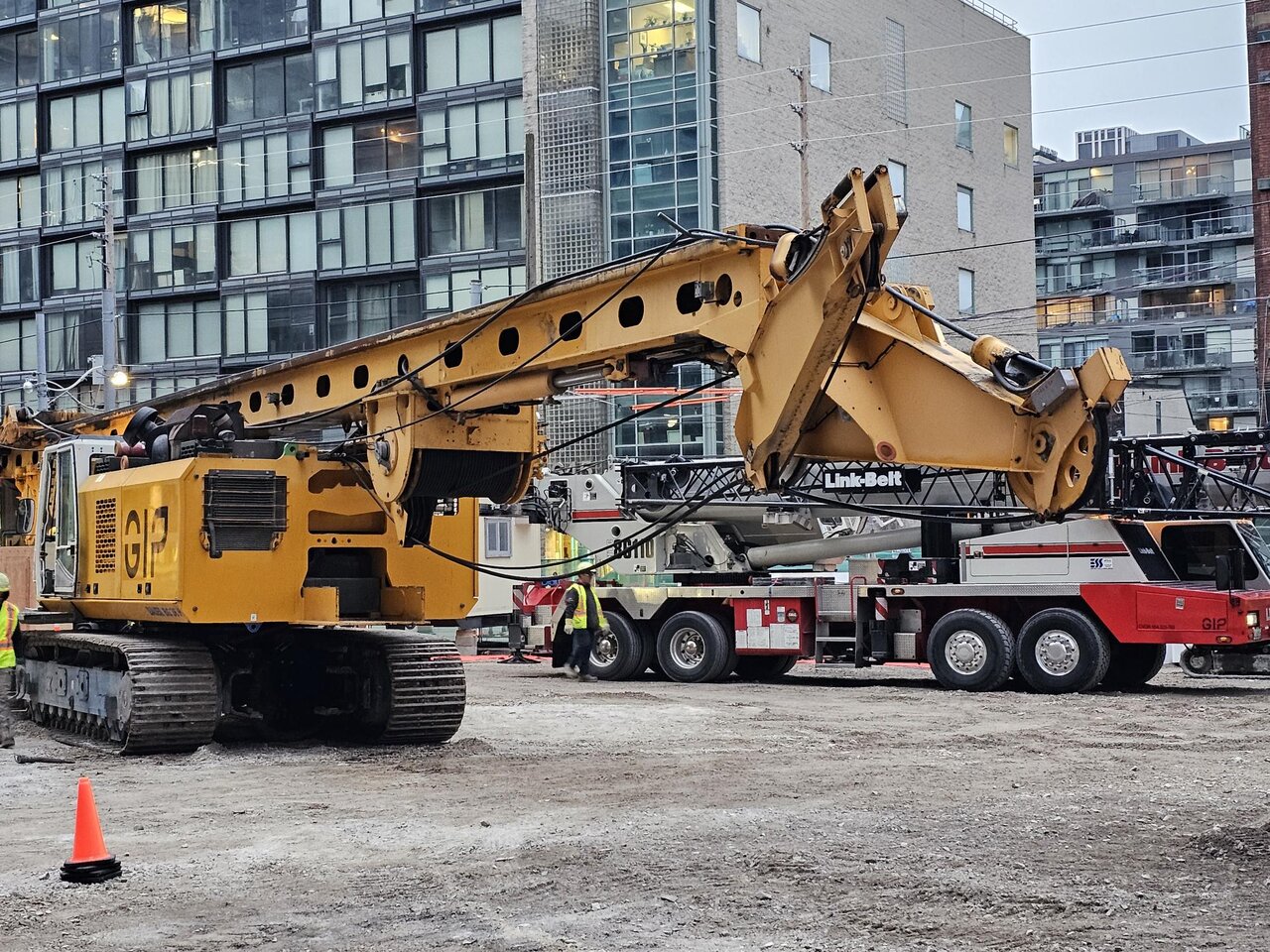

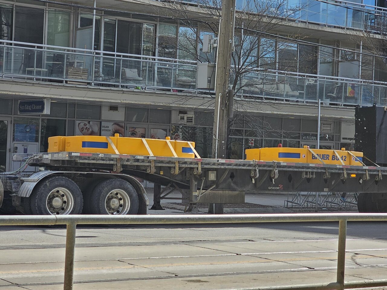

The yellow Bauer BG 42 is the shoring machine. For transportation purposes, the shoring machine and its drill equipment attachments are delivered on separate trucks. The mobile crane is there to lift the attachments into place for connecting to the BG 42 itself. Some on-site assembly required.
The yellow Bauer BG 42 is the shoring machine. For transportation purposes, the shoring machine and its drill equipment attachments are delivered on separate trucks. The mobile crane is there to lift the the attachments into place for connecting to the BG 42 itself. Some on-site assembly required.
Oh...I see it now! NM then. Sorry about that. And as you where. >.<

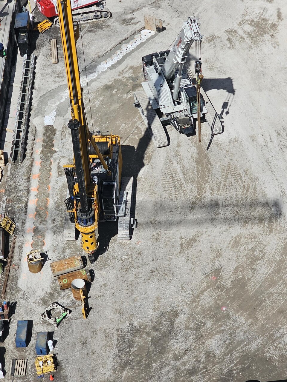

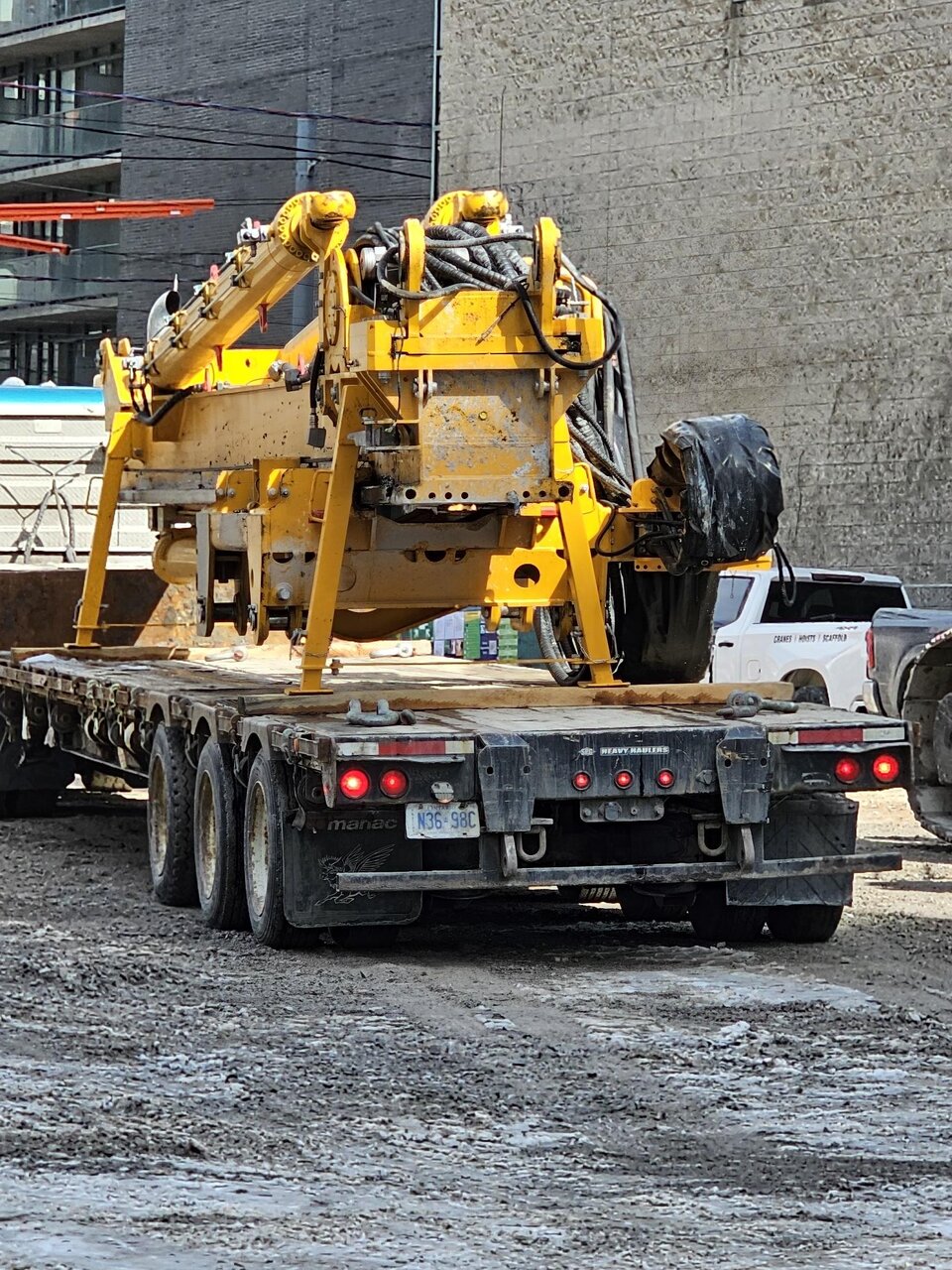

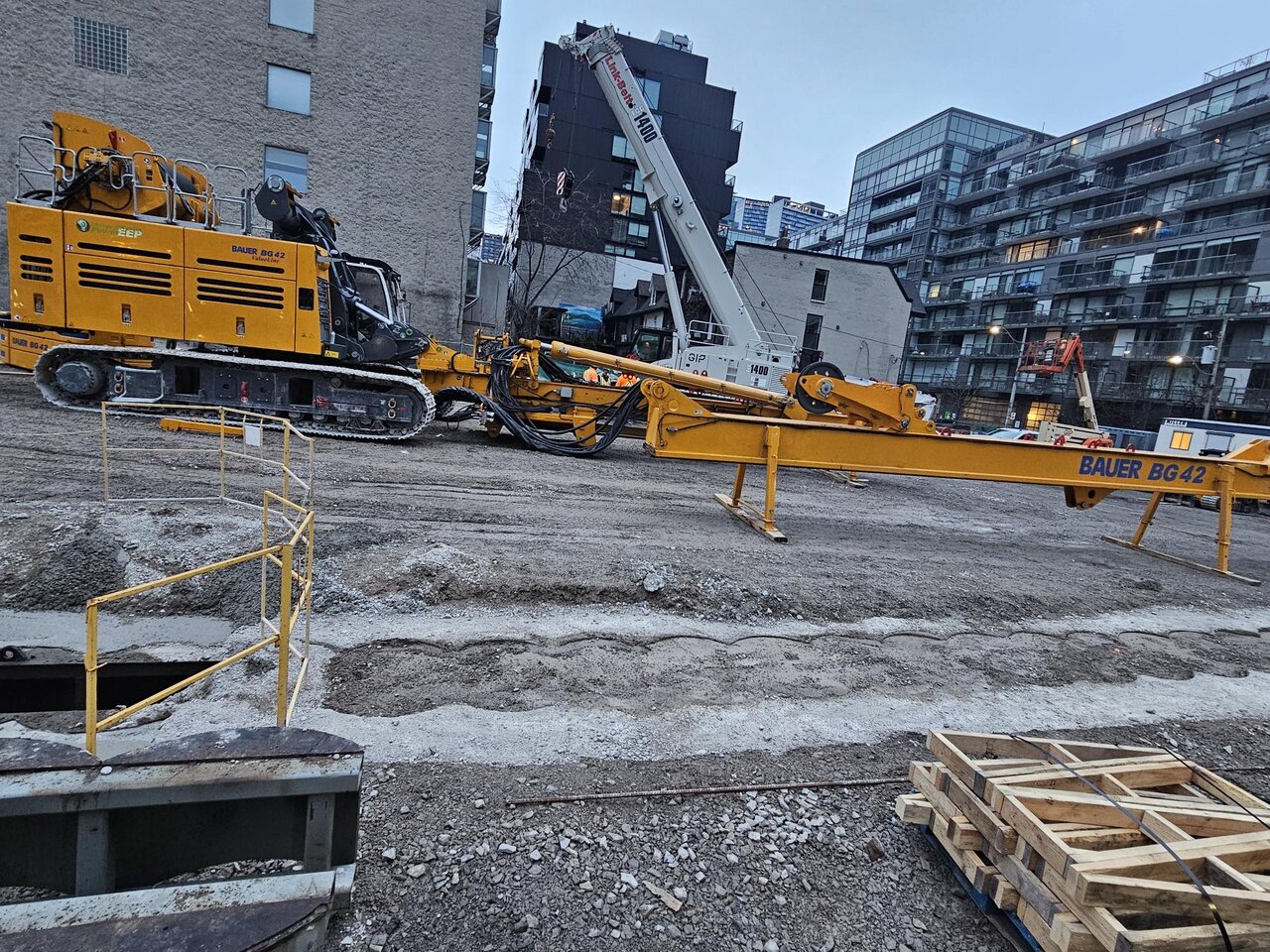

March 25 - PM: The rest of the shoring rig attachments have now arrived and are waiting on installation on the base Bauer BG 42 unit. Also, first a photo of the north of King Street site, almost ready for the arrival of its shoring rig.
The front of the BG 42 unit itself, before adding the shoring attachments. Looks very incomplete without the attachments.

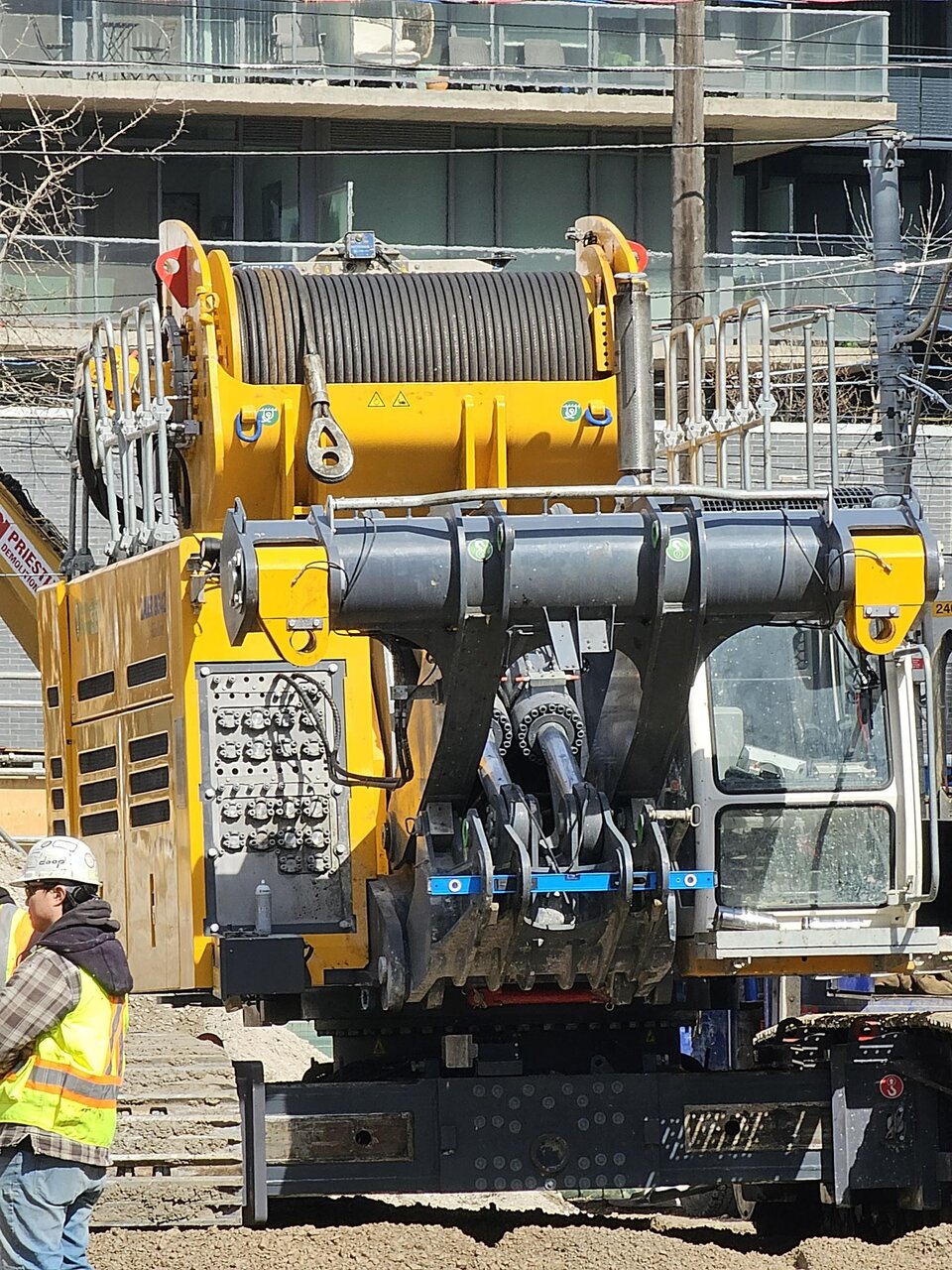

Getting ready to lift and hook up the first attachment - the hydraulic mechanism that raising and lowering the drill mast.
The hydraulic mechanism for turning the drill piece
The mast
And finally, the counterweights

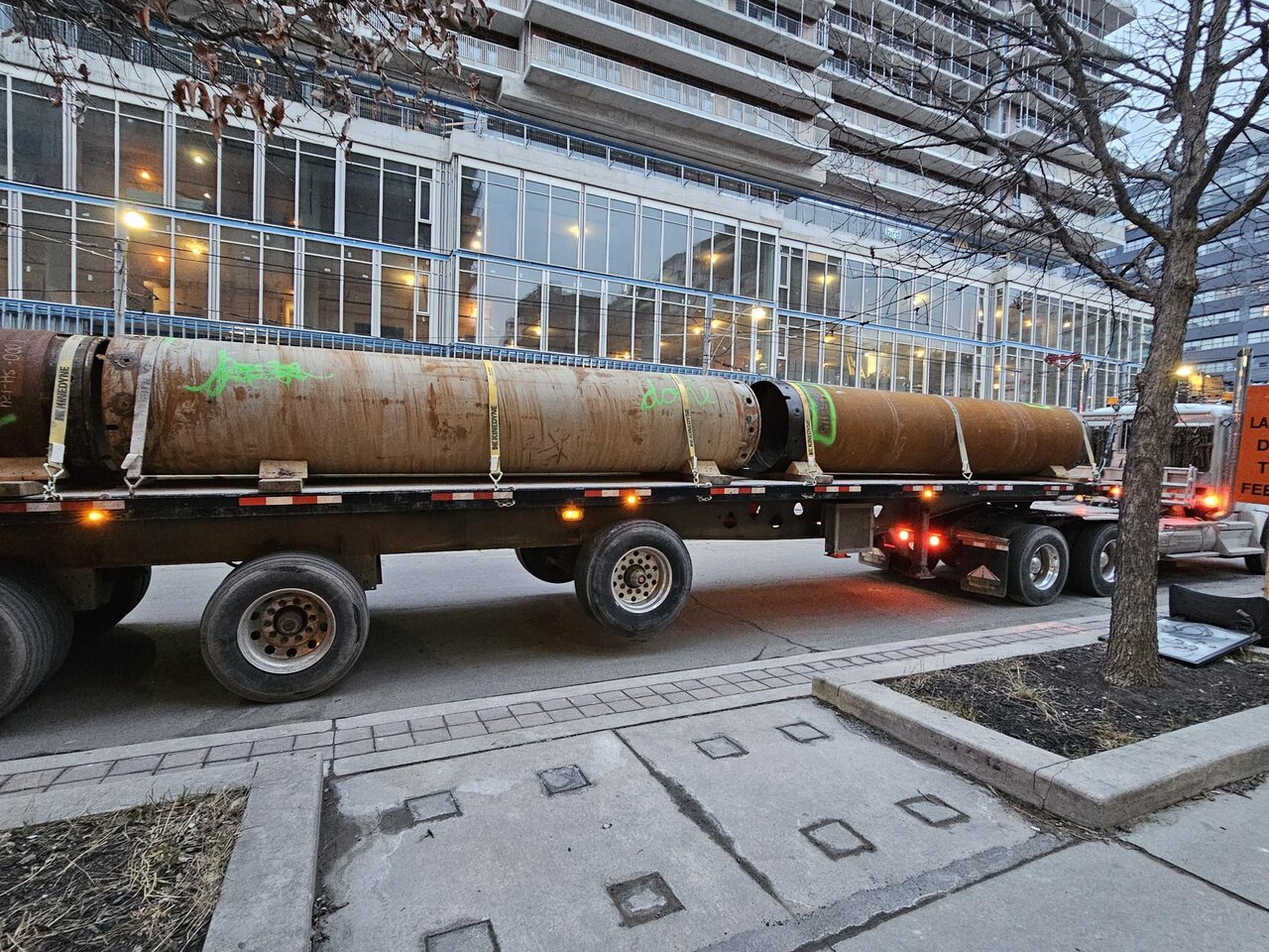

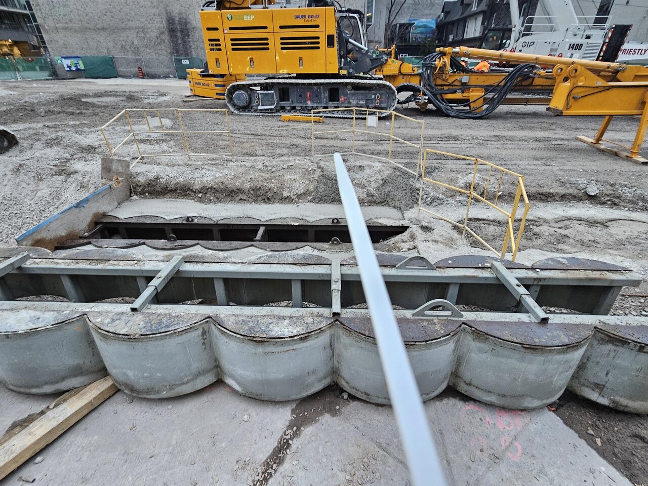

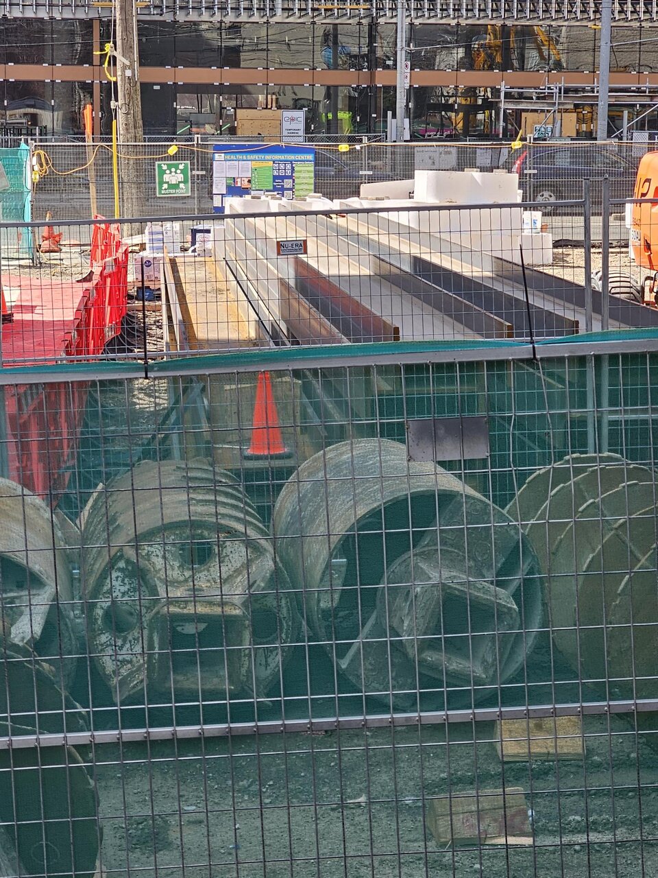

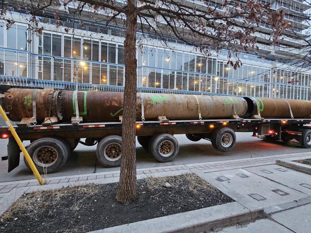

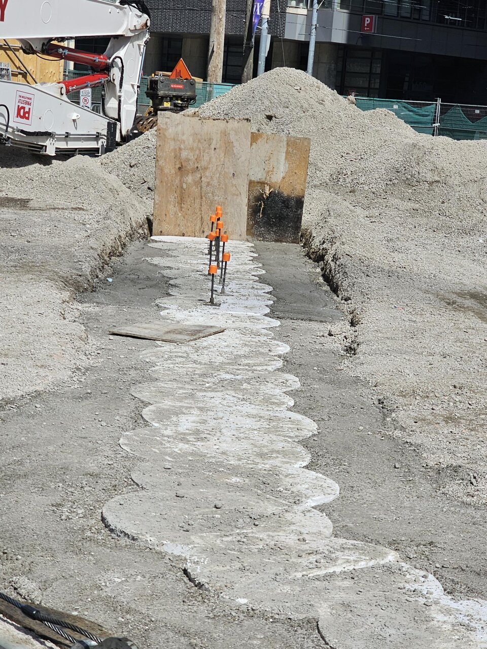

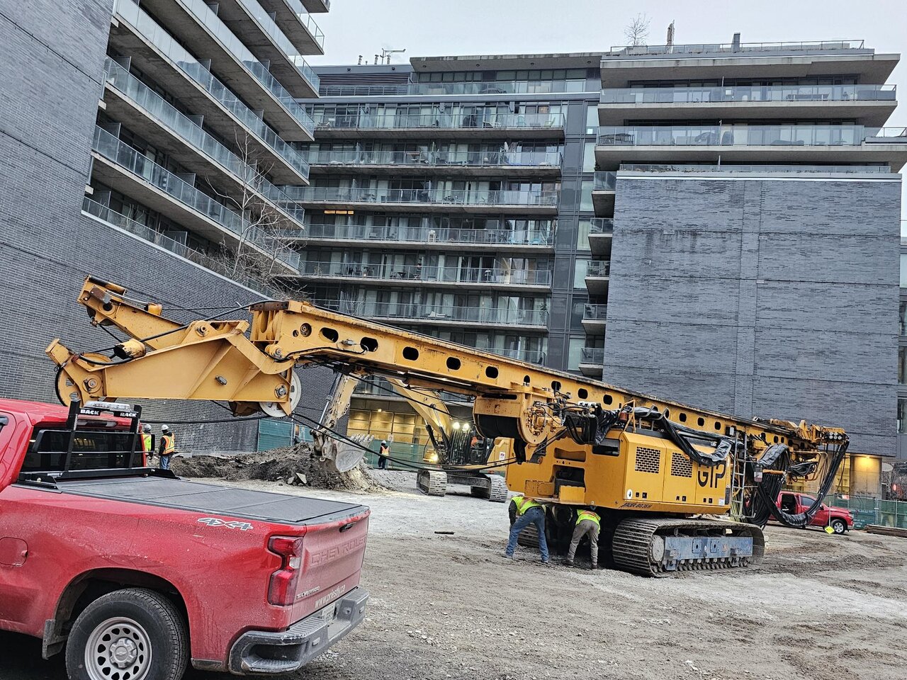

Tuesday, March 26. More progress. The second shoring machine has arrived, this time to the north side of King Street. Setup of the shoring machine on the south side of King Street is continuing. Photos from the south side of King Street site show an interesting detail - a trench has been dug along the Bathurst Street side of the site, with template sections installed to mark where the shoring holes are to be drilled. An finally, the drill tube sections have arrived and were waiting to be off-loaded.
Shoring machine on the north site:
South Site
Drill hole template sections:
Drill Pipe Sections

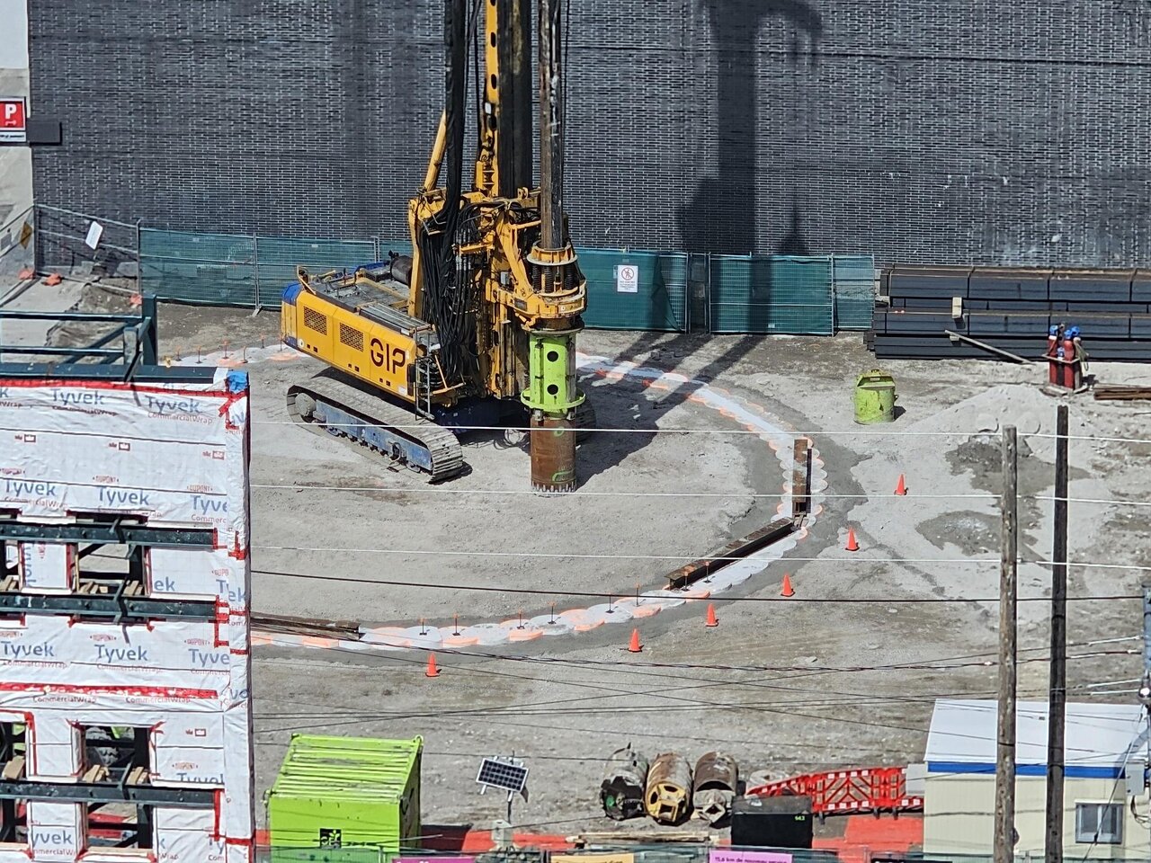

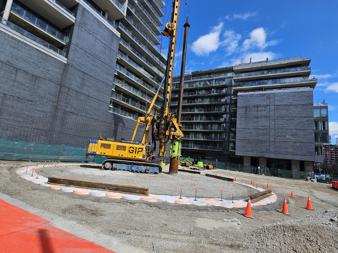

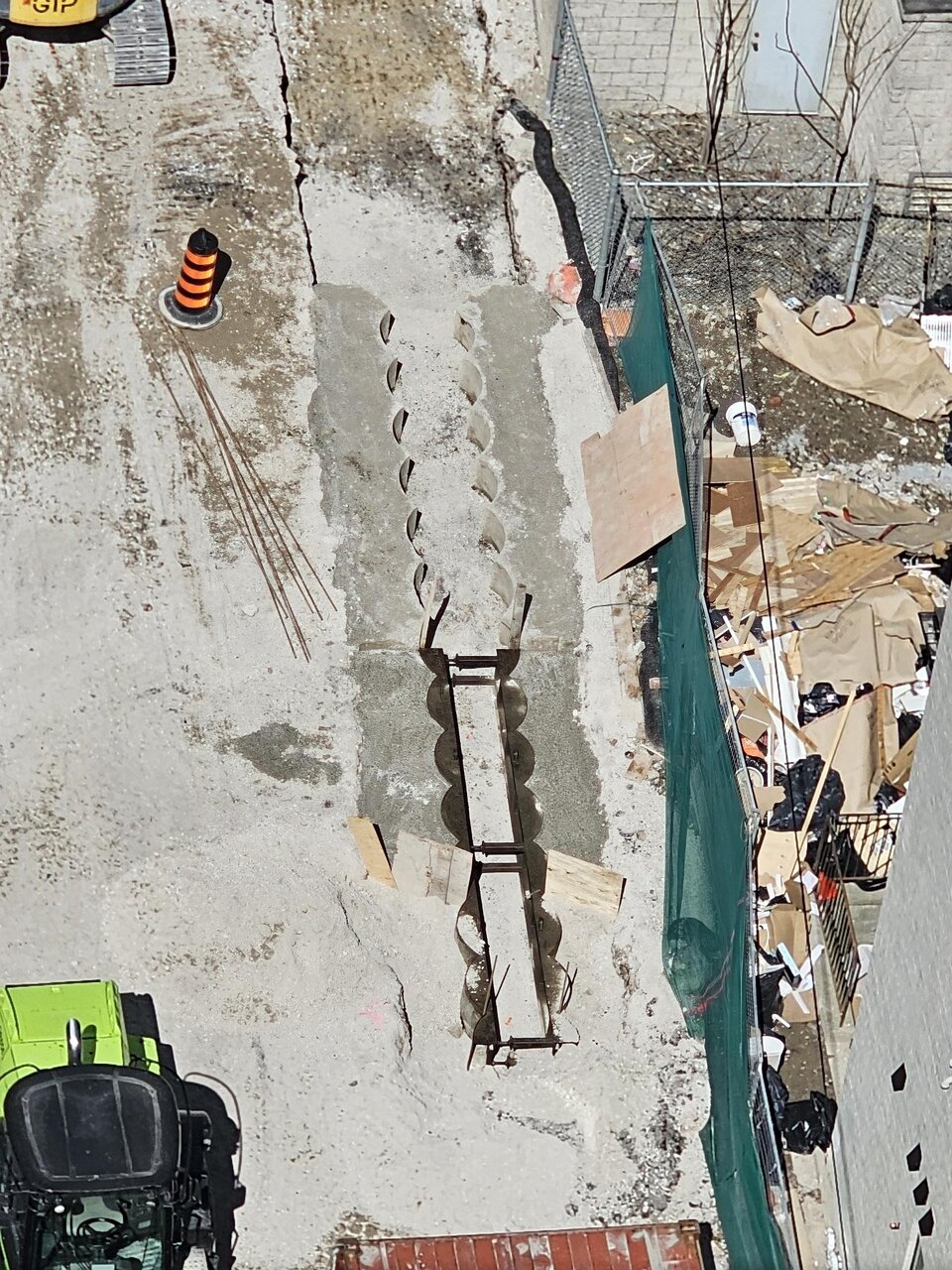

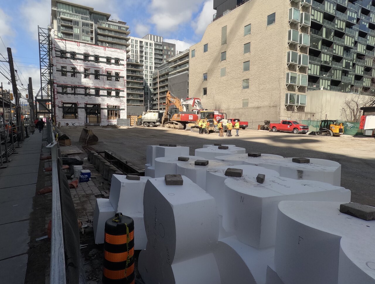

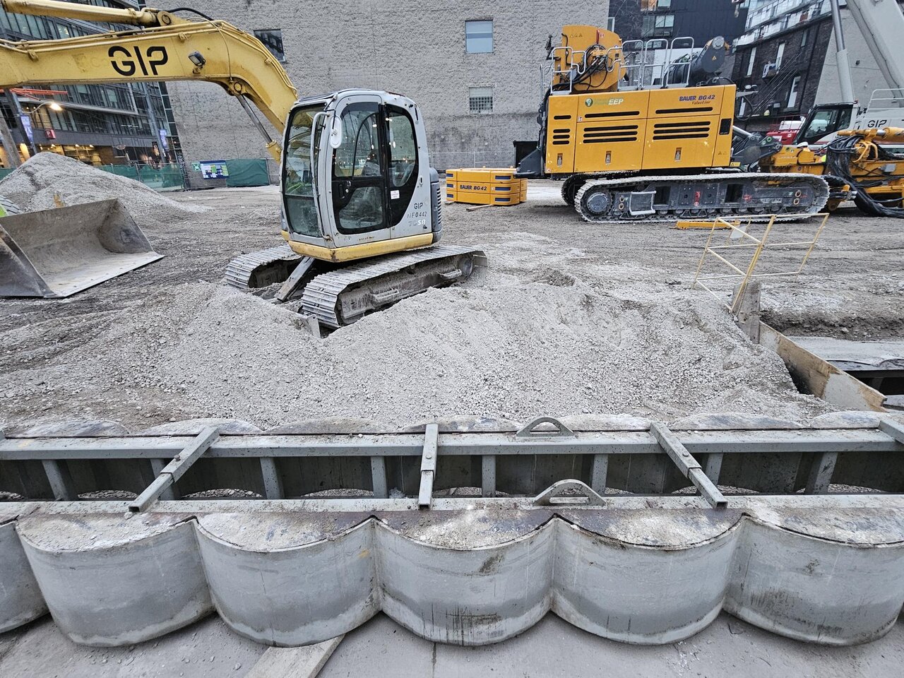

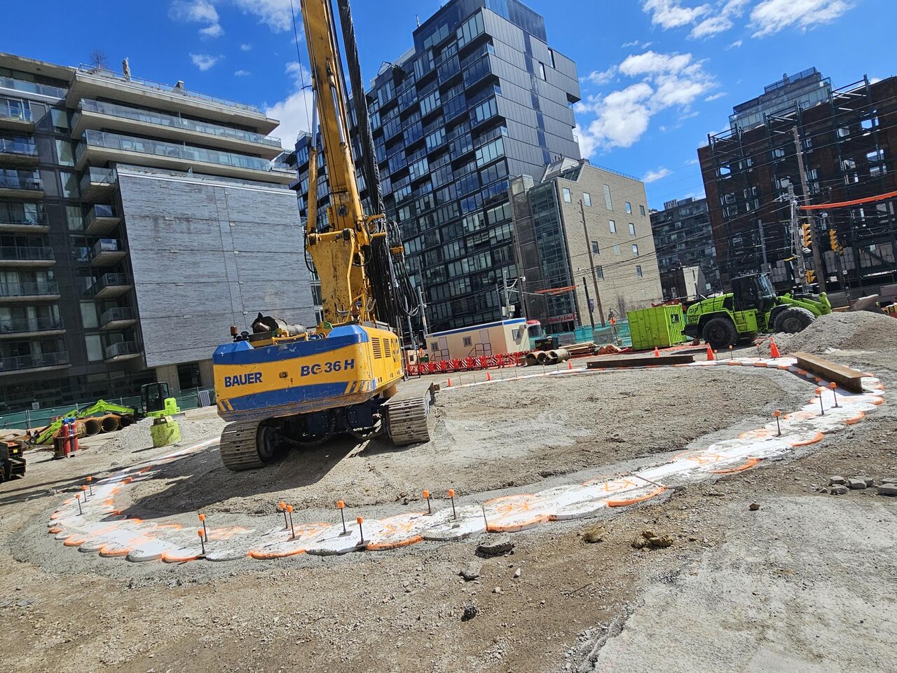

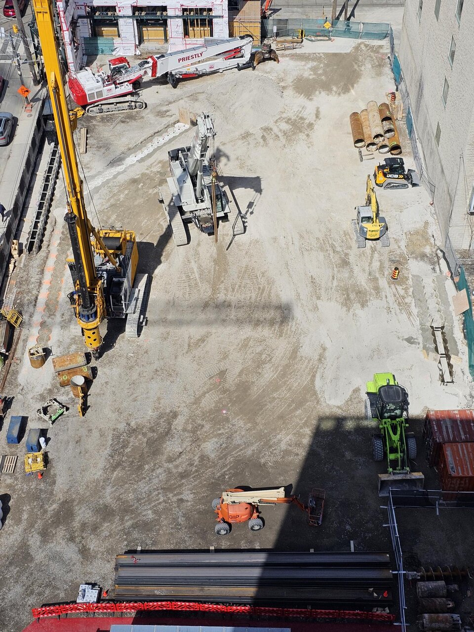

March 29: Interesting progress. Templates to facilitate locating the shoring drill hole locations have been installed both sites, north and south of King Street (south side still in progress). The location of the 15 metre in diameter shaft on the north side of King Street can be seen clearly - the rest of the site will be used for construction support until the surface related work, including the Transit Oriented Community development starts. The north side shaft is basically for support services and emergency exit - the main station building and access will be on the south side of King Street.
On the south side of King Street, the templating done to date shows the shoring and excavation will take over most, but not all of the site. Notably, the underground component of the station will not extend to the heritage Banknote Building wall on King Street. Further work will need to be done at a later stage for the main station entrance from King Street and the Transit Oriented Community redevelopment, which will presumably incorporate the historic King Street facade.
North side of King Street - template for the 15 meter diameter services and emergency exit shaft:
South Side Templating: Two different technologies in use - straight stretches use metal form sections in held in place by a thin concrete layer on their sides. Curved (and some straight) sections have a styrofoam mold positioned in the ground, with concrete liner on each side to hold them in place.
Final photo, south side of the site - steel shoring beams, in the background some of the styrofoam molds waiting to be used, and in the foreground, the shoring machine drill bits.
