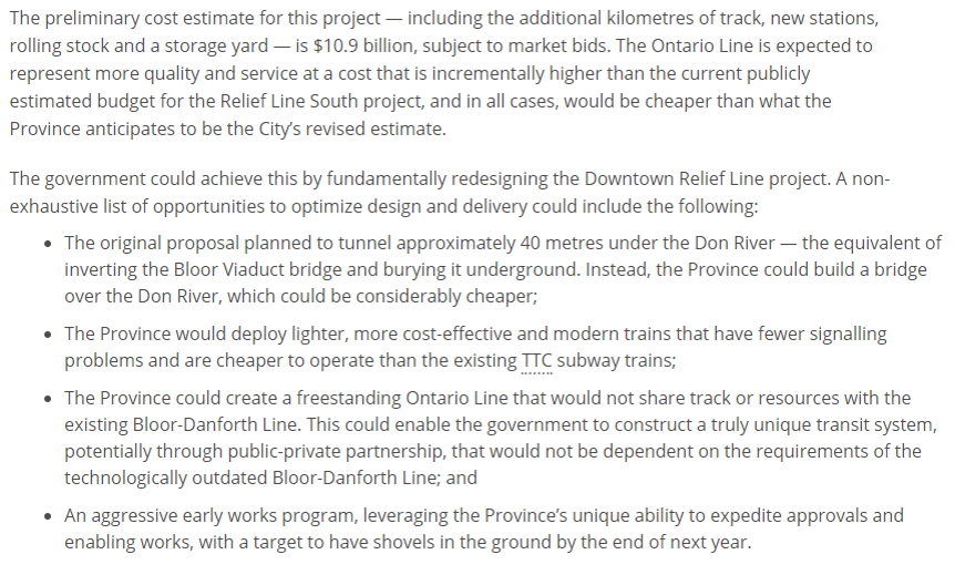

So there are these details from the budget:
If the bridge option for crossing the Don was so much better, why wasn't it being considered again?
$11billion sounds about right for a ~14km-15km underground railway with 15 or so stations (at least 4 of which would be interchanges according to the published maps).

As a total back-of-the-envelope calculation, I'd say the Ontario line, if it were a system like Sydney Metro and its packages broken down in a similar way would be:
Tunnel and Station Excavation: ~$4-4.5 billion (double the amount of stations = double the amount of the most costly components of an underground railway).
Tunnel and Station Fit-out: ~$2.5 billion (more stations ti fit out, substations and the like)
50% of that projected total amount seems about right (Syd Metro and the Melb Metro Tunnel project are in the same league in terms of % of total cost). The rest would include building a yard, procuring a fleet and the total ~$11bil might include a portion of opex to run the system over X period (Sydney metro is 15 years).
TL;DR? In short: it passes the pub test/sniff test (IMO
