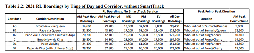

The vast majority of the financial district is a short walk from the DRL as well. Moving the line to Queen improves access to the courts, malls, hospitals, etc. that are north of Queen Street and are also huge transit ridership drivers, while maintaining easy access to the vast majority of financial district office space.
We can go back and forth and anecdotally name sites of interest north of Queen and south of Queen but
the idea that there are more ridership generators for a northern alignment is belied by the fact that existing transit ridership (as represented by the King and Queen streetcar lines) and projected ridership (from various studies) is much higher for King than for Queen.
Queen may have historic, institutional presences, but King has much more existing and planned density.
Southcore and the Financial District are huge rush hour drivers, but after 6pm and on weekends they provide very, very little ridership.
Neither do the courts or hospitals ;) but luckily King has the entertainment district to drive night time and weekend ridership.
