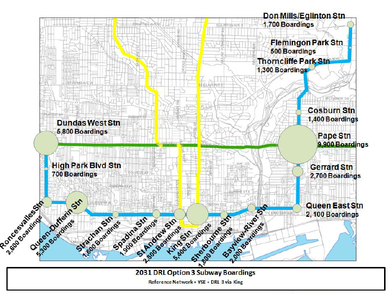

That's really unfortunate, considering the value that the western section has. According to TTC demand projections in the DRTES, the western section of the DRL has more non-transfer ridership than the eastern section. Spadina and Liberty Village would be two of the most heavily used stations on the line. This also has the potential to relieve Union by getting riders from the western GO lines to transfer to the DRL.
These pictures keep on reminding my how unsymmetrical Line 1's Downtown U is. If it was a Spadina Line instead of a University Line, the Relief Line West and South would almost be completely symmetrical and centered around Line 1. :(
