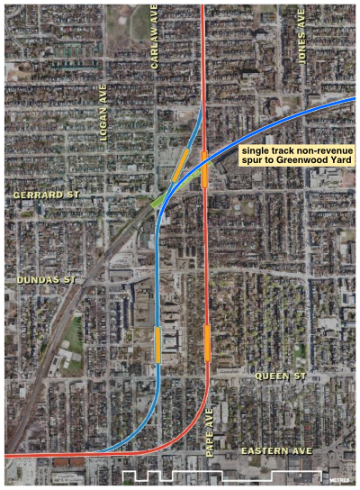

One thing that could be a benefit of the Carlaw-Pape jig (theoretically at least) is if we ever decided to route a nonrevenue spur to Greenwood Yd via the rail corridor. South of the Gerrard station the NE-SW alignment could make this more optimal if a Line 2 wye is cost prohibitive. That's just my theory tho.
This is what convinces me about the Carlaw alignment, ultimately.
I highly doubt Metrolinx will be open to that if you're proposing it at-grade. Besides, a new yard should likely be required for a fully built relief line (with lots of potential sites near Don Mills and York Mills or Wynford), and wouldn't there be some benefit to connecting Line 2 to said yard?
