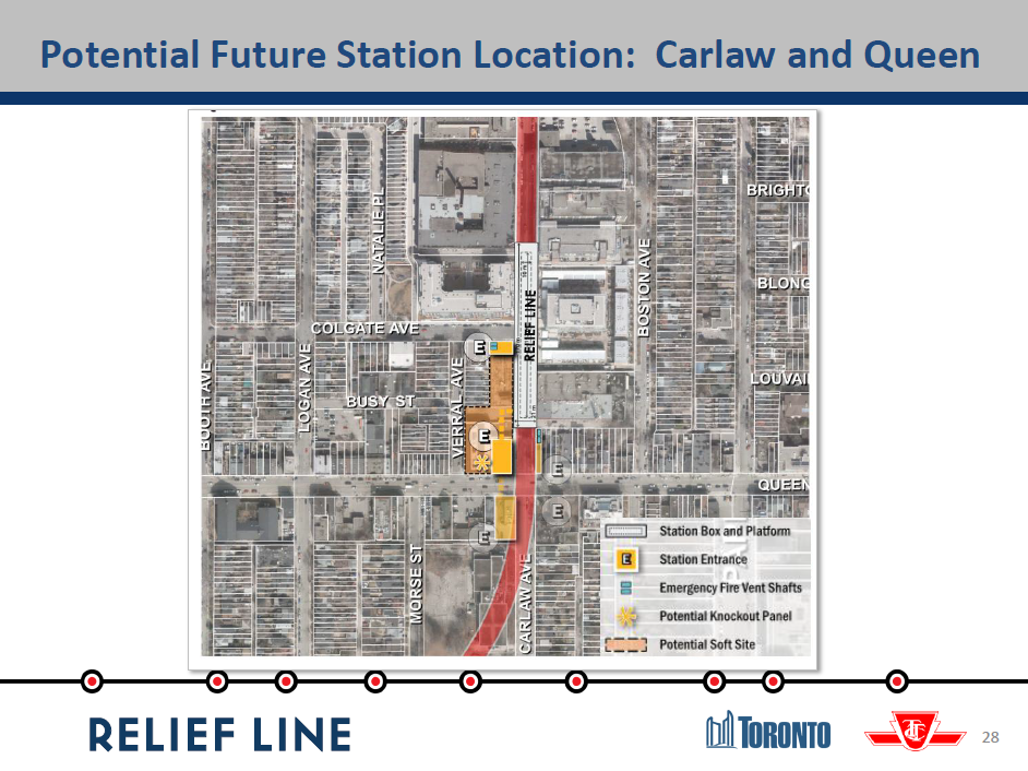

Although a lot of the noise has been triggered by NIMBYism, I fully disagree this is a bad decision and that it was made on the basis of NIMBYism.
From all the times I've walked through that area, I have always believed that the Carlaw alignment put entrances within closer walking distance of more subway-compatible land uses. In particular, the one at Carlaw and Colgate; although I think they could have explored putting it further north, it opens it up to the current higher-density uses on Carlaw between Queen and Pape. There's even some parking lots that can be infilled still.
Perhaps they should have called it less impact on single detached residential instead.
The slides show that the Carlaw alignment is better in every metric except for cost. It doesn't increase travel time compared to Pape. It supports a greater concentration of residents. It has decent development potential while Pape has literally none. A station there is way more compatible with the neighbourhood than having it on a tiny residential street. It connects with the Pape bus, which will be really important when that bus starts to serve thousands of new residents in the Port Lands.
So what is the problem here exactly? If anything these NIMBY actually produced a better outcome, and it's one that I've long preferred to begin with for the same reasons as outlined in the slides.

A lot more than Pape.
There's nothing that says Pape can't be redeveloped in this area. Even if the subway goes down Carlaw.
Correct me if I'm wrong but Pape is totally residential. There's nothing to redevelop there while Carlaw actually does have redevelopment potential to complement the nearby neighbourhoods. I think that's what the report was heavily implying.
