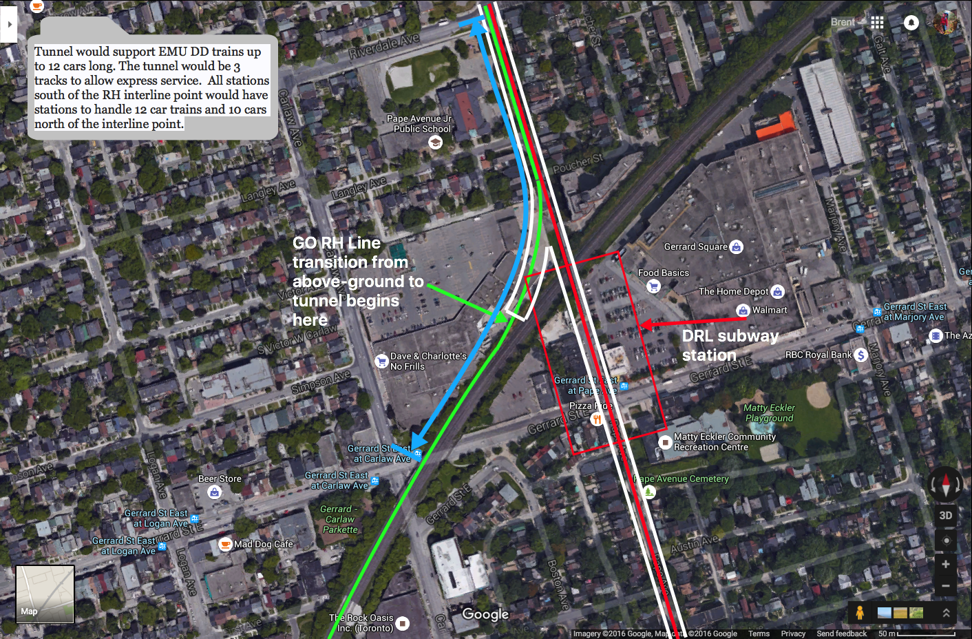

First problem I see is your portal and transition at Gerrard. You've drawn it in at about 450 feet long. But the drop from an elevated right of way to subway level is going to be 35 feet bare minimum, which at 2% grade for heavy rail is 1750. That takes the start of the transition back to Logan. Which puts the Carlaw and Gerard crossings, halfway down, at grade, so you have to close those roads. You might be able to to it in the green space between Queen and Dundas , as there seems to be a rise in the elevation towards Dundas.
Oh, I see. If the descent from elevated right-of-way to subway level could be extended to the full length of the blue arrow (drawn below), I estimate it would be about 400m (1300ft), but still not as long as you said was needed. If the grade could be greater than 2% and if the intersection of Gerrard/Carlaw could be lowered a bit, it might fit. It would be descending and curving, and the descending tunnel might have to protrude above the current residential street. The neighbourhood would be a construction zone for a while, and a strip of land would have to be taken from the No Frills strip mall. If something could be worked out with the property owners (e.g. density allowance), this entire mall area could be redeveloped at the same time.
If Gerrard Sq isn't workable, I like your other idea of having it go in near Jimmy Simpson Park (green space between Queen and Dundas), but more tunnel and more money I suppose. I can see how these projects get super expensive given the constraints.

Oh, I see. If the descent from elevated right of way to subway level could be extended to the full length of the blue arrow, I estimate it would be about 400m (1300ft), but not enough. Is the 2% grade a maximum? It would be descending and curving, and the descending tunnel might have to protrude above the current residential street, so the alternative you mentioned is prob better.

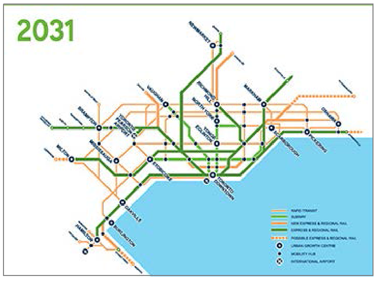

The Relief Line Long has been added to Metrolinx's priority map
Only looks like Dundas West to Pape on Page 2, and then a thinner line to 407. Not sure how seriously to take that, given it doesn't show the Scarborough Subway extension either.
Isn't this just the Big Move projects?
But then on Page 18 it shows it from Yonge to Sheppard, and including the McCowan alignment of the Scarborough subway to Sheppard.

The relief line in Metrolinx's presentation looks like it ends at Leslie Station/Oriole GO not Don Mills Station.

The map is hard to read, but it looks like the subway is on Don Mills to me.
Also notice that electrification of the eastern part of the CP line from the Junction to Agincourt is shown on the map. I don't recall seeing this on Metrolinx maps before.
