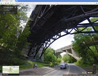

Here are photos of the 2 bridges - and you can see how the one older bridge is a duplicate of the Bloor Street Viaduct/Prince Edward Viaduct.
It has the same ability to accept a lower deck for public transit. The bridge couldn't be used for a subway in the 1960s, and generally the TTC has forgotten about it but with the ability to put in underground LRTs, it is possible to put in transit under the bridge and have it be able to avoid the subway line, and to connect farther east into Castle Frank station.
Castle Frank also has easy access to the DVP - it is really a good place for some TTC express buses or even GO buses to stop, so it becomes a sort of transit node.
The point I have been trying to make is that this bridge which has the capacity to accept LRTs with minimal modifications opens up several opportunities to improve transit in the core by running something underground at least as far as Parliament south of Bloor - it could just be the ability to link streetcars into Castle frank, or it could be something far more ambitious which could be a substitute for the DRL which can be built for less, and therefore built far sooner.
It has the same ability to accept a lower deck for public transit. The bridge couldn't be used for a subway in the 1960s, and generally the tTC has forgotten about it but with the ability to put in underground LRTs, it is possible to put in transit under th ebridge and have it be able to avoid the subway line, and to connect farther east into Castle Frank station.
Using this bridge for this "plan" makes no sense, and would provide minimal overall improvement for a lot of money.
Just because it has capacity for an underground line does not mean there is any value in using it - the alignments make no sense, there would be no ability to extend west (where would it go?) and it doesn't serve to expand the subway network as a whole and serve other parts of the City. This plan would only serve one purpose - to reduce the load at Bloor-Yonge. There would be almost no local demand, I dont really follow the DVP point, and would be a terrible spot for a transit node.

Reusing this bridge would provide a "buried" high capacity means of public transit to link the Bloor Danforth line and the Financial Core, adding in extra capacity, being roughly as fast as the YUS if it was buried, and adding transit capacity in a part of the city that lacks anything other than buses running north-south, and where the Official Plan calls for intensification, as opposed to building transit lines through stable areas where virtually no growth is to occur (with the only exception being that many Avenues are possible intensification areas - that is another debate)
And if we do not do the full underground LRT line to the core, then at the very minimum, streetcar tracks from Parliament and Carlton can be run north, then go underground just south of Bloor (similar to the Spadina LRT) and then provide an extra connection between streetcars and subways that helps to siphon on riders from the stations along Yonge south of Bloor.

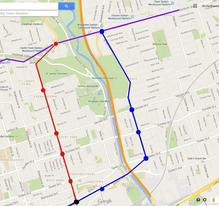

So, the TTC/Metrolinx are looking at a Broadview route as one of their options - presumably it would use "subway" heavy rail (in blue) but could be LRT type vehicles, depending on a variety of factors, but TTC is not looking at the red alignment from Castle Frank, in RED, which really cannot be a "subway" (anything is possible, but I am not considering it as viable).
In terms of the number of stations there is no difference really just one extra station, in terms of physical length, there is no real difference and the Parliament route means less new tunneling, and avoids going under the Don River.
The reason why the Parliament Route has an extra stop is because of Wellesley - whereas east of the Don River on Broadview or Pape, ther is no major east west rod between Gerrard and Danforth.
NOW look at the population density along each route. The Parliament route runs right by St. Jamestown and Regent Park, and Queen and Parliament is also closer to some of the employment uses in the brick and beam area and where new condos are going or already exist.
There is another option 2 - which is to do the Parliament route and then build another tunnel east to, say Eastern Avenue or Queen & River street, which would man that streetcars on Queen could actually go underground, for something like the crosstown LRt where part is in a tunnel and part is above grade...
Think of the proposed DRL as an expensive subway though residential areas, whereas what I am proposing is really BURYING the King streetcar ADN running an underground extension up to Bloor, to connect in to the only place possible in the core, where no other major transit line is proposed depite the extra density that is or will be built.

Extending "West" - the idea is that is does go west from this bridge only to Parliament, where it turns south... there is no point in go west of Parlimanet along Bloor as of course it then goes to Sherbourne station.
Ah ... I see. It's an interesting idea.
It would provide for quite a convenient connection at Castle Frank. Though it still suffers the other issues I noted. There just isn't the demand on Parliament, and it doesn't provide the time savings that intercepting the Danforth subway further east provides.
Are they? It's also very flawed. One of the requirements of an environmental assessment is to look at multiple options. Sometimes you just toss in one you know is going to fail. I have to wonder if this is it.
