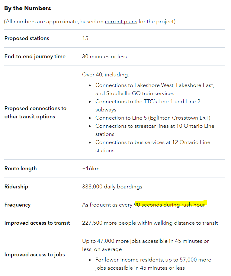

the term you are looking for is "induced demand"I mean, according to the Ontario Line website by Metrolinx, they are expecting to use 90 minute headways during peak time. Source: Metrolinx: Ontario Line
I think the above numbers are for 2041 based on the Ontario Line Preliminary Design Business Case Summary document. Meaning they are already at expecting to be at capacity on the Ontario Line by 2041, unless you know of a method to decrease headways even more from 90 seconds. Additionally, the stations are built 100 m long to fit 80 m long trains at 600 capacity. Even if we increased it to 100 m long trains with 750 capacity, you're only increasing capacity from 24,000 to 30,000 pphpd. An increase of a paltry 25%.
This is just an incorrect statement all around.
The Yonge line was built in 1954 and was completely capable of meeting demand on the line for 40-50 years before we're having to implement ATC and 90 second headways. And total capacity on the Yonge line with full ATC and 90 second headways would be along the lines of 48,000 to 58,000 pphpd, far far higher than the theoretical upper limit of the Ontario Line. Even with 3 minute headways, the capacity on the Yonge line is between 24,000 to 29,000, which is the same as the currently proposed Ontario Line. So, no, the Ontario Line will not have "a lot more capacity than the Yonge Line had pre ATC".
For reference, crush load on the Toronto Rocket is 1,458 per six-car train. So I'm using a range between 1,200 and 1,458 for my estimates above.

As you have said, the Ontario Line at 750 capacity * 40TPH gives 30k PPHPD.This is just an incorrect statement all around.
