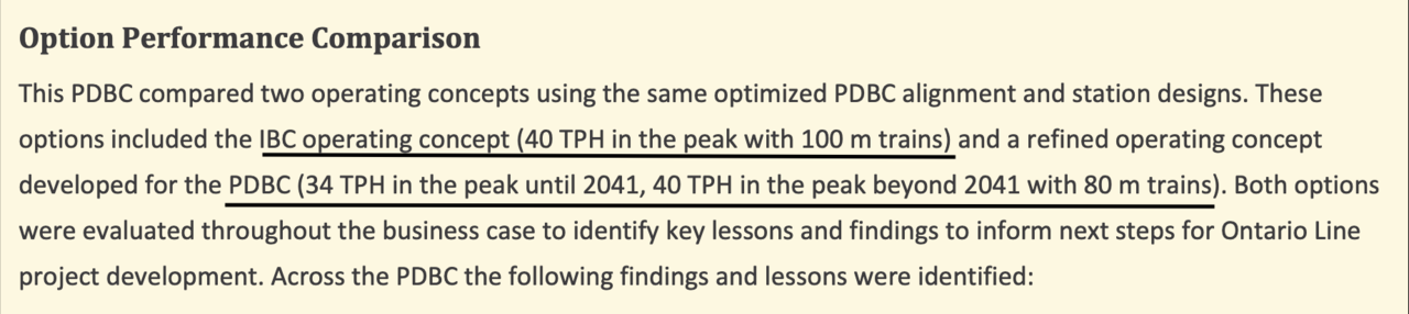

I see. I interpreted your statement as talking about initial and long-run capacity, not design capacity. From what I can tell, there's actually no plan to use 100m trains.
screen-shot-2021-12-04-at-18-57-46-png.367062
I'm still using the maximum design capacity since upgrading the system to 100m long trains would cost almost nothing
Not true. They're actually procuring fewer trainsets based on the shorter trains and lower tph. My understanding from reading the PDBC is that the first point at which they'll reevaluate and procure additional sets is 2041, and (obviously) the cost reduction is in the 100s of millions. That's partially how the total cost was reduced.
