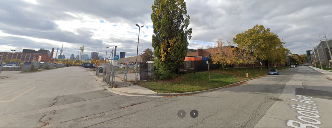

I'm slightly amused by the thought of them building a new above-grade alignment right through the middle of Parks, Forestry and Recreation's main yard and offices for South District.
The alignment would all retention of the on-site heritage buildings that front Eastern, but certainly require re-location of the Yard.
Not a lot of spaces to move a facility of that size.
Its a 10 acre facility, not including the heritage buildings.
I suppose you could city a 2-level parkade for the operations equipment, but the City hasn't done that before that I can recall.
You would also need a connection of the offices though.
