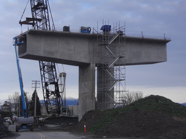

Cheapest is probably prismatic beams with constant spans of maybe 35m. Probably concrete I-griders would be cheapest as well (look at ECLRT @ Black Creek or UPE @ YYZ.
  • If the valley is deep enough, possibly increasing spans to 45m might be worthwhile, but since there are several kilometers of elevated at normal height, it is likely cheaper to use 35m spans and build a few extra tall piers at Don Valley, rather than having to worry about changing the depth of the superstructure in the one portion.
Look at Canada line - when possible they use constant depth superstructure.
If you are crossing a major river of 150m+ navigation channel and of considerable water depth, then you need an alternate form, and above about 130 to 150m main span, the extradosed starts to take over from the haunched pre-stressed box girders.
Canada Line's Middle Arm Bridge was built using segmental girders in a "balanced cantilever" method from each pier.
With the width and depth of the valley here (and DVP below), raising beams from the valley floor may be a problem,
and with multiple piers, I don't think a balanced cantilever method would be possible.
So they may have close spacing of piers and just do segmental girders with a launching truss.
They may also use a "push" or "launch" method if it's a steel structure, where spans are added to one end and the entire structure is pushed from one side onto the piers. That was done for the famous Millau Viaduct and in Canada, in Port Coquitlam, BC for the Coast Meridian Overpass spanning an active railyard (six spans of 102.5 m (336 ft), 125 m (410 ft), 110 m (360 ft), 125 m (410 ft), 71.4 m (234 ft), and 46.5 m (152 ft)).
If that's the case, then you might see cable stayed towers along the viaduct. That would also make some sense, as the bridge could be pushed from the north side towards the tunnel portal in the cliff.
Push launch was also recently used for an REM bridge in Montreal:
