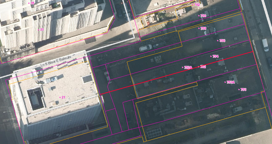

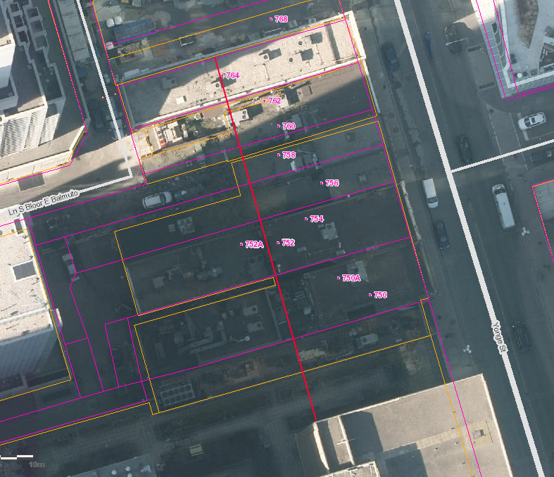

That idea (building south of The One) is not an easy prospect.
At the lower levels, total distance between the podium of 'The One' and the U of T owned building at Charles is only ~58M
Even if 'The One' is sufficiently set back at higher levels, you still 'have to' have a 25M separation from the building to the south.
That leaves you a maximum of 33M of frontage; but I don't see an allowance being made for 0M separation to 'The One's podium level'.
That's a bit tight.
Then you have 55M of depth to the condo wall at the rear:
From which you again need to deduct 25M separation distance.
That's 30M
All in, there's a viable floor plate there; though setbacks from Yonge, at least will eat into that as well.
But it's workable, but very little spare room, would seem to require owning pretty much everything in that contiguous frontage.
Could be worth the $$$ and hassle.

The UofT building is set back quite significantly from its north lot line, by quick math gives you about a 32x38m area to build a tower on the site provided you don't have to meet the 75 degree angular plane from Yonge Street like further south. Can't be bothered to check if it applies here or not.
It's actually an excellent development site if the whole row of buildings can actually be assembled.
I measured from the U of T tower building, not the lot line.

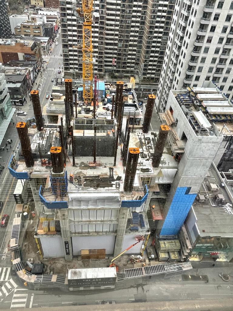

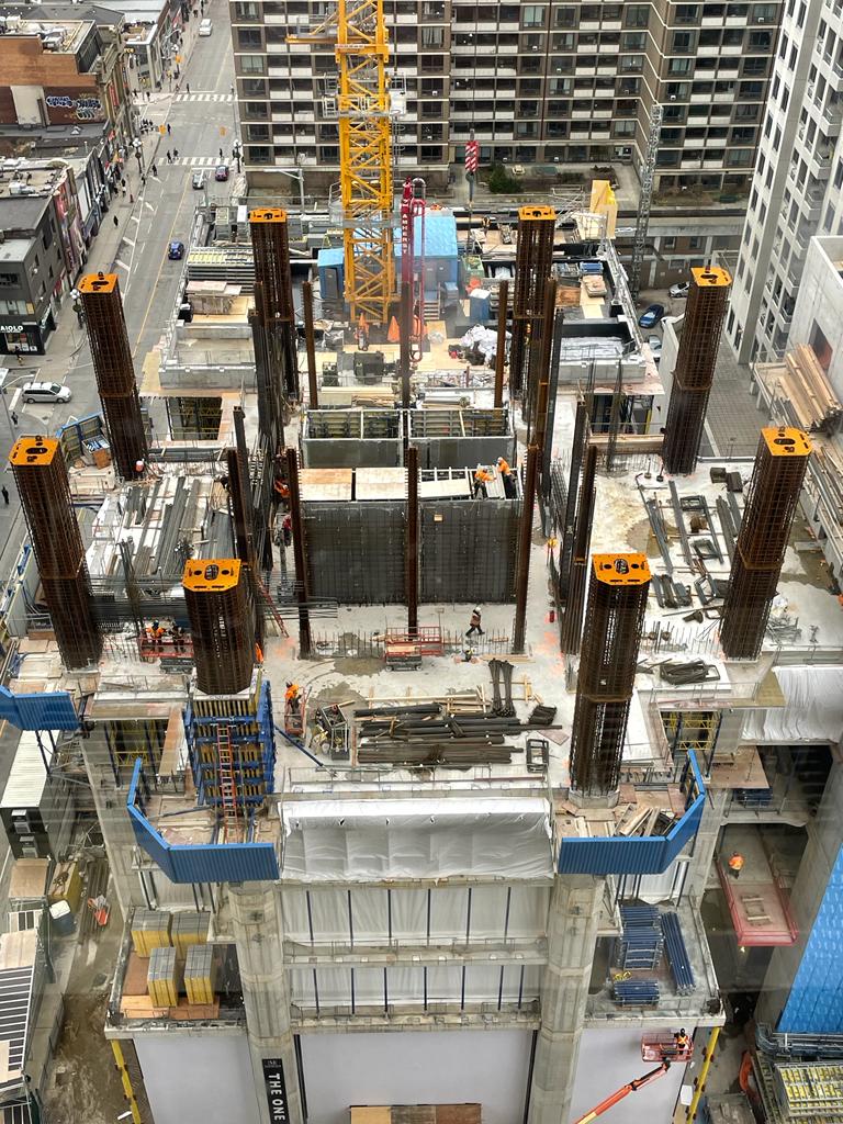

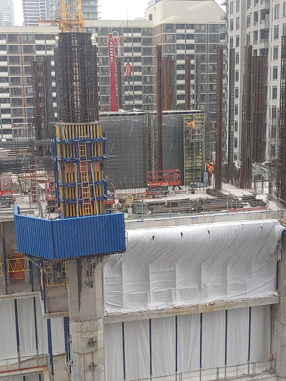

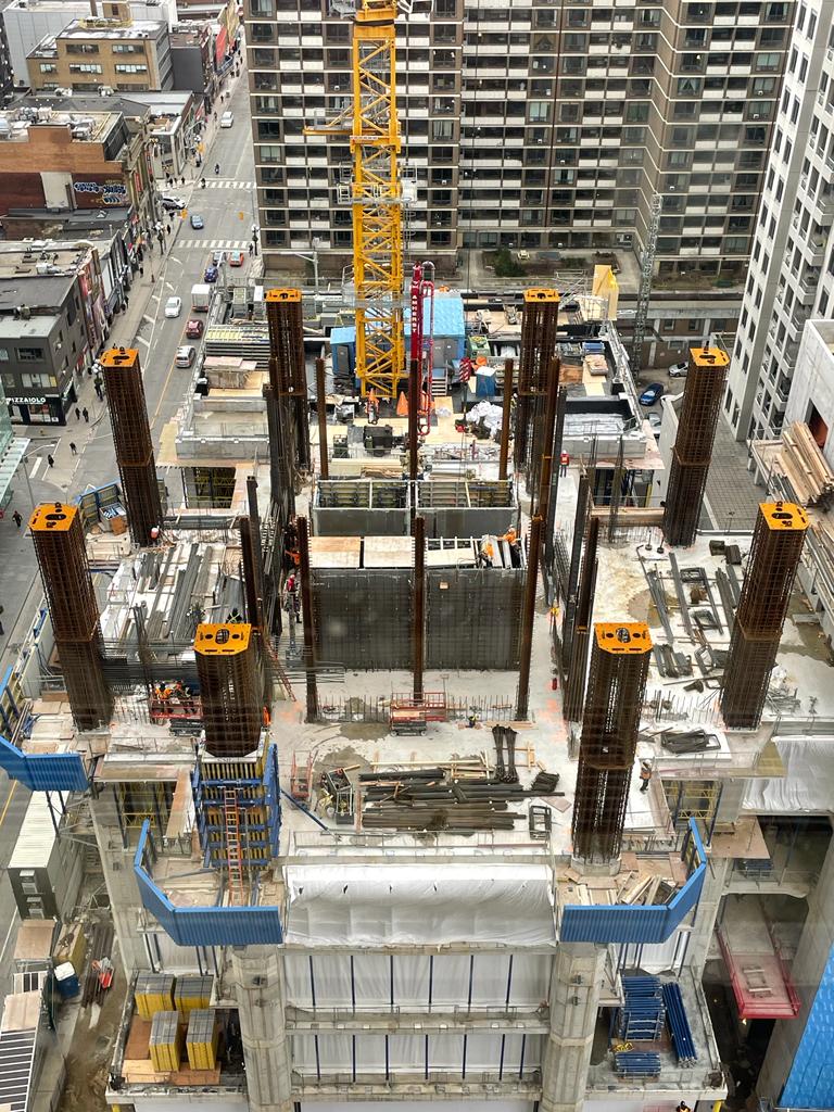

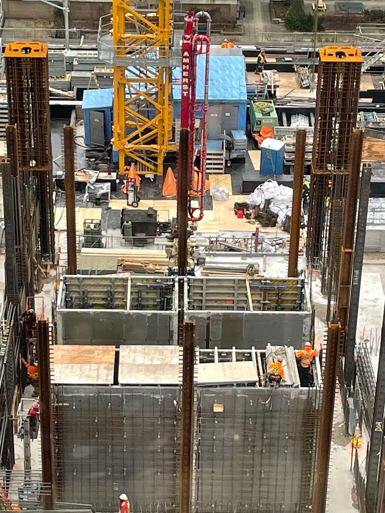

The elevator core seems remarkably thin, I’m surprised they didn’t make it a bit thicker to better support the weight. And save a bit on the costs of the supercolumns.
Then the elevator core would have cost more and have been more costly to transfer its loads to the supercolumns below where it ends.
