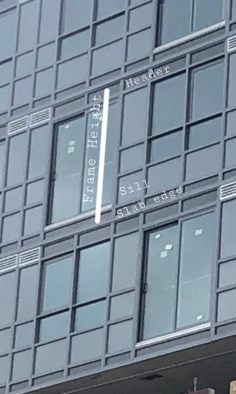

The technical difference between curtainwall and window wall is that curtainwall hangs off the slab, and window wall rests on the slab. There's a lot more to it than that, but that's the basic idea. Jangho was selling their window wall as a "hybrid" because it was resting on the slab (like a window wall), but the anchors projected the frame forward so that the frame was sort of hanging in front of the slab. So functionally it was a window wall, but aesthetically it looks kind of like a curtainwall (if you don't look at it too carefully).
It does impact the appearance of the spandrel somewhat (the actual architectural "spandrel", not the colloquial "spandrel" that gets used on this forum). Architecturally, the spandrel is the horizontal structural member spanning the columns (usually the slab edge), and the "spandrel glass" or "spandrel panel" is the material that covers that edge. Because of the way windowwall needs to span the space between floors you usually end up with a small spandrel at the top and bottom of the frame, covering the header and sill, plus a third spandrel covering the slab edge. Curtainwall doesn't have to fit in between two slabs, so it can use a single spandrel panel (or piece of glass) to cover the header of the lower floor, the slab edge, and the sill of the upper floor. It lets you have cleaner lines and a less-busy look.

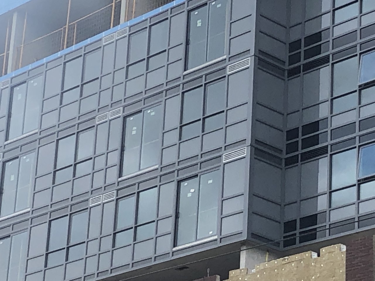

Edit: This seems to be interesting to people, so just a quick addendum to illustrate the point. Here's Design Haus:
I think everyone hates this, but not everyone can explain why. This is a window wall problem. Remember that window wall frames are like Lego pieces that snap together to make a wall. Each piece has to sit on the floor and stop at the ceiling. That prompts this kind of configuration:
The header panel must be discontinuous with the panel at the slab edge because they're two different frames. The panel covering the sill could be continuous with the panel covering the slab, but that's not popular because the frame itself doesn't lend itself to treating that space as a single cavity (the meaty part of the frame ends at the slab, and that's just a little scabbed on panel hanging down to cover the edge of concrete). And then because window wall is sold at a way cheaper price point than curtain wall it tends to get pressure pads and snap caps instead of structural glazing, which means each of those little pieces is being held in on all sides with trim. And this is why it often looks like a dog's breakfast. With a curtainwall frame the whole wall is sitting past the slab edge, so it's simple to just replace all of that with a single piece of material.

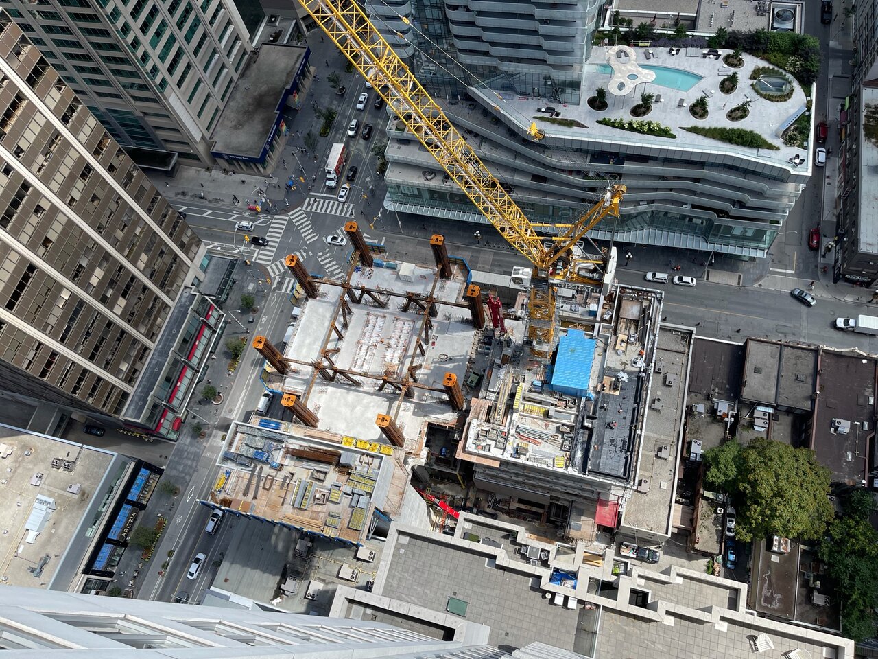

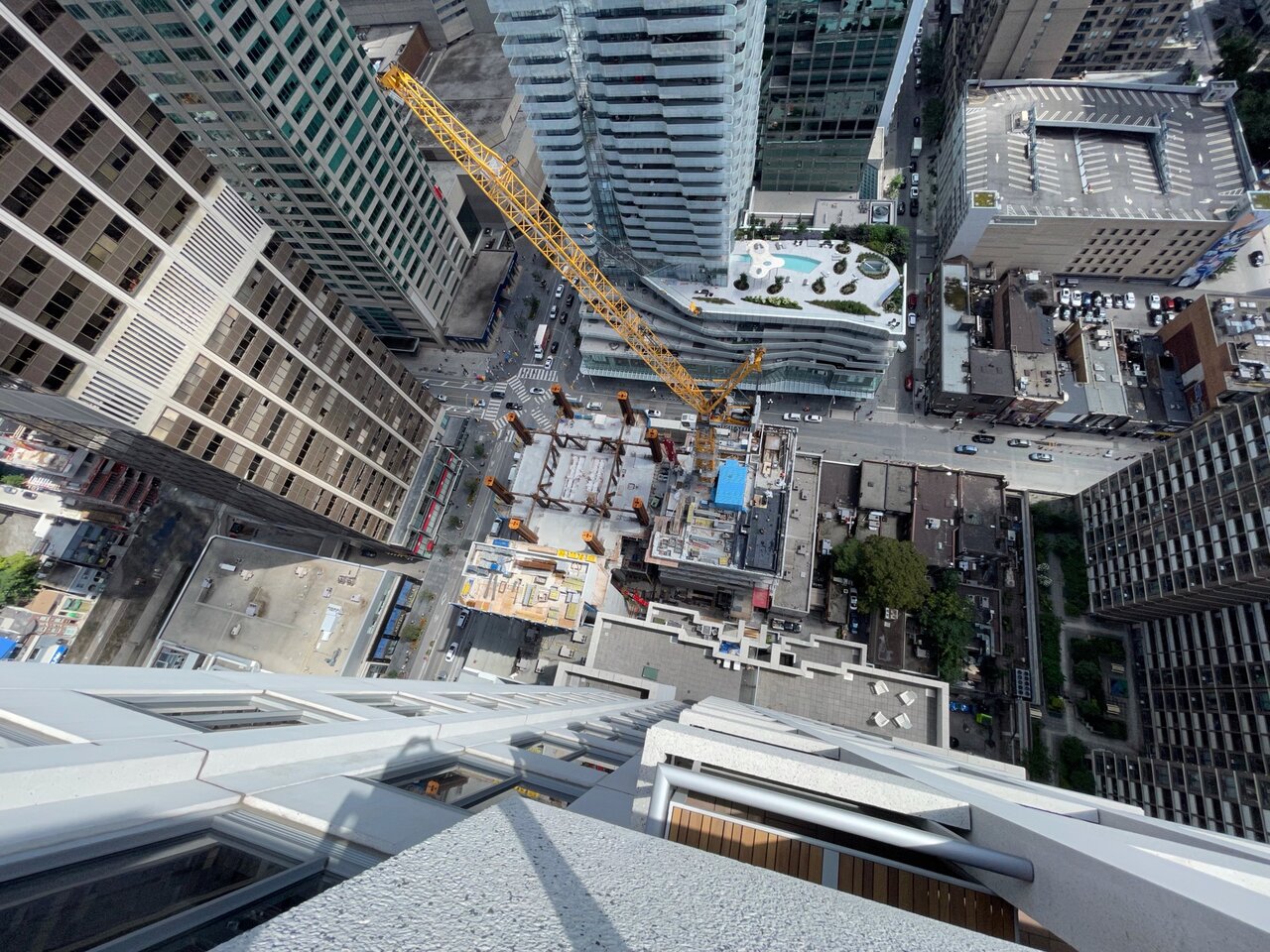

Now to echo the sentiment of other members, holy sh!t they actually did it. I didnt think it was possible but they've done it. We have a transfer slab.

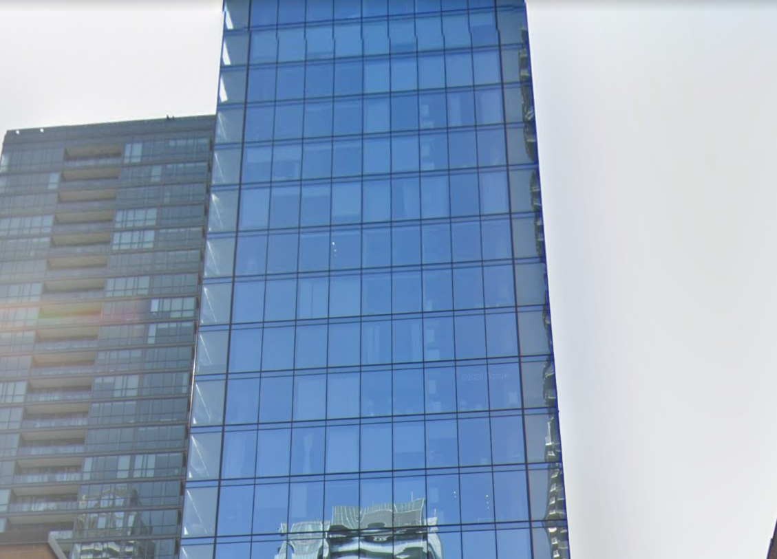

I could be wrong, but that looks like true curtainwall and not the hybrid thing they used elsewhere. It's subtle, but it's got a couple giveaways as curtainwall: a) it's using standard cast-in anchors (the hybrid system had a piece of sill track cantilevered off of a pair of anchors), b) the frame is extending up above the slab edge (the hybrid had a pair of anchors on the underside of slab to trap the top of the frame), and c) the bottom of frame appears to be resting in a sill attached to the frame below (the hybrid wall had no true continuity between floors). You can see it a bit more in this other photo by @scamander24
The hybrid wall (which I'm certain was part of the debacle at Ice) is a little harder to pick out because of that band of frosted glass that wraps the tower, but you can see it here by @caltrane74
You can see there how the sill track is hanging off the slab, and the frames therefore don't have to fit within the floor-to-ceiling opening, allowing for a single panel to cover the transition between floors
King Charlotte is a weird one, yes, especially with everything you note and because of the notches visible in the slab. I even thought twice about posting that picture, TBH. The only reason I'd still say that it is (I'm even hesitant to use that language) is that the architect at aA is a friend who worked on the project and when we were exploring curtain wall options for a later building, it was recommended that we go look at that one as precedent. I can ask him again if he's sure.

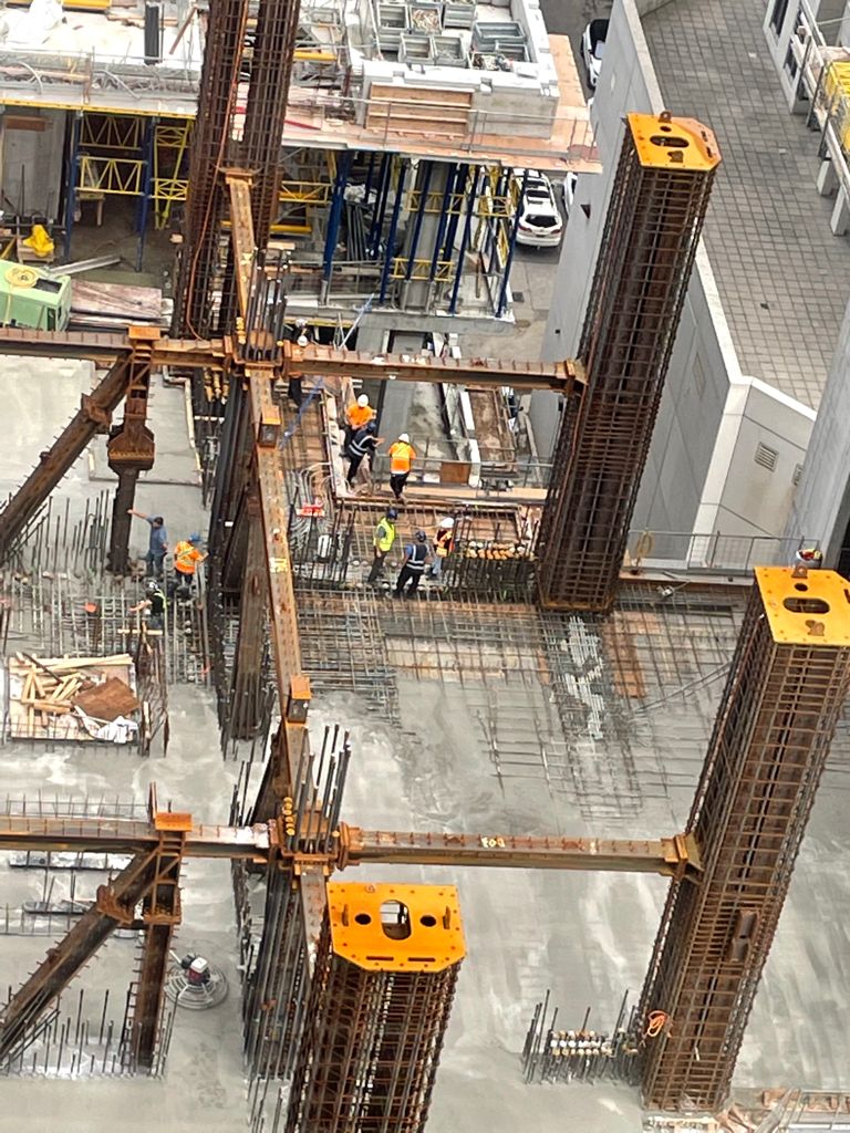

And just like that, the supermassive ultra mega pour is done! 🥳🥳🥳🥳
And now we can stop waiting for the pour and go back to waiting for the next forms to be put up! I'm sensing a trend of too much waiting in this thread! Hahahaha
This floor is the hotel lobby and there is one more double-height lobby floor above this - Residential lobby. After which we will get to more consistent floor plans, meaning we should get into a better rhythm and speed of vertical growth.
