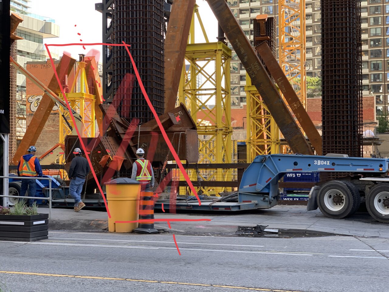

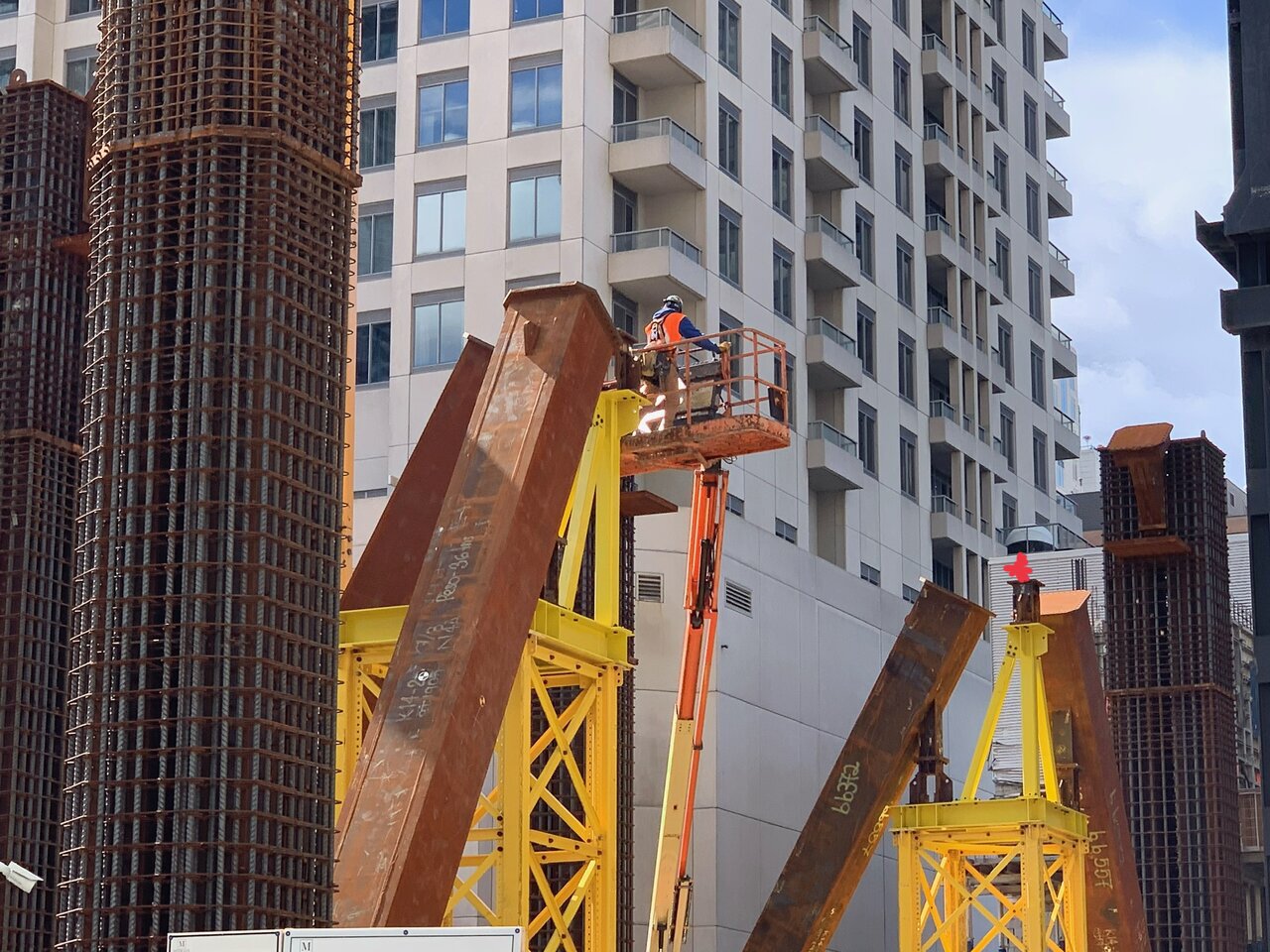

Update, new interesting looking piece of the puzzle arrived a few minutes ago while I was out for a walk at lunch.
If you flip the piece 90 degrees clockwise, you can see that it would fit nicely at the top of diagonal pillars+yellow support tripod pictured on the left.

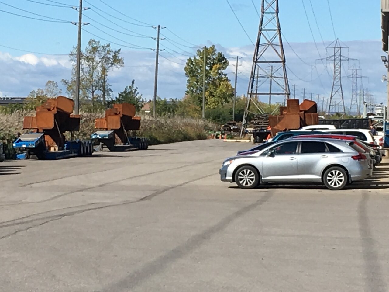

Does anyone know where?It never dawned on me that while above grade construction was suspended due to permit issues the super columns were being assembled off site all along. What a pleasant surprise. This is awesome.

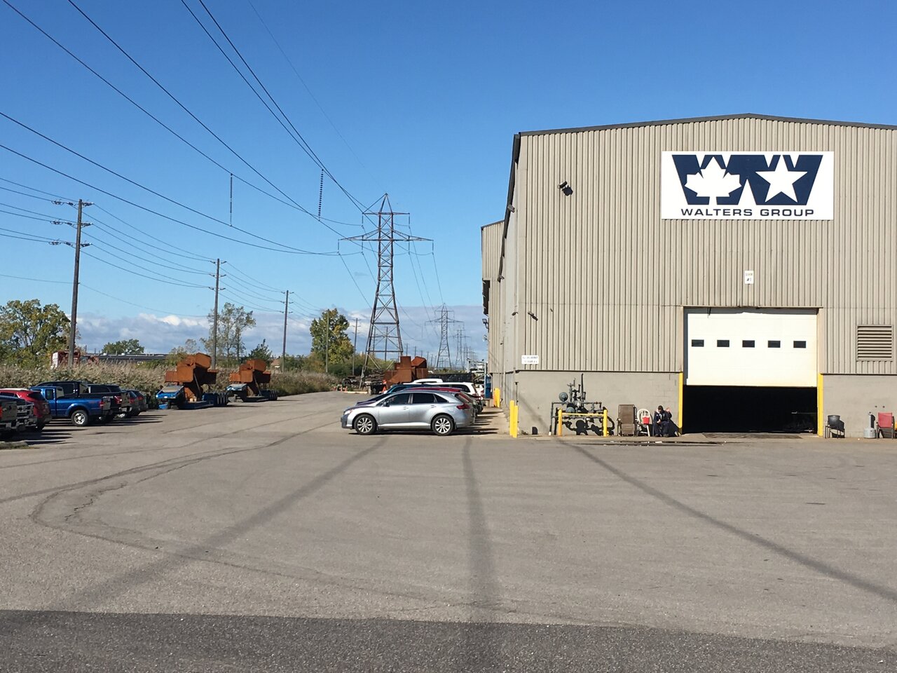

The structural steel supplier is Walters Group. They have a few plants but my guess is that these are being fabricated at their Stoney Creek facilityDoes anyone know where?
www.waltersgroupinc.com
what are the odds. I’m based in Winona. I could take a swing by there tomorrow to see if any future pieces are on site.The structural steel supplier is Walters Group. They have a few plants but my guess is that these are being fabricated at their Stoney Creek facility
The One Tower - Walters Group Inc.
Canada's tallest building, the One, is an 85-storey tower. There are eight mega-columns with diagonal bracing on the façades.www.waltersgroupinc.com

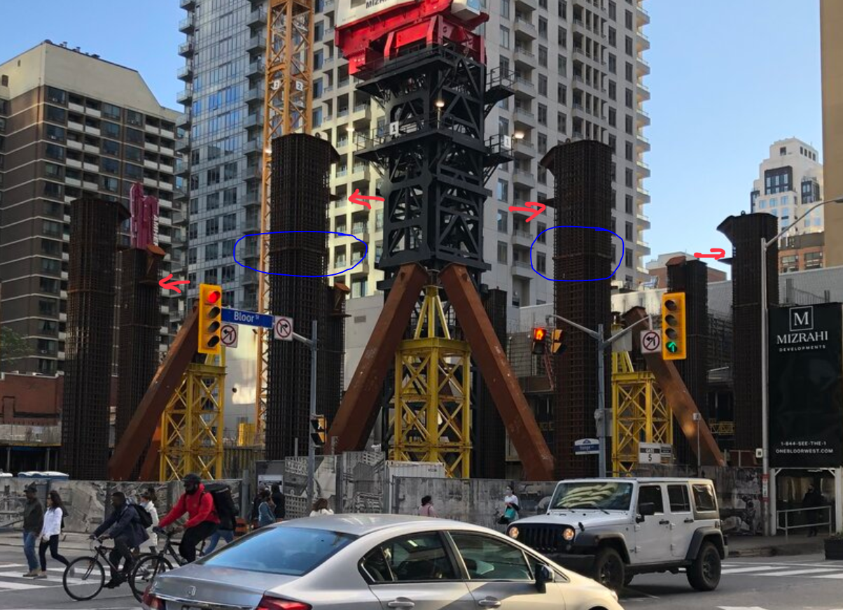

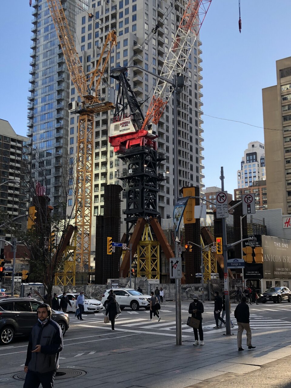

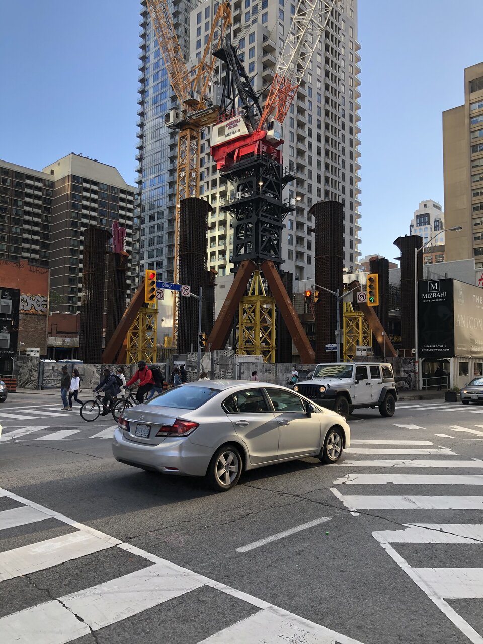

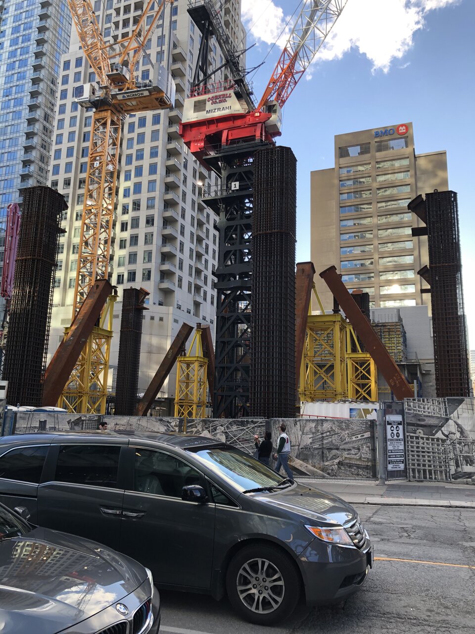

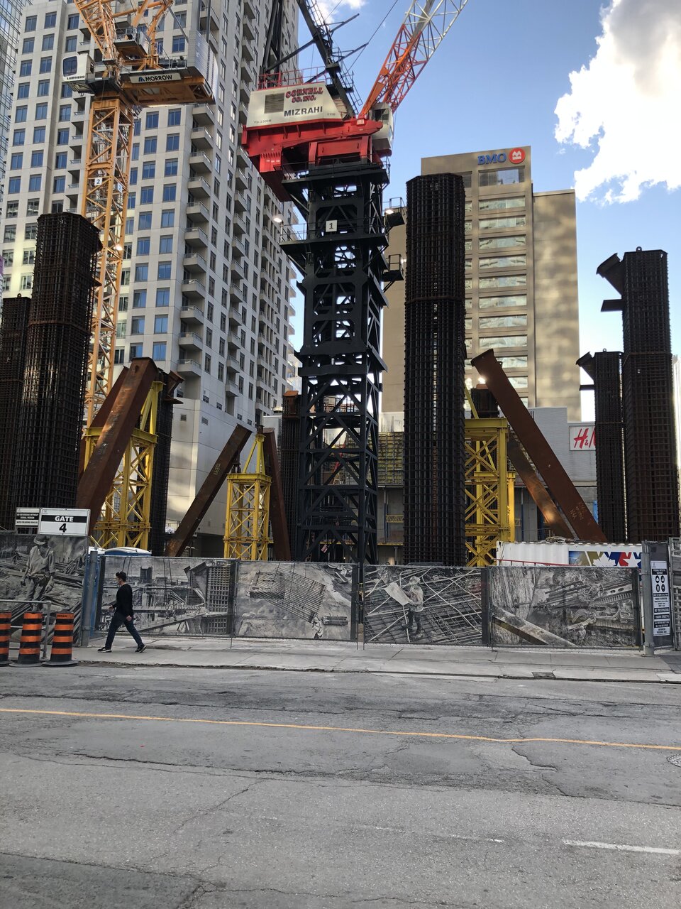

So one thing I find interesting is that there are no horizontal attachment points for the first hanger exoskeleton. I wonder how they transfer loads from the hanger to the super-column.
I think it helps to note this asterisk of iron goodness, are in fact are likely two objects that will join up with those diagonal support columns per corner in the eventual. They are together like that as picted likely for ease of transport...being awkward shapes and all. If they ain't that, I'll eat a pigtail!Yup, see below for illustration - flip the node over - the asterisks connects, the plane in the first pic (formed by the extended plates with the boltholes) represents the upper floor - note: not saying this node will go to this specific connection.
(pics by @Benito)
