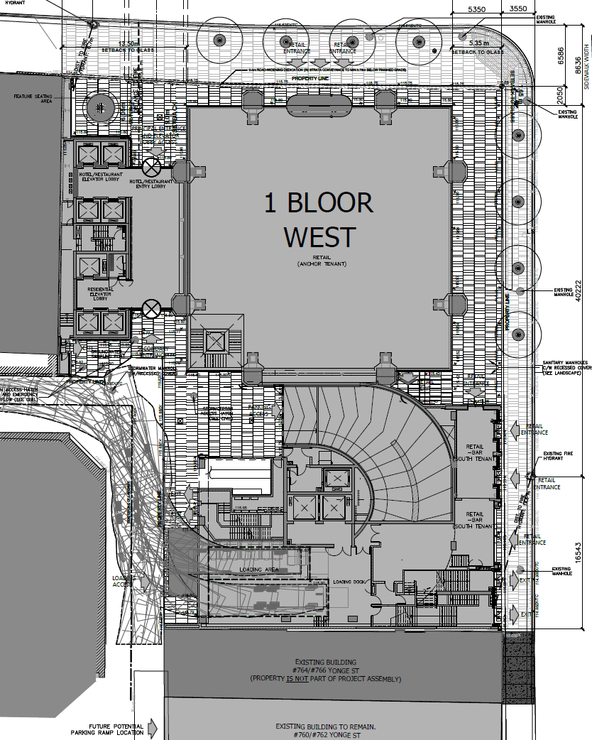

Here is the site plan from the Nov. 18, 2019 submission plans.
Where is the required loading? I see one G and one B.
Also this lane is going to be a clusterfuck.
