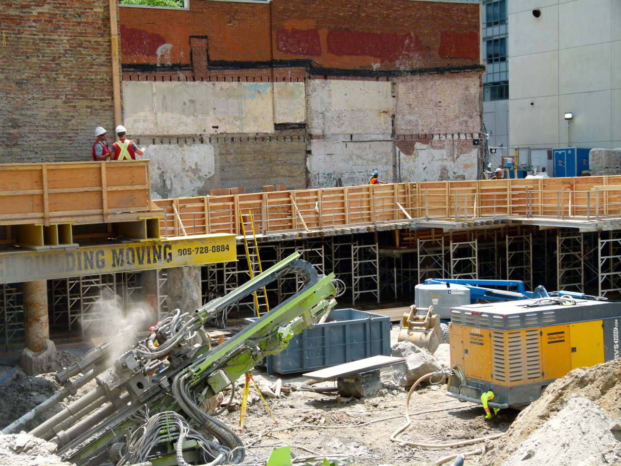

Hey everybody, so I know there has been a bit of a debate about is this or is this not top down construction. I figured I would go straight to the source and ask. I figured I would be waiting weeks for a response or never get one but within a few hours I got the answer. It turns out both sides of the debate are right and wrong. Anyway here is the email answer I got.
Hi Andrew,
We have elements being built at grade along with simultaneous works being completed at the full excavation elevation. As a result, its a form of hybrid top down construction, as we are working on multiple elevations of construction simultaneously. Its ground level form work for construction staging and site logistics on top of an active excavation pit. But, its not a true 100% top down construction. I trust this answers your question.
Sincerely,
Sam Mizrahi President
125 Hazelton Avenue
Toronto, Ontario M5R 2E4

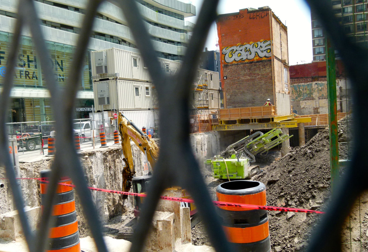

The information in our front page story came straight from Mizrahi Developments, from Sam's Vice President of Development, Josh Lax. (If we put something on the front page, we have researched it.) What you are seeing is not top-down construction. It is standard excavation, but with a platform being built for staging purposes as it's a tight site. We've seen this on many Toronto construction sites in the last couple of years as the City becomes more reluctant to give space on streets over to construction work. Sam calling it a hybrid is a little over-the-top.Hey everybody, so I know there has been a bit of a debate about is this or is this not top down construction. I figured I would go straight to the source and ask. I figured I would be waiting weeks for a response or never get one but within a few hours I got the answer. It turns out both sides of the debate are right and wrong. Anyway here is the email answer I got.
