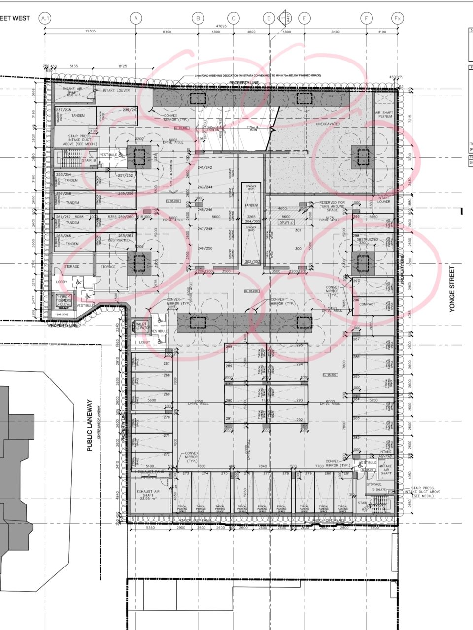

This is drawn from the Architectural Plans from the Dev App site - not the most up to date but the P4 shows you the location of the megacolumns and what kind of foundation for them we are looking at (circled in red)
The caissons will probably align with the footprint indicated. I wonder if they will build the basement floors from top to bottom.

It's interesting that they won't excavate a significant portion of the site (North-East corner)
nope, just not needed to meet the parking requirements. Most developments have some form of partial level of parking, no point excavating dirt you don't need to.
