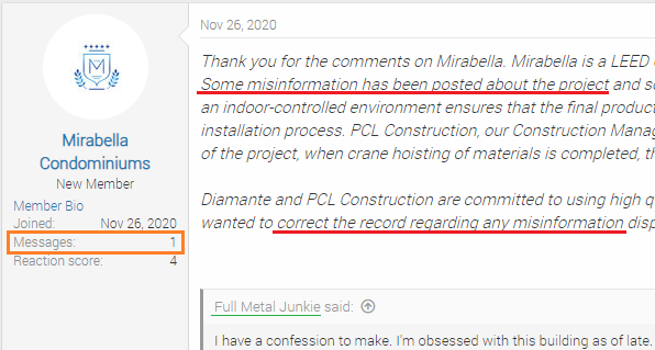

So when I documented some imperfections with The Regal Cladding in my post, Mirabella Dev Corp took issue with that. They accused me of:
Some misinformation has been posted about the project
...and again...
misinformation displayed on the Urban Toronto thread that inaccurately portrays the construction process at the Mirabella Condominiums
They didn't like how my photos "inaccurately portrayed" the royal treatment our waterfront was receiving from Mirabella Dev Corp. And here is why:
Precast is a high-quality exterior material.
the final product is high quality in both finish and dimension
it is not uncommon for small chips to occur during the installation process.

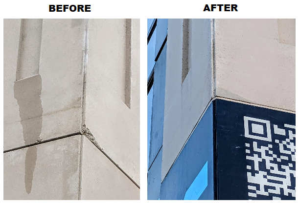

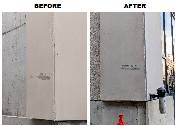

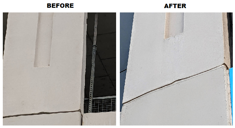

So let's take a closer look at the "hand finish" these "high quality in both finish and dimension" precast concrete panels received.
1702570797387-png.527198
And a couple more for which, sadly, I do not have the 'befores'
Not sure how much thought and effort (if any) went into matching the colour of the "hand finish" plaster to the colour of the precast panels, but hey, we were only promised "high quality in both finish and dimension", not the colour. So I will give Mirabella a pass on that.
What I will not give them a pass on is the fact that all of the above 'after' pictures are from the panels facing the prominent sides of the building and close to the ground level. An innocent bystander would only have to look up beyond the first couple of floors. There they would discover that the state of the cladding is as Regal as the day if was first applied. Pictures taken December 14, 2023:
I don't know about you, but to me all of these small chips sure look like the
small chips
that Mirabella Dev Corp promised to fix
